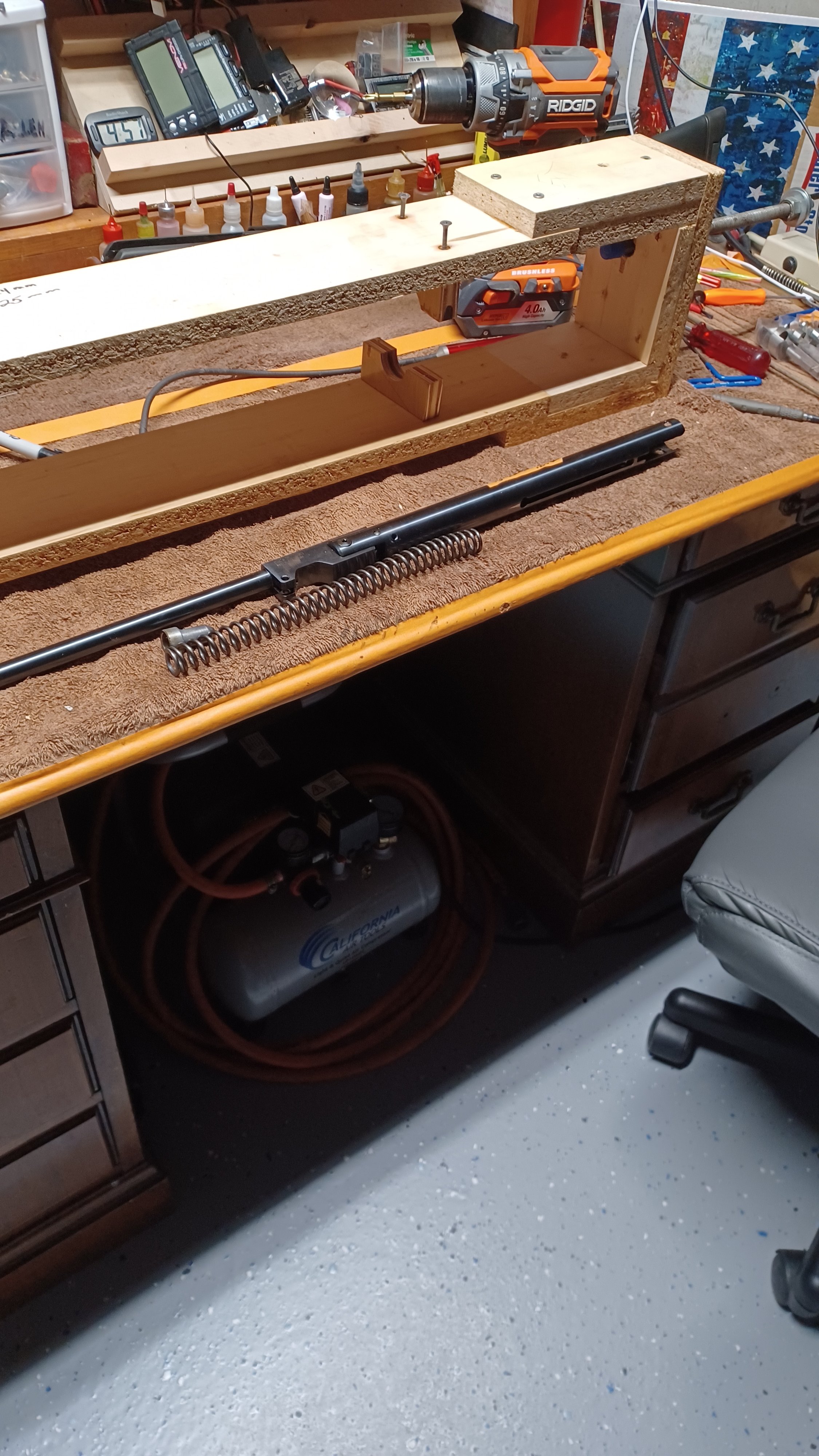

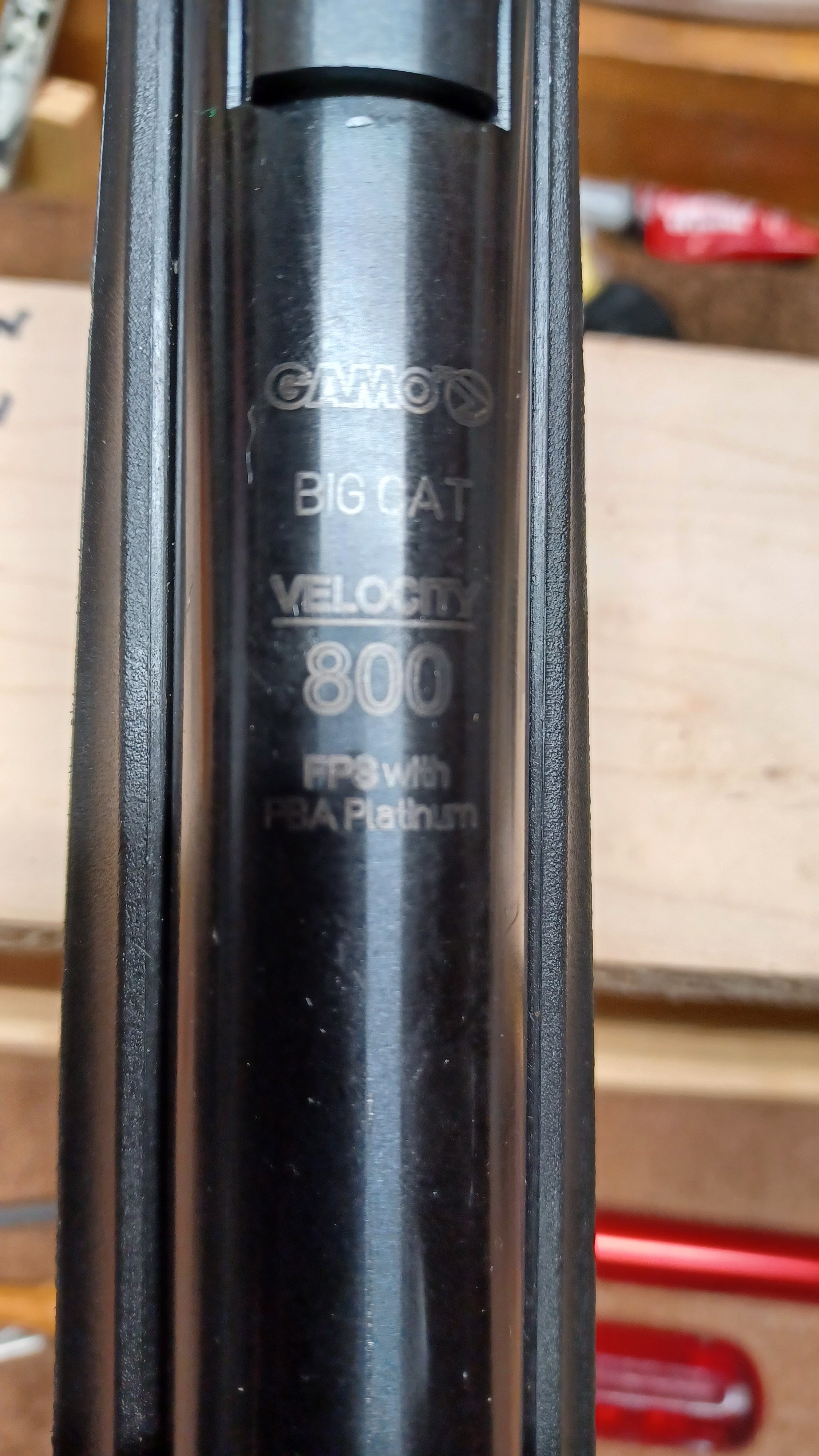

Gamo Piston seal question

Kinda what I was wondering .. of your gun is claimed 800 fps and you really just get 600 of the latest are rated 1000 will that same pellet used go to 800fps kinda thing ?
They got 2 rated at 1000 ( alloy ) . Ones spring power and one is gas ram power .. ....

Anything in .25 should be shooting at least 100 fps faster than the numbers you're getting. I've got cheap Hatsan .25's in both spring and gas ram that shoot 575 to almost 600 fps with the JSB's.
You're already in it, might as well replace the spring that as already mentioned is bent and will rob some power and seal.
If you have calipers, measure your piston seal, ARH sells a few depending on what size you may need:
For the spring, at least from Gamo, you need someone with an FFL to have it delivered to so local gun store willing to help out?
You can also check out TW Chambers in the UK. They list the Big Cat and parts for it:
