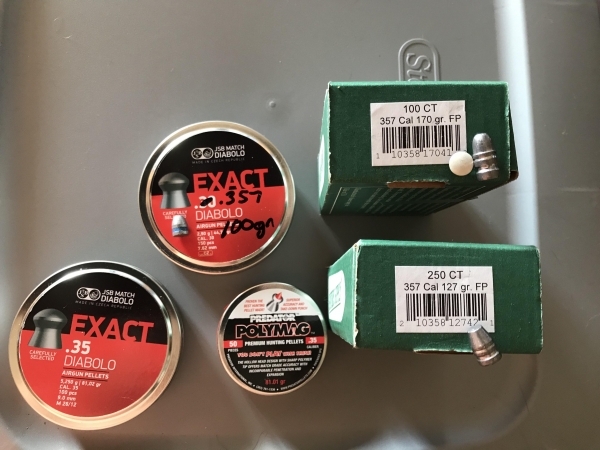

All stock except for DePinger and Moderator, 5 shot groups tetherd at 2900psi.
