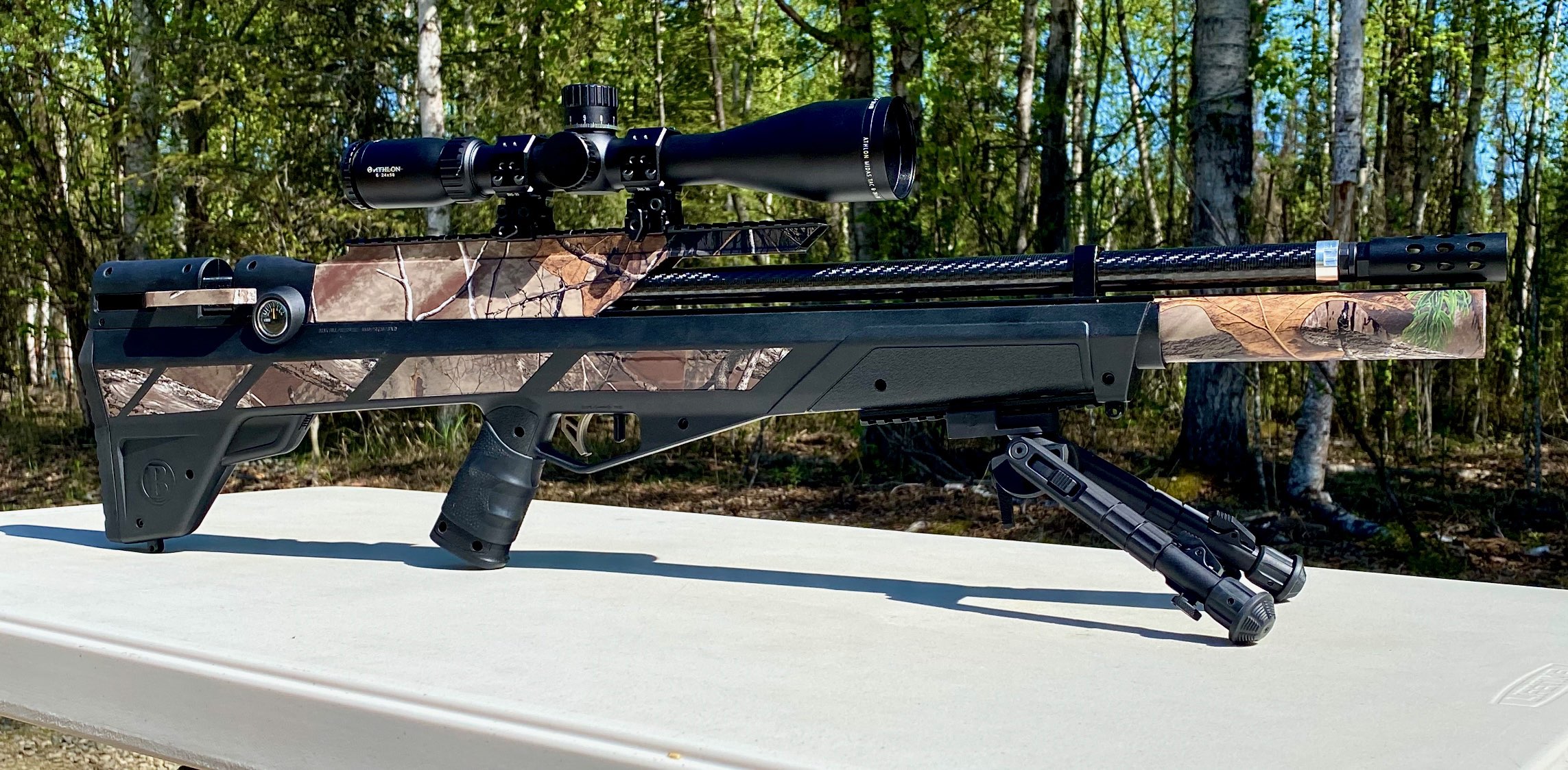

Does anyone know of a rail mount that claims to the air tube on a Pitbull? I have the shroud length tube which requires removing the stock lower rail and I want to put a bipod back on my rifle. I don't really want to spend for a too clamping bipod. I see bottle clamps everywhere, but not seeing anything for the smaller diameter tube that Pitbull (or Benjamin for that matter) use.
Alternative will be to figure out how to glue a rail on the stock, but still be able to split the stock when needed.
Just want a bipod. I have an idea to use the stud, but it requires machining and still not sure it will work. Eventually I bet I make a new part to replace the stud, or stumble onto a tube mount. Maybe I can use a hose clamp around the airtube, I'll have to check that out in a bit. Ghetto, yes. But might do what I want.

Ad a low profile mlock rail to the stock with t nuts just behind the front post mount. We do this on the Taurus so folks can use a lower mount bipod.
Are you cutting m lock slots in the stock and using m lock nuts to secure it, or regular old fashion blind (or t) nuts to secure it?
I have some cheap m lock rails in my shopping cart that I'll probably buy for this.
This may be an expensive mistake, but I just bought a Saber Tactical 34mm clamp for this. I also grabbed a 60mm for my Kral Empire X which has no real place to attach other than to the bottle.
And no my airgun will not rotate. Directions for the Huma regulated inside call to leave the tube loose so air can vent the regulator. I didn't like that so I filed a small notch in the end of the exterior tube. So far that has worked fine to vent the regulator and the tube is screwed down tight against the receiver.
