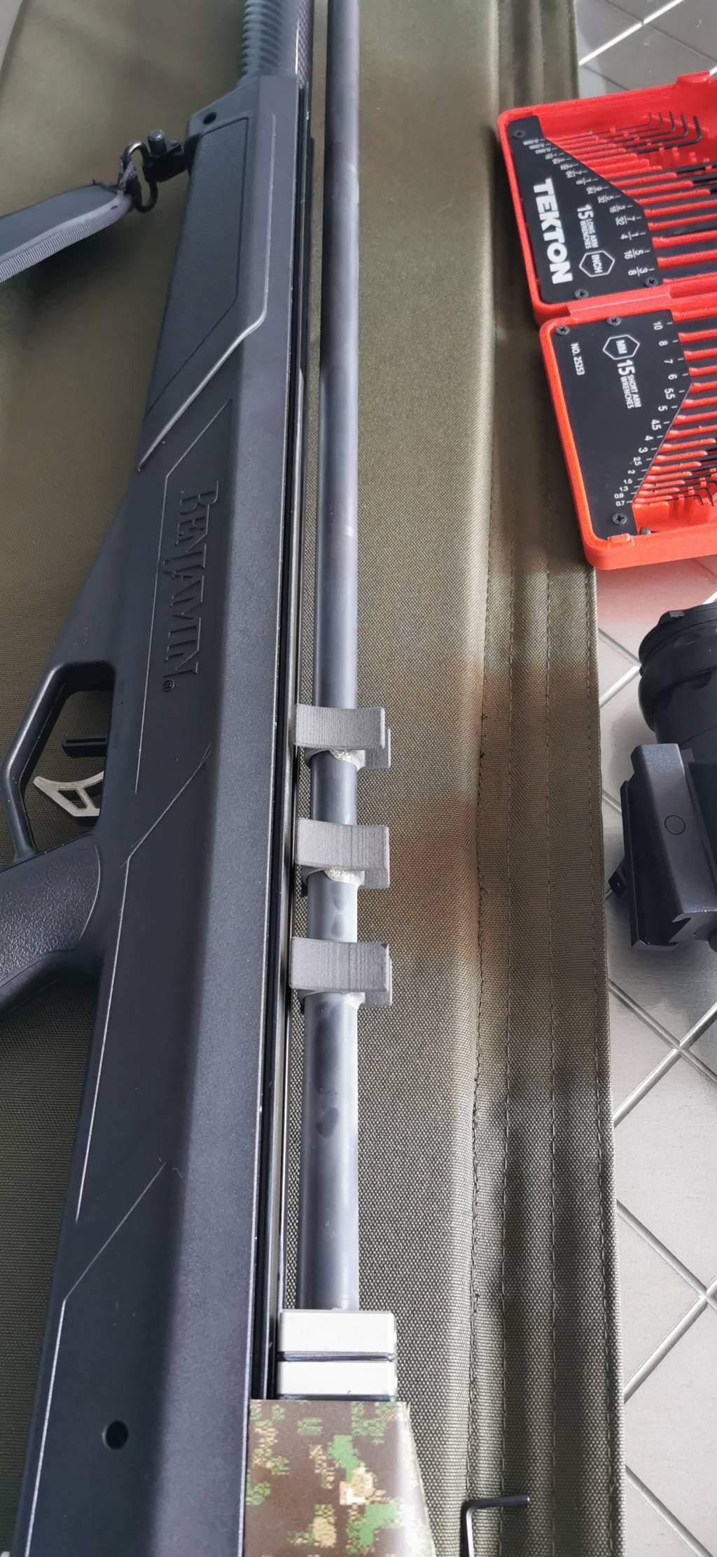

I had the same accuracy issues with my pitbull custom build, and this is what i found:
First, I noticed some pellets clipping
then removed the shroud to check the supports and found that the three supports were not spaced as it should
After barrel supports relocation my accuracy was improved but definitely my bulldog doesn't likes 142gr .357 only likes 160gr .358 slugs, now i am waiting some .358 for testing

You may want to pull the shroud off and check the supports, I put a wrap of cloth tape around my barrel at each point to keep them in place. Mine are evenly spaced.
Funny, Greg_E and Capt_MJ brought up the barrel support spacing. That is something I was wondering too.
I think I will take a few shots and evaluate accuracy after cleaning before trying to remove the shroud. The way the threaded adapter is mounted on the front end of the gun, I think I need to depressurize it first, because the airbow looks like it might be blocking a screw that holds the adapter on.
Capt_MJ, how tight of a fit are those adapters? Could they slide around in shipping, for example?
Mine did not say to glue them and they never really migrated. I only taped them to help with sliding the shroud back on.
BD2021, you should be able to remove the one screw at the back of the shroud and slide the entire thing off, the barrel just friction fits into the moderator, assuming you have a Pitbull moderator. If not then a screw on still does not attach directly to the barrel (I think), it attaches to the end of the shroud.
