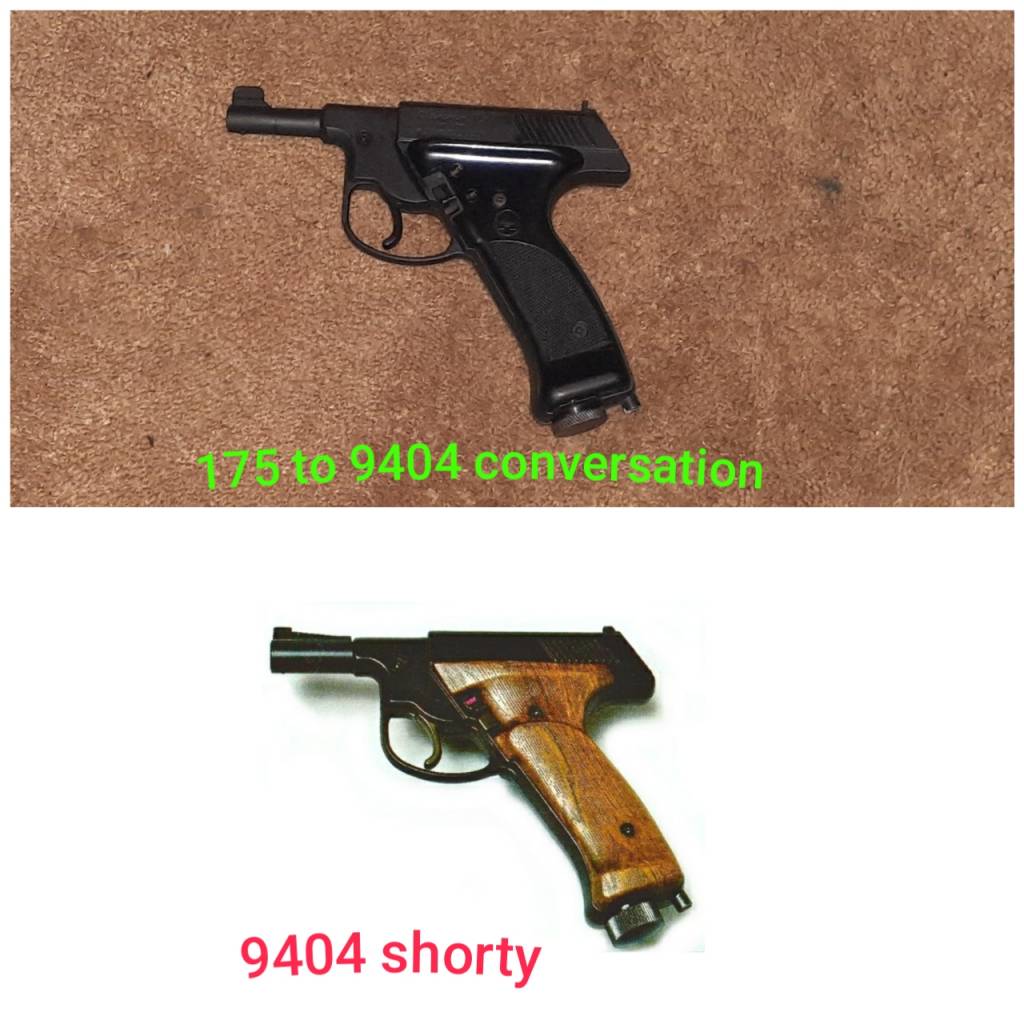

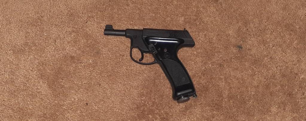

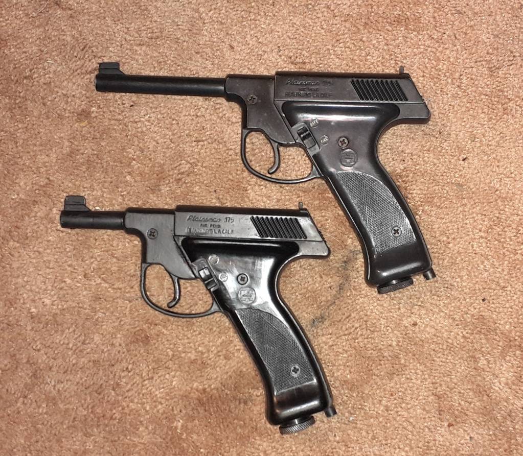

So I'm all done with my plainsman 175 to Shorty 9404 conversion. all back together and tested. It works great. Didn't get to chronograph it or test for accuracy, will in the next few days.
The Shorty is .22 and used special steel coated lead ball
ammo, left my conversation bb much simpler to find bb's
I am still looking for a Plainsman Shorty 9404 but this will work until I find one.

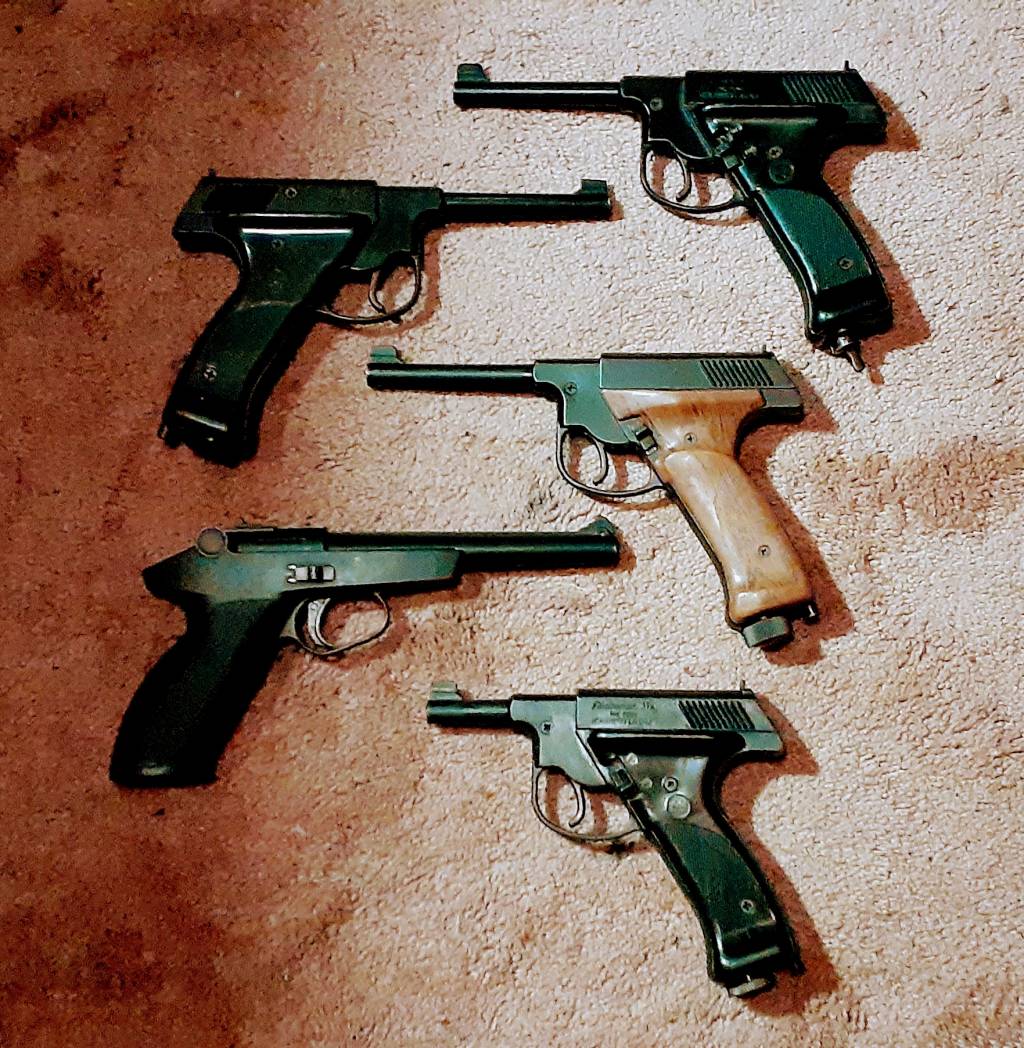

The 9404 Shorty was a gun similar to the Plainsman 175. It was .22 and shot steel coated lead balls. They are hard to find. So I took a 175 and shortened the barrel. All Heathaways co2 pistols used the same internal parts. The later models had brown grips. Here is a great read about the Heathaways air guns
