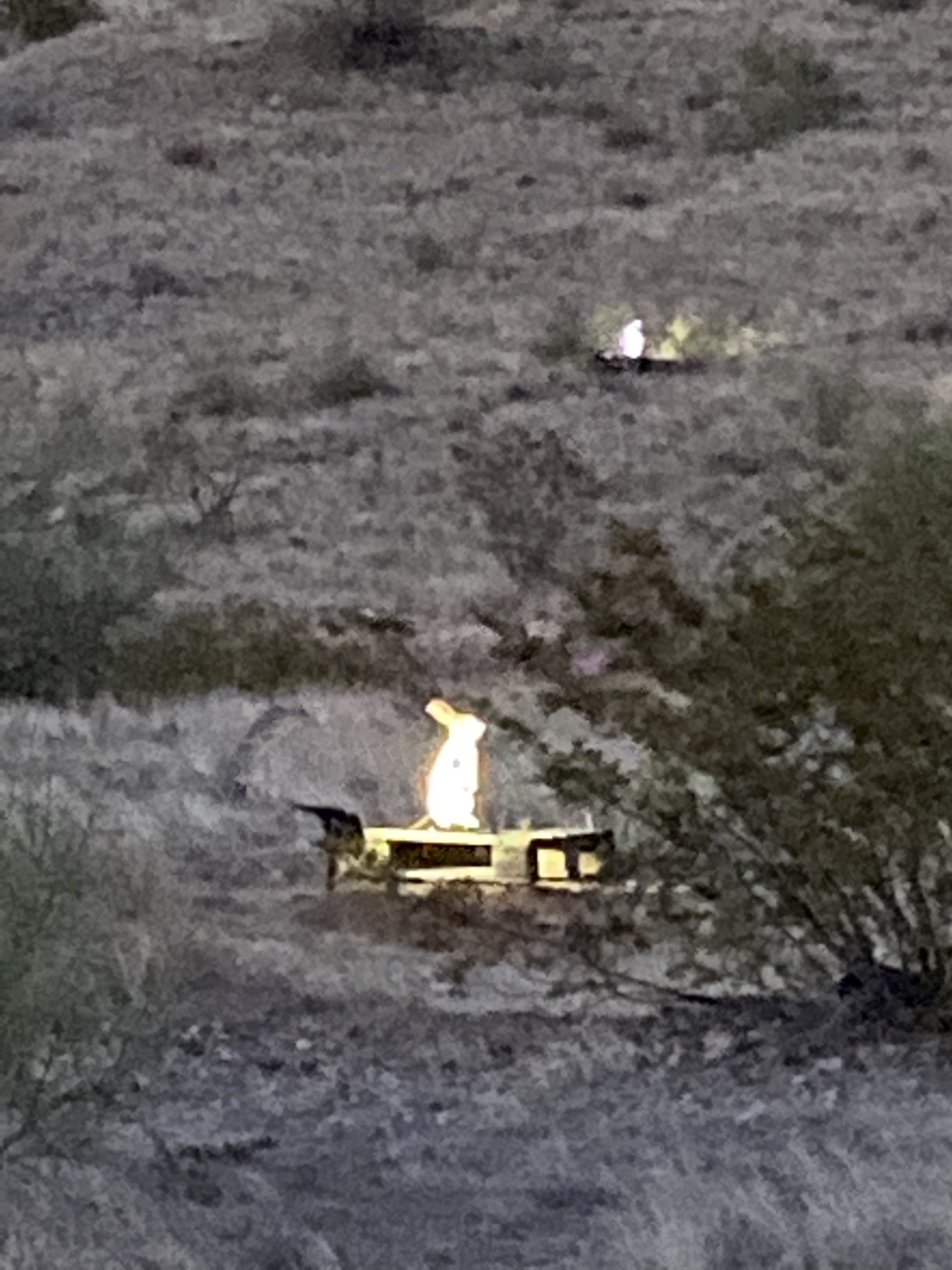

I've done the match reports and analytics of all of the XFT @ PRGC matches here in Phoenix. I think that's somewhere up around 25 matches now.
This is probably the chart you've seen, blue and yellow table in the link...
Nothing fancy there, it's just the same kill zone divided by distance that the sub 20fpe field target Troyer uses, at least for 25-50 yards. I extrapolated it out to 100 yards though, and also applied an additional difficulty factor for targets from 51-75 yards, and a slightly higher difficulty factor for targets from 76-100 yards.
The closest we set them in Phoenix is 25 yards, furthest is 100 yards. (Although, @ EBR, the extreme field target portion had a 106 yard target, I suspect that caused some anxiety for folks whose dope sheet stopped at 100). Closer than 25 yards and at the 80fpe you are considering, your targets will get the stuffing beat out of them.
We've found that an average Troyer of 30-34 seems about right, the closer you are to 30 the higher the winner's knockdown percentage will be. And "by about right" I'm meaning newbies will knock enough down to have fun, while seasoned XFT shooters will still find it a challenge.
If you do an average T of 35 or more, it will be hard on the psyche of some of your shooters, specifically those that get frustrated easily. Because of the greater distance involved, a T of 35 in extreme ft is a much harder course than a T of 35 in regular sub 20fpe/<55 yards field target. Especially because (as was mentioned yesterday in discussion here on AGN), there are other contributing factors, wind for example, that can make it MUCH tougher than that 35 suggests.
Our highest Troyer targets are usually 3 inchers @ 100 yards, an Extreme Troyer of 41.7. We typically have 4 of those shots, and it is VERY rare for anybody (even the winner of the match) to score 4/4 on those targets. We've occasionally had even higher Ts, and had them knocked down only a couple times during the match, with 10-15 shooters each taking a whack a them twice.
I suggest not going harder than a T of 45 on any target that's past 65 or 70 yards.
