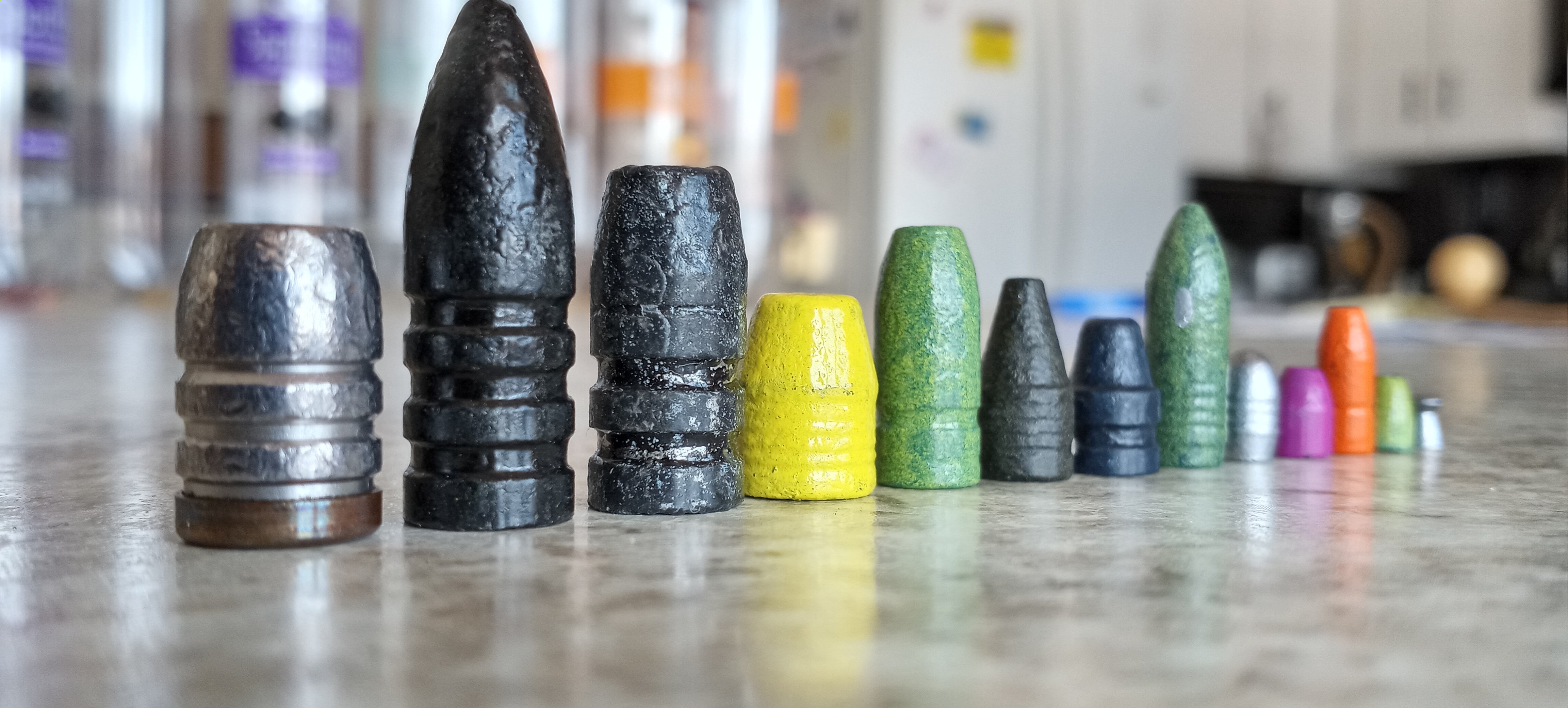

Yes Mike you are kinda correct. The industry was not looking into it but it was a side affect of us boolit caster. It is powder coat. It contains the lead and while doing so does provide a slicker less resistant surface than copper or traditional lubes allowing higher speeds to be achieved. Once again faster is not always better if you care about the object you are attempting to hit. Given the fact that air guns do not have throating issues a barrel already lasts forever and does not have to be subject to powder burners issues. I guess you could get a few extra feet per second out of a PC boolit with less air. I would feel this would work better in the big bore stuff coming out of the lesser power guns like the AEA stuff.

Long time powder coated myself, easy to clean the barrel, no increase in accuracy.

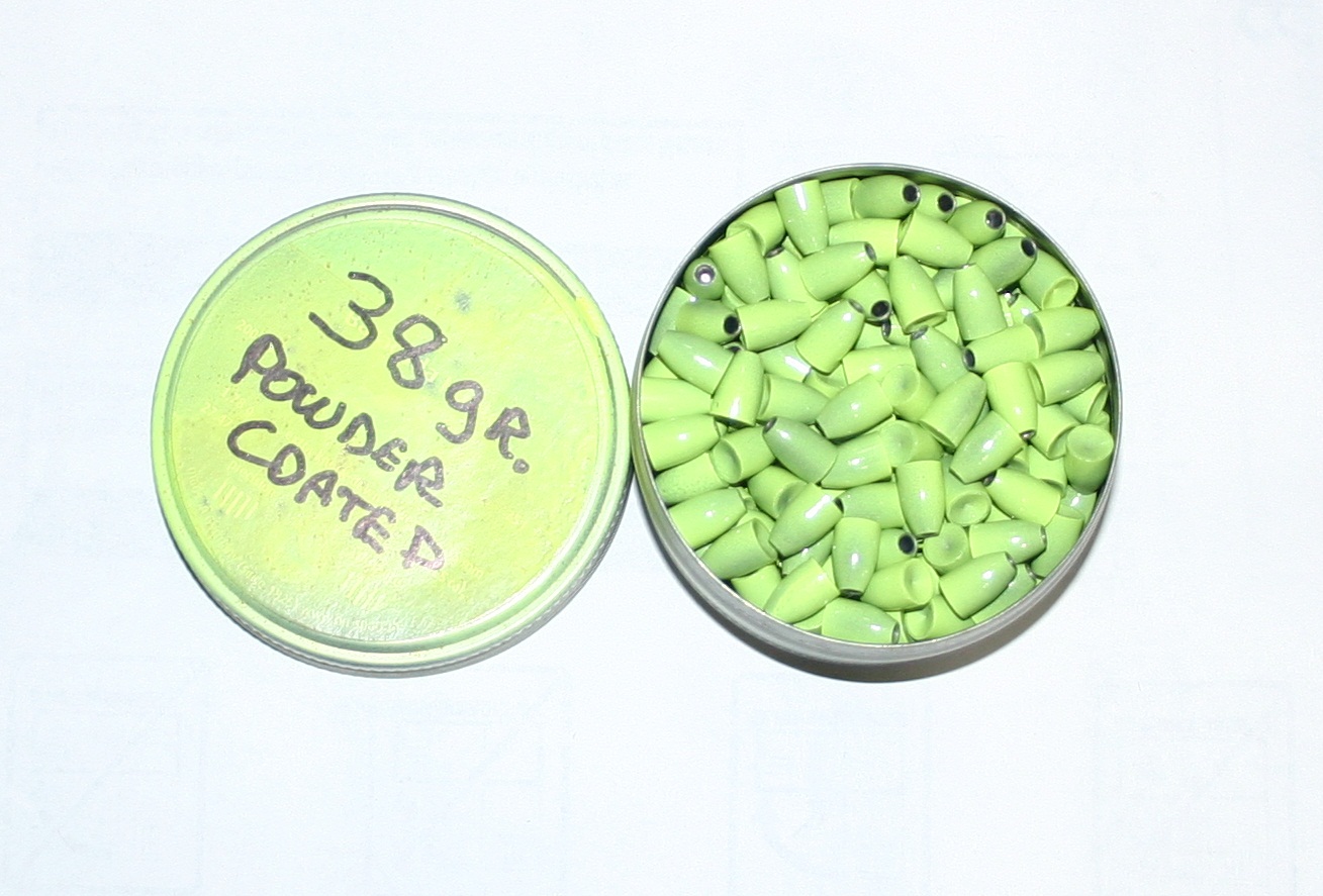

A Teflon infused powder coat works on slugs. Never tried it on pellets.
Just add solvent and spray your slugs one coat and cure them in a small toaster oven.
Makes them .001" larger in diameter. An even coat produces a very accurate round.
Doesn't completely stop barrel fowling or increase velocity in my barrels.
But, with the bright color they can be seen in the air as they reach POI at long range. And expansion isn't affected.
