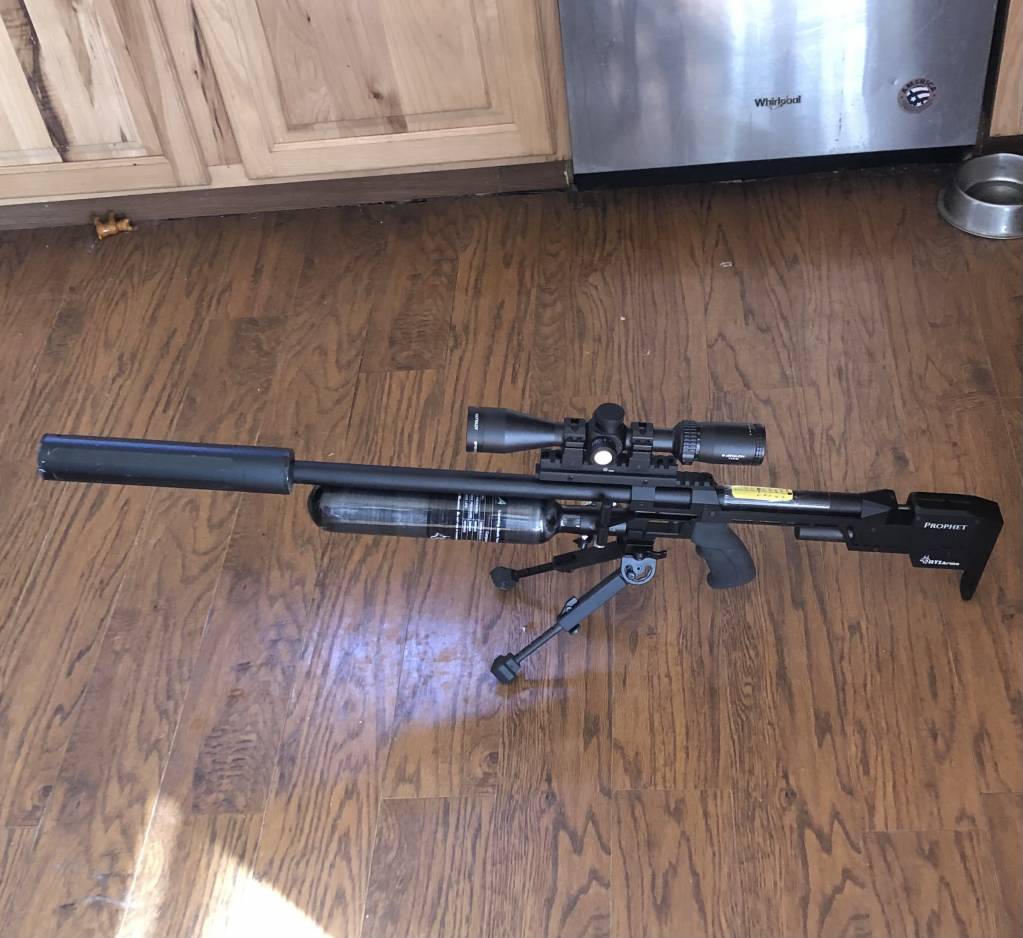

Playing with my RTI prophet proformance .25
So I decided to change the tune on my prophet to see if I could get some crow mags to group well enough to dart some vermin in my goat feeder approx 20yds. So after chasing my zero and never getting a good group in my 13 yd basement range. I thought wth I’ll shoot some somthing else near me I had some of the 26.8 on the slung a few and holy cow they grouped really well. 💡came on I’m gonna try them at low power. Reg 85 and hammer spring approx 2.5 threads exposed nets me 11.9 fpe. The quest for super stealth has now been achieved. At 35 yds my group is averaging 16mm center to center. I wish I could do better but I can’t I drink way too much coffee my pulse moves me to much.
Anyway I know a lot of people like the high power but I thought I’d share my experience with the lower power. So far I’ve been able to reliably hit a had boiled egg out to 60yd my back yard max. Shot count is insane. According to my DB readings I’m getting 77db 3 in from muzzle.
