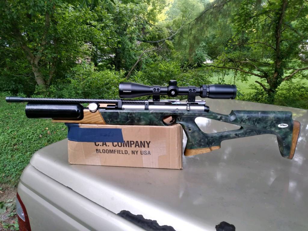

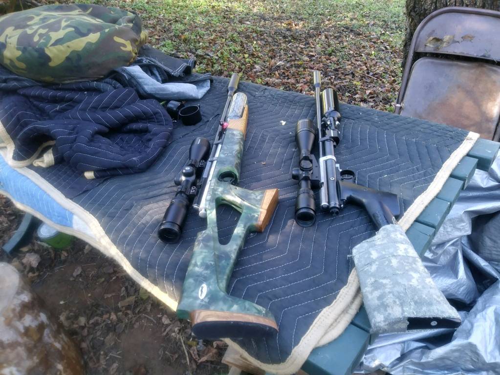

I've done a few of these conversions, one based on a 2250, the other a 1720T.
Started out with a 3000 psi aluminum bottle -
And now have a 4500 cf bottle on the 1720T & the 2250 as well - BEAUCOUP shot count my friend!
//www.w3.org/2000/svg%22%20viewBox=%220%200%20210%20140%22%3E%3C/svg%3E

Frigging outstanding builds! And now we know who ate all the Squirrels in TN.

Thanks for the kind words breaux John -
The 1720 is shooting SO sweet, lots of shots at the sight in range and enough air left for TWO matches lol, and at 16X on the Bushy 3200, only one mil holdover at 10 & 55, took one shot over the chrony yesterday after a session down my hill, 885 w/AA 10.3 - good number, DON'T OBSESS I tell myself.
Hopefully, I have FINALLY learned when to stop tweaking, and when to start SHOOTING!
