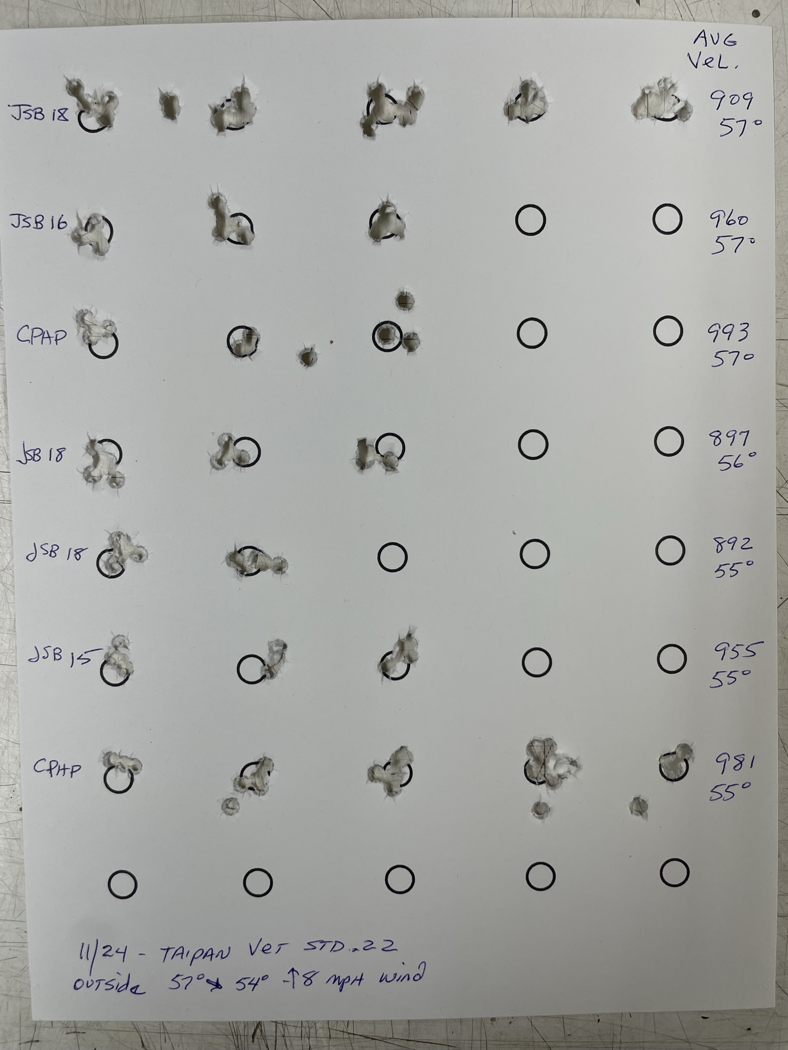

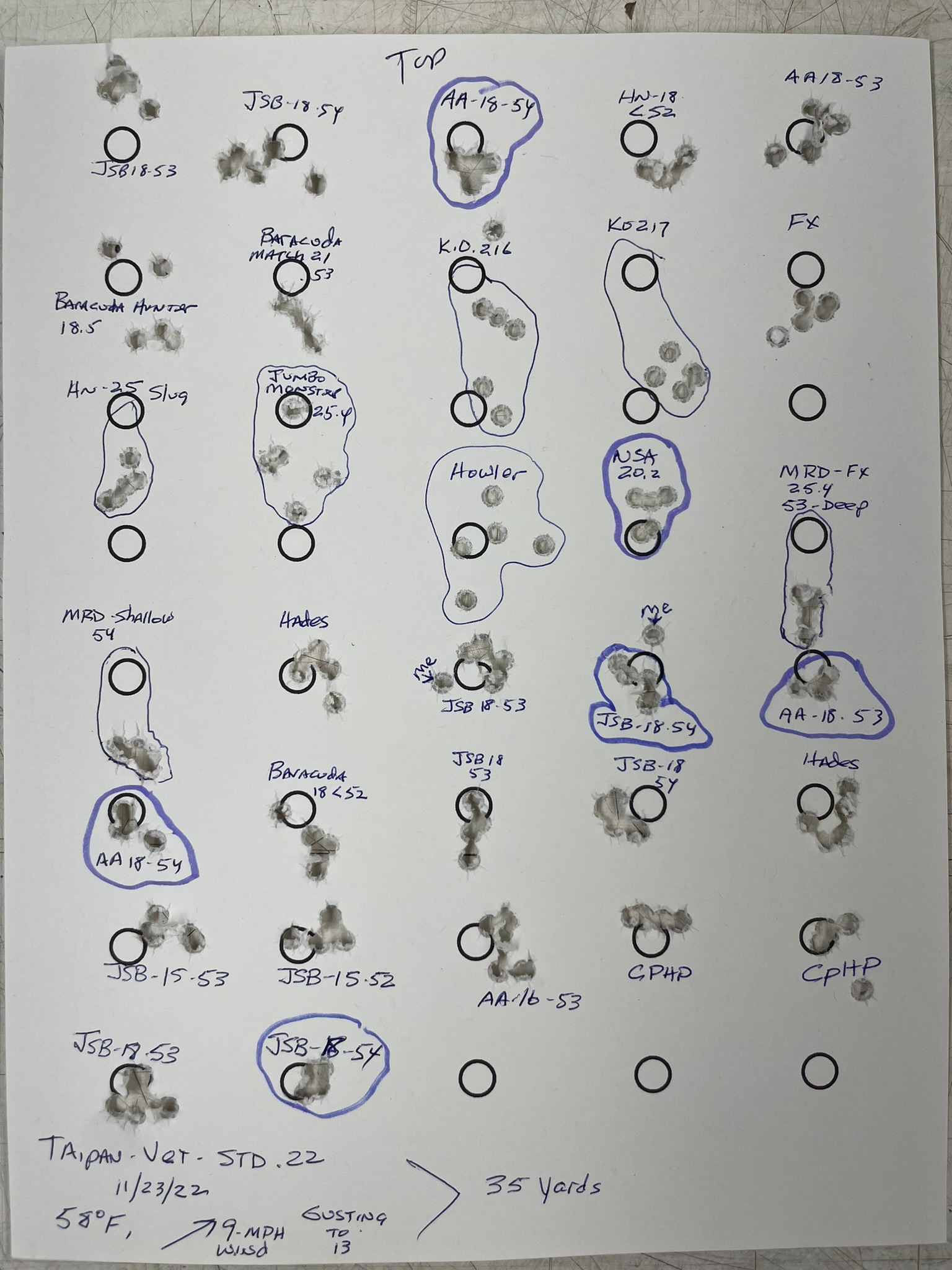

While I was waiting for the weather to warm up I ran some JSB 18‘s over my Chrono inside my (warm 72*F) shop. I turned the HS in gradually and it peaked at 963 so I backed it out 5% to 915 and locked it down. Shot a complete shot string and got 60 good shots before it fell off the reg around 120-125 bar.
Aired up and took it outside and shot 5 shot groups at 35Y with every pellet and slug I had. Didn’t use the Chrono any more until I got to the last two rows because I wanted to see how hot the 14-16’s were running. 14 CPHPs were 979, 16’s were 945-960. Lastly I ran a few more 18’s and they were clocking 879-887 which made me scratch my head. Tank was still at 200 bar. Outdoor temp was 58*F. Ran out of time but tomorrow I need to Chrono inside and outside to see if the drop in speed was temperature or if the HS just settled in?

Started out this morning shooting 18s indoors at 72*F.
Shot count: 20
Low: 905
Hi: 916
Avg: 912
Spread: 11
STD Dev: 3.5
Went outside and shot 18s at 57*F and dropped 10 FPS But gun was still warm.
Shot count: 20
Low: 895
Hi: 909
Avg: 905
Spread: 14
STD Dev: 4.2
Shot JSB 15’s at 57*F.
Shot count: 10
Low: 956
Hi: 967
Avg: 962
Spread: 11
STD Dev: 3.1
Then CPHPs at 57*F.
Shot count: 10
Low: 981
Hi: 993
Avg: 987
Spread: 12
STD Dev: 3.3
Back to 18s at 56*F and lost another 8 FPS,
Shot count: 10
Low: 884
Hi: 907
Avg: 897
Spread: 23
STD Dev: 8.4
Aired up and shot 15s at 55*F, lost 7 FPS.
Shot count: 10
Low: 949
Hi: 958
Avg: 955
Spread: 9
STD Dev: 3.1
Then CPHP at 55*F, lost 6 FPS.
Shot count: 10
Low: 977
Hi: 986
Avg: 981
Spread: 9
STD Dev: 3.4
Went back inside and allow rifle to acclimate to 74*F. It was down 7 from the first indoor string but probably didn’t allow it to acclimate long enough.
Shot count: 33
Low: 886
Hi: 912
Avg: 905
Spread: 26
STD Dev: 5.1
So today was a learning experience and showed me that as temp drops so does velocity. I sure didn’t expect this much of a drop but it is what it is.
I was shooting outdoors at 35 yards and didn’t see that much of an effect of slower velocities on accuracy but perhaps I would have seen more change at longer distances?
