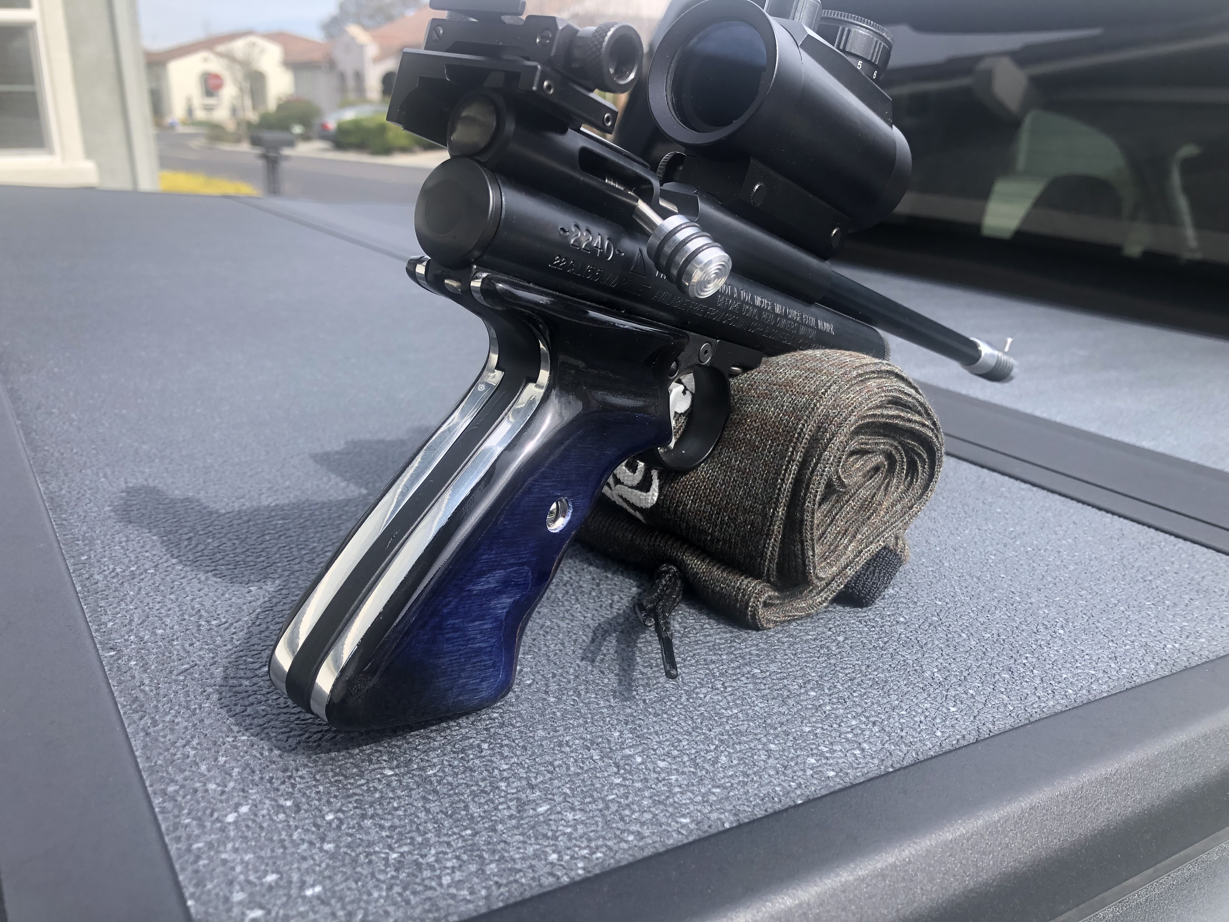

I don't have a Bandit, but DO have an AirBug which is basically the CO2 version of the PCP Bandit. Pretty much any pistol scope will work, or if you prefer a red dot, the UltraDot "type" tube-style dots are adequate for the typical distances that the Bandit would be used. I have an older TC (Thompson Center) 3X scope on my Airbug presently, just for accuracy testing various pellets, using Hawke medium height mounts. After I'm done pellet testing, I will be putting a red dot back aboard. For the pistol scope, the rear ring installs on the dovetail rail behind the loading port, and the front ring on the dovetail just in front of the loading port. The medium height Hawke rings will allow the scope/red dot tube to clear the magazine just fine. Regarding the 177/22 cal thing, I went with the .22 just for ease in handling the pellets. Also, if you are going to "pest" with the Bandit, the .22 will potentially offer more downrange energy for humane kills. Hope this helps a bit.
Hatsan red dot mounts on 11mm dovetail
