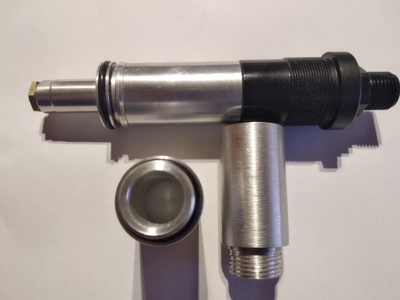

Do you search somerhing like this?
Mine is around 70cc with pressure gauge.
Set to 135 bars i Can push h&n 27 grains more than 300m/s

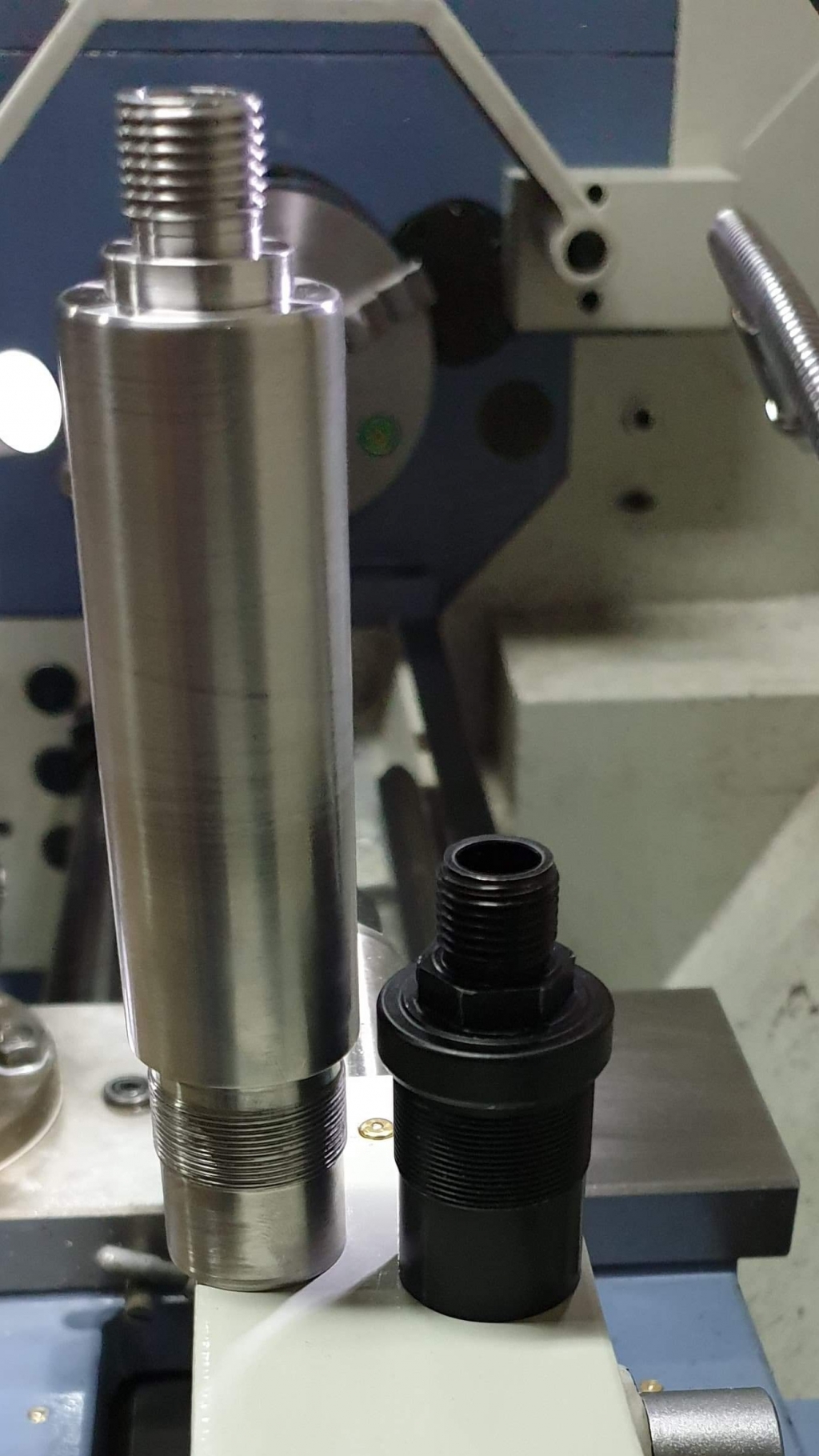

A friend of mine with a lathe helped me with the barrel and now is a tack driver.
I´m wondering putting an huma with plenum or only a plenum, but I want to know the maximum vel achieved by you.
890 fps would be great, but I don´t know if only with a plenum would be enough.
