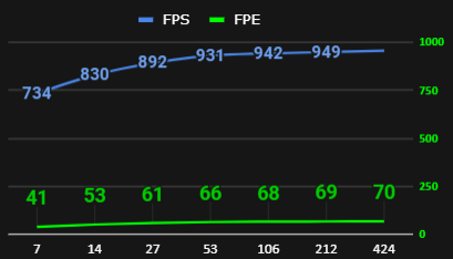

Here is a simple graph with various plenum sizes ranging from 7 CC to 424 CC on my personal rifle (.25 cal with .225" ports)
Another way to view it, if you can calculate pressure usage per shot in CC's, you can estimate how much pressure drop occurs in your plenum during your shot, so a 5cc shot would use 10% in 50cc's, or 20% in 25cc's, which would be a 200 psi drop @ 2000 psi, or a 400 psi drop @ 2000 psi, each creating an average pressure of 1900, and 1800 psi...which is why larger plenums help greatly, diminishing returns occur greatly after the 1.5 cc per fpe mark as shown in the graph.

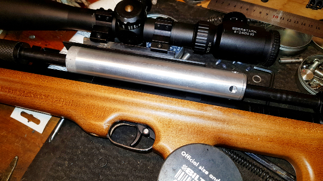

Currently working on an Artemis P15 and realized i need ample plenum volume for this little 22 to become all it can be. So against better judgement i decided on placing a plenum bolted to the integral trigger/barrrel band/scope assy.
As the tube is 30mm diameter i´m planning on using regular scope rings and a rail to pull it off.
Material used is common 6086 in 30*3mm.

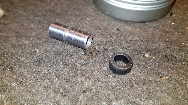

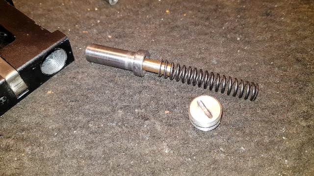

FWIW. I decided on going the reg route. Thus the passages has been reamed out. Hammer spring in turn? No. A new hammer and a spring for an Impact, which is wound on 1,4 vs the stock 1,1 gauge.
Went full retard on the poppet n seal housing, making it two part. The plastics got omitted though at the benefit of JM-7 bearing bronze. Gun is up and running, still need to handle a few minor issues.

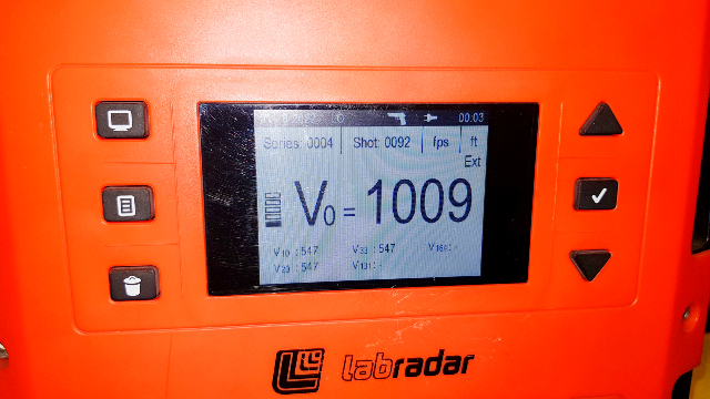

..with 25,4´s. Which is simply to small a number as the intent is for 34 grainers. So the hunt continues. Highest No that night 1017. This though on the stock hammer n spring.
Just did an Artemis PR-900 "cost a nothing" the other week, and that turns an easy 1050 with the same ammo. Content where that is at though, in contrast to this P15. Sports a Lothar Walter barrel a tad longer too, the P15 that is.
So yeah. "Alternative" placement of a plenum is what it is. Plan to bolt it to the stock bracket for the scope/trigger/barrel band with a sorts of weaver and then use regular rings as the tube is 30mm.
