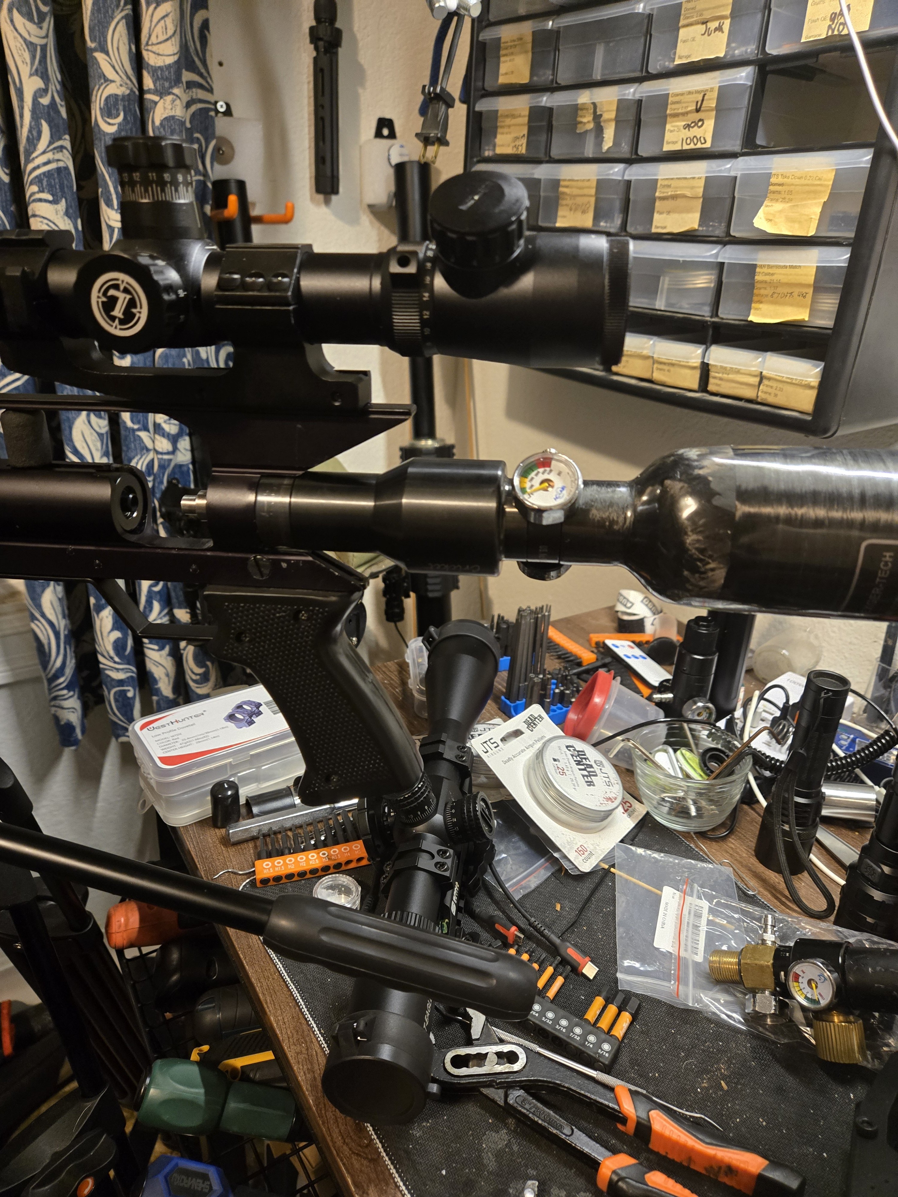

I completely agree they need to be inline. I have multiple Huben Power regulators with inline plenum. Dream, as you know, has a 20CC and Max-ATH has 50CC.
I've got a couple g1/2 to g1/2 tubes that have about 15CC I've added to regulators without plenum. That was a very minimal improvement and the added length just didn't make it worth leaving in.
