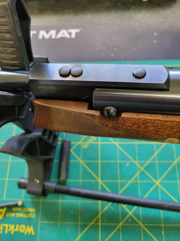

I used a couple of black button head screws that are to small, they are a loose fit
black RTV silicone to hold them in,,, and in the blank hole more RTV silicone
the silicone is easily removed if ya decide to in the future
