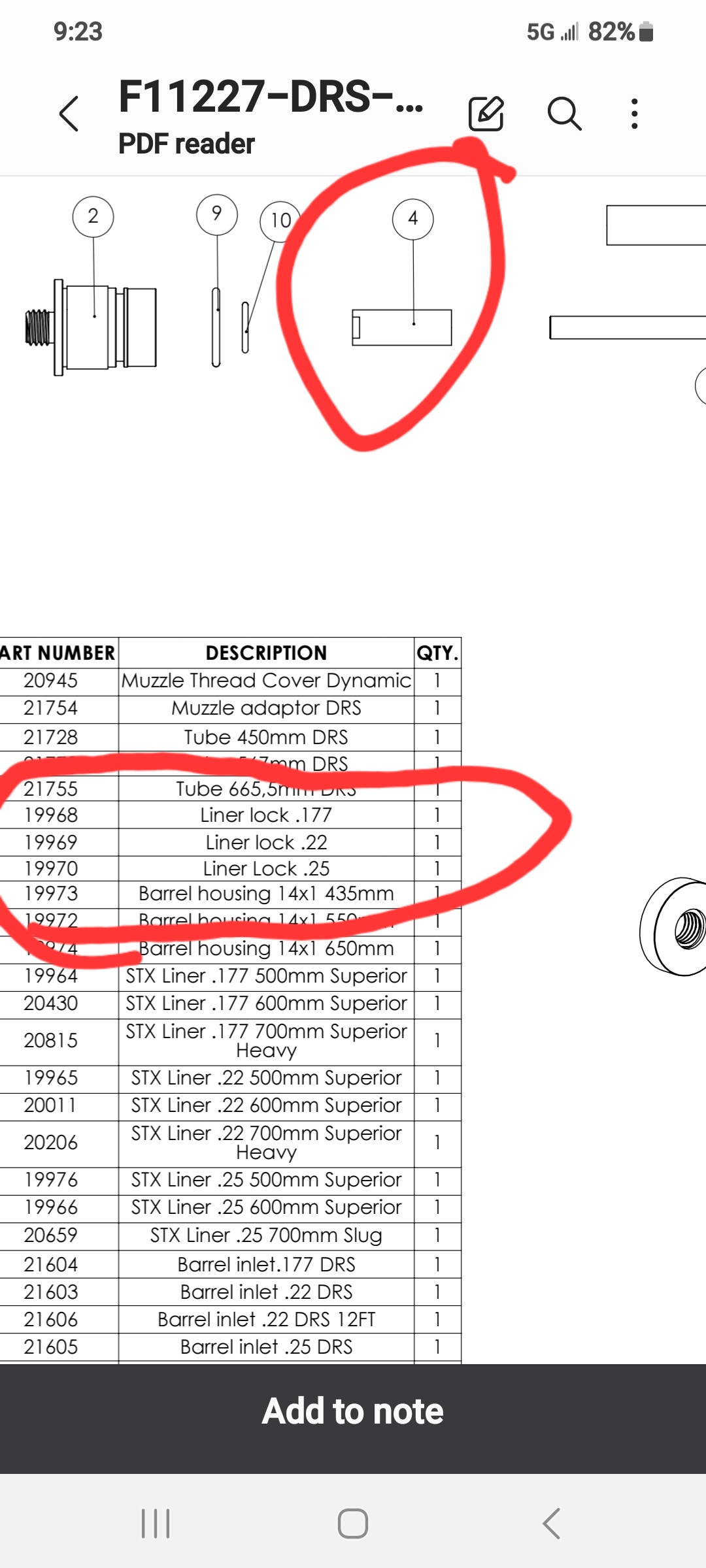

I would check the liner lock

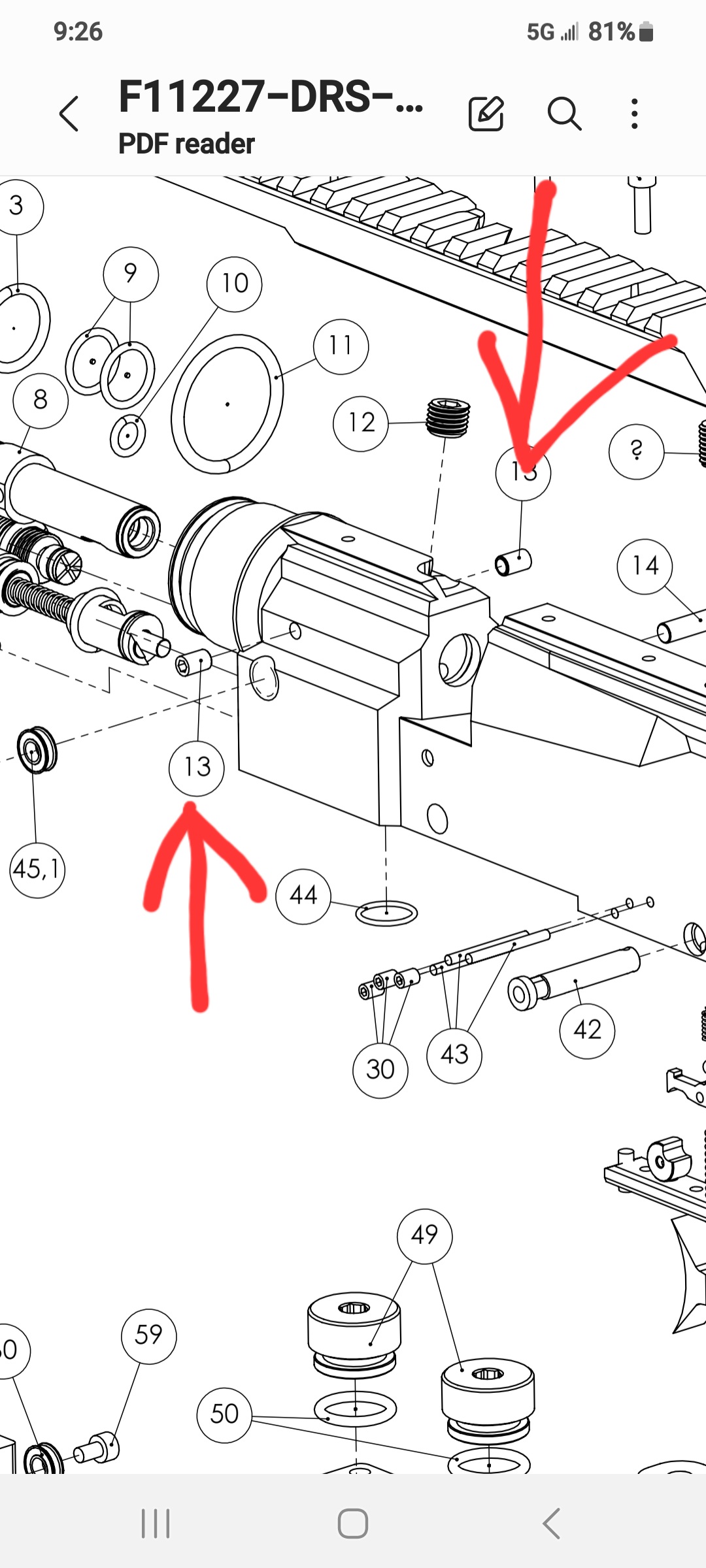

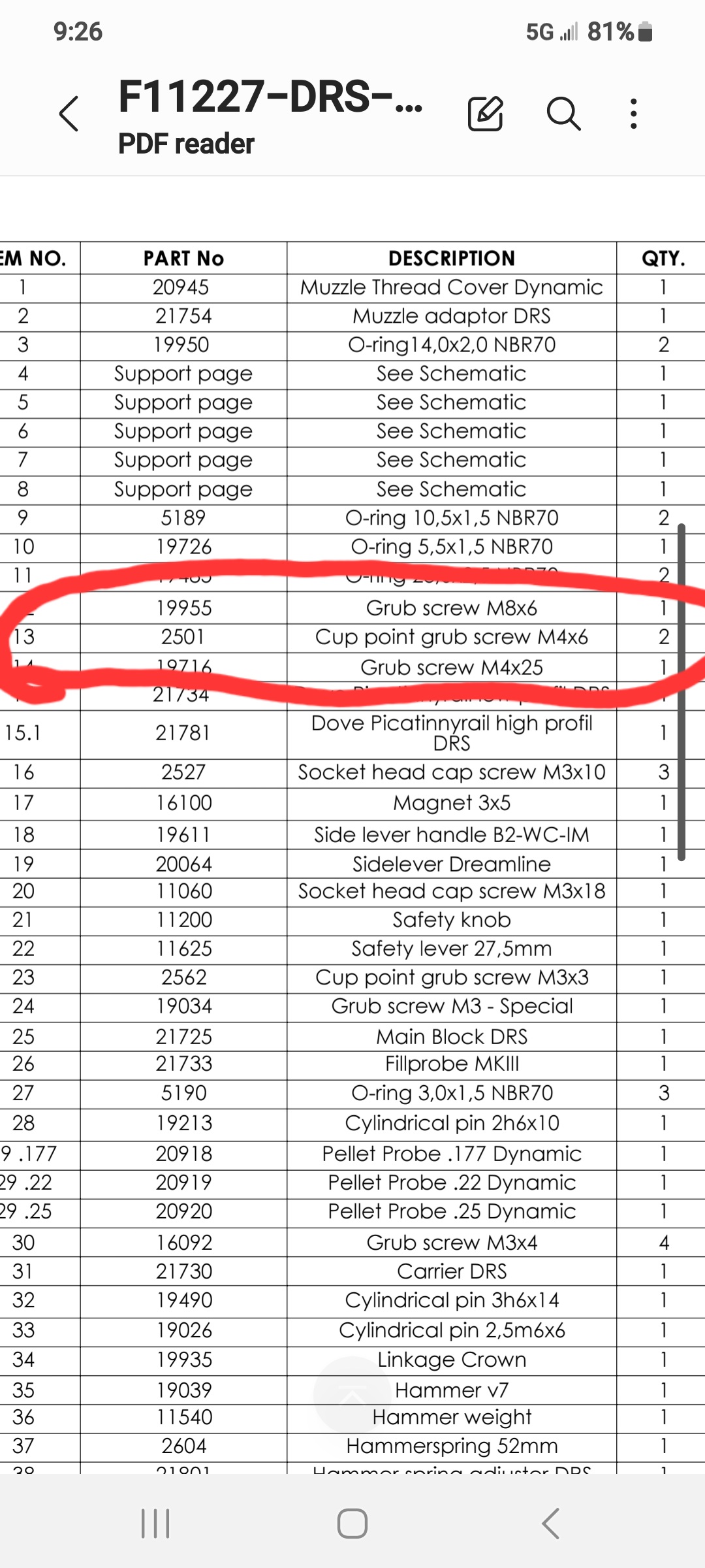

And the 2 grub screws that hold the barrel in the receiver.
