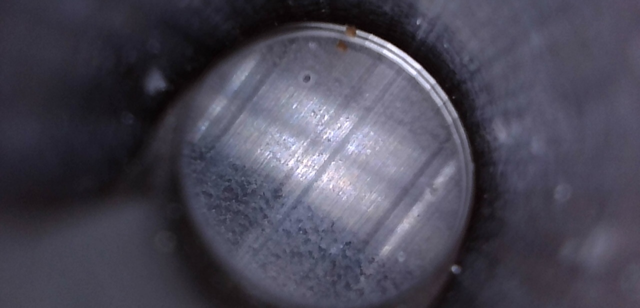

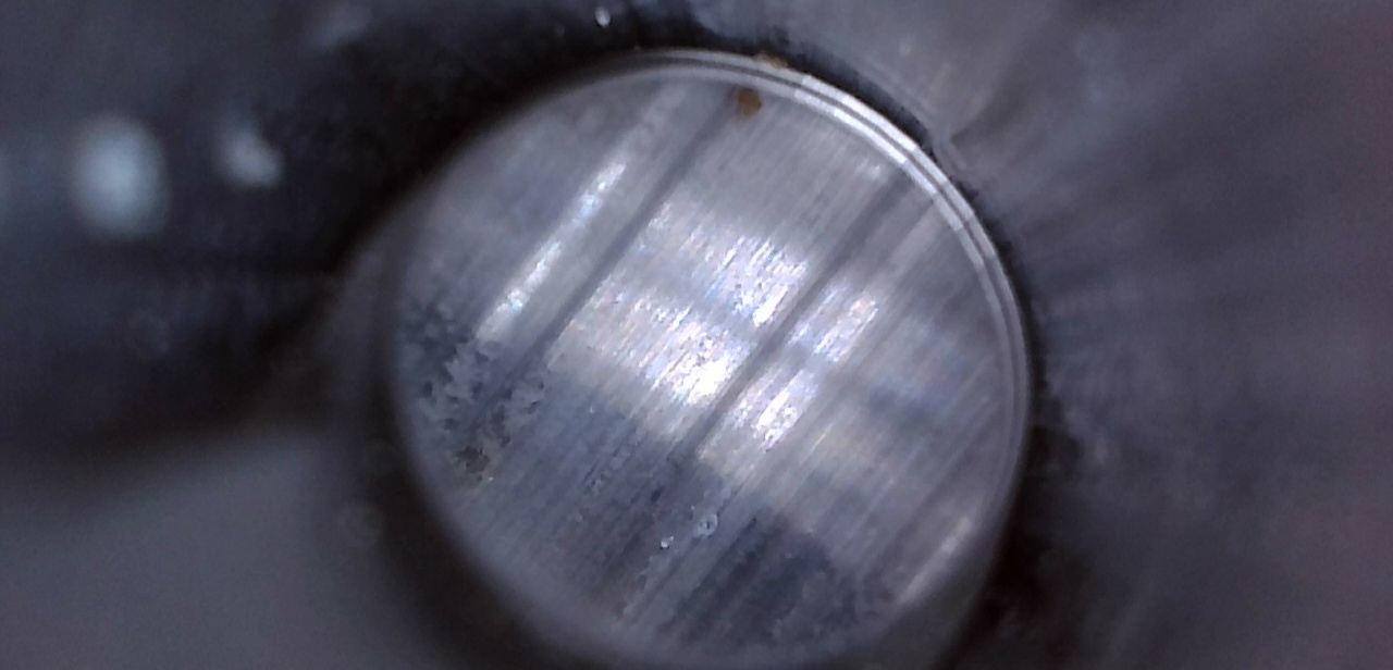

POLISH AN LW POLYGONAL BARREL?
22lr. It's not too dirty at the moment, but I'm following the Vudoo cleaning method, so no solvents will ever go down this barrel, only C4 for the carbon ring.
Well, bore scopes make barrels look ugly because of the magnification. So, yes, shooting well is what matters, rather than looking pretty. What a bore scope can tell is if the quality of the operation in making it were lacking. That suggests the manufacturer did not care about the machining quality, so why would they care how the barrel shoots.
The thing with slugging is that a tight spot swages the slug down, and unless some part of the rest of the barrel is tighter, there is little further signal about the rest of the barrel, unless the tight spot is lapped out first. Insert a new slugs and find the next right spot, and so on.
A tight patch on a cleaning rod can help identify tight spots all the way down, but provides nothing to measure. I think that all of these diagnostic and measurement tools should be used together, rather than using only one.

It's pretty hard to say what a barrel will do on a target by looking at it with a borescope. Lots of things that look objectionable to the eye are not problems on the target. Much more about how it may shoot can be learned from slugging.
Mike
In this case I was simply curious what it looked like, if it ended up very smooth, or still had tooling / lapping marks.
Btw I rechecked my data from another slug, AVS 32 gr .253, and it was the same velocity afterwards. So maybe the first slug (AVS 32 gr .2513) was slower as well? Meh, I'm not concerned.
Ya, sorry. I just making a general comment about bore scopes. Not directing it at you.
Mike
