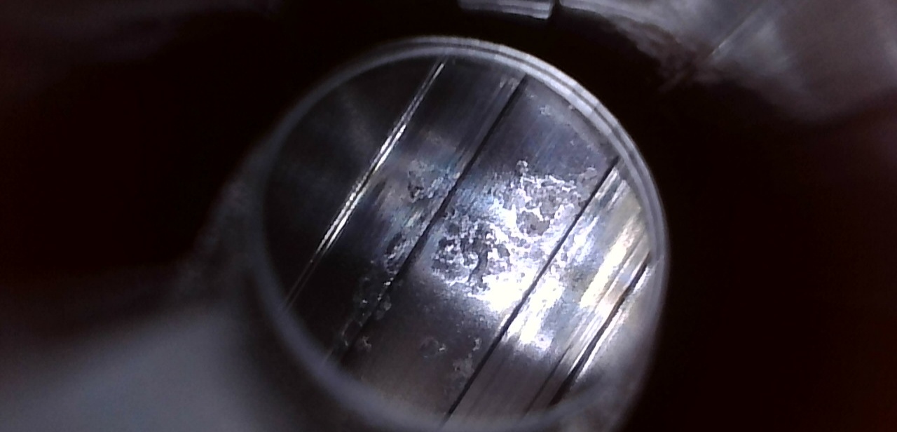

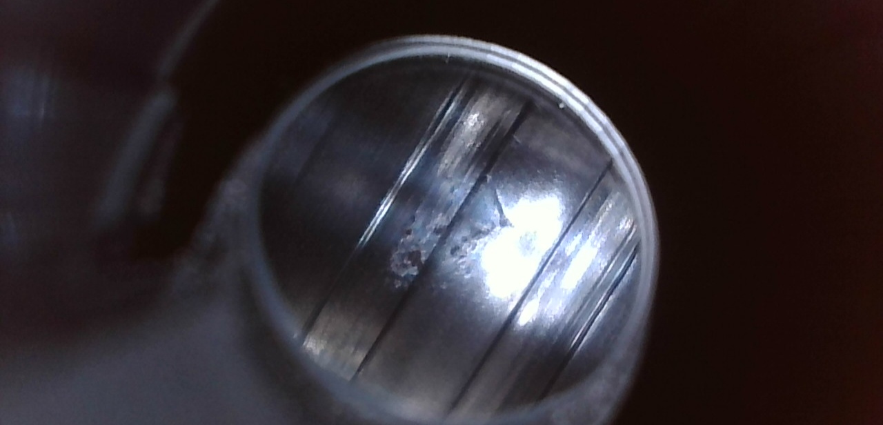

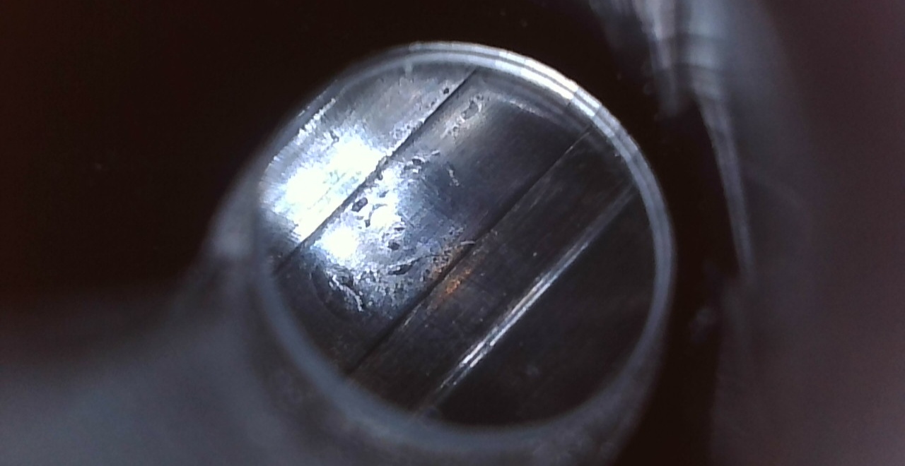

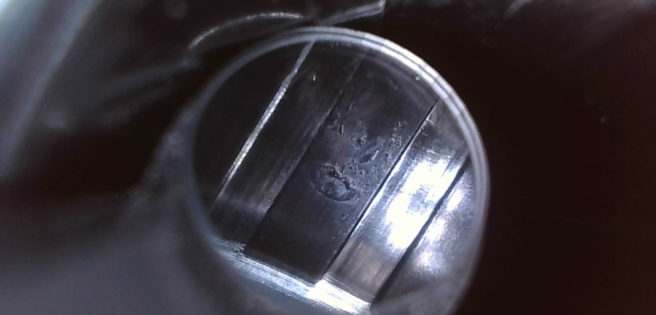

So I finally got around to polishing the .30 cal CZ barrel on my Uragan 2. Scoped it after I was done, and I'm horrified at the bullpoop quality of this barrel. This kind of pitting is through the entire barrel. No idea how it even shot as good as it did. Have not yet shot it after, likely will tomorrow night, I can only hope it's better.
I really have to consider reaching out to AGT to get a replacement.

Yeah, that isn't good. You shooting pellets or slugs.? 1st pic shows edge of crown.? I take it that last pic is after polishing? & lastly how does the barrel feel for restriction by running slugs thru it end to end.?
I shoot AVS slugs (.3033). All those pics are after the polish, and yes that first one is near the crown. I haven't pushed a slug through in quite some time, but IIRC it was pretty even pressure the whole way (unchoked). I suppose, if there are no burs, it might be ok like that. But it's poor quality for what you pay for those rifles.

The last image, taken at more of an angle looks the most like pitting with some depth to it. Yes, there appears to be chemical deposits around that, that may be raised above the surrounding metal.
Raised, or pitted are both unacceptable in a new barrel. Pitted seems worse because raised material may be removable. While a pitted barrel can shoot well, that is making excuses; like saying the Pretoria blade runner had an advantage, because of his carbon fiber shin bones.
I would not assume that CZ released a pitted barrel from the factory, unless you bought it from them. As soon as someone else has stored or machined a piece of kit, the opportunity for corrosion increases, outside of the barrel maker's control.
This includes machining with coolant emulsions that are 99 percent water, that gets left in a partially machined barrel, over a holiday shut-down, for example.

Are you using a cleaning patch, or a lead lap?
Also is the pitting consistently where you reversed direction with your "polishing" procedure? perhaps?
I use a mop and firelap it. There is no way I pitted the barrel with JB bore paste and Autosol and some slugs. Not a chance. The pitting is in the full length of the barrel.
I wish I had more pictures from before the polish. I either missed it, or it was covered / filled with lead.
I gave the muzzle end a thorough cleaning (because it was easiest) first with Gunzilla and then with BoreTech Eliminator (a firearms solvent), both applied liberally with cotton swabs and scrubbed with a nylon brush. Here are pictures from after (compare to first pic above). I see no difference and didn't see any material on the dry cotton swabs used to clean the solvents. I'm open to other theories but I would have expected any lead to be removed.
