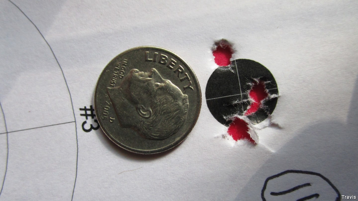

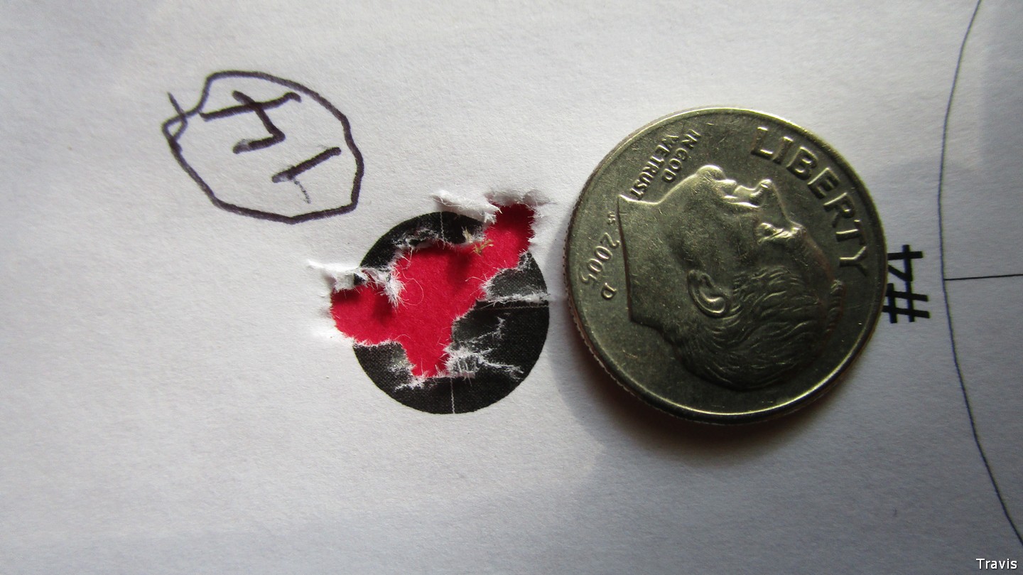

OK not perfect conditions for testing the Bore Polish Work on the Barrel but here are some early results;
Temperature: 82
Humidity: 91%
Wind: 6 mph
Total number of shots: 88
Maximum distance for a Flyer: .342"
High FPS = 753
Low FPS = 744
Spread = 9
Deviation = 3 ( big improvement here )
I have to say that my concentration was not 100%, it is hard to shoot when it is this hot and I have sweat running down in my eyes. Overall after 88 shots I still had some Flyers but as shown above not near as bad as in the past, so a good improvement here. Consistency in spread, speed and deviation an improvement also. BUT, accuracy was not improved ( not counting the Flyers ), however I made no adjustments to the rifle. With this “new” barrel I believe that it needs to be re-tuned to achieve maximum accuracy, ( Regulator, Hammer Spring, and Pressure ) to use the same ammo ( JSB Exact Monster 13.43 ). Attached are two photos showing typical 5-shot groups and the max flyer out of the 88 shots.
Oh yeah, Tom @tcarlson777, you are correct about cleaning the barrel, after the 88 shots I pushed a cotton swab just one time down the barrel. I opened the breach and put a light in and looked in the muzzle and it looked like a mirror :)
I hope sharing this information will be of some benefit to others, and it has been fun for me.
Be safe and have a great day,
ThomasT

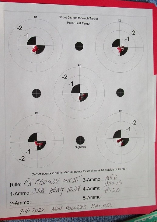

Hello everyone,
After over 150 rounds of various pellets shot through the rifle it is as I had expected, the New Polished Barrel needed to be re-tuned. It’s almost like this is a new gun and the polishing work changed the dynamics of the barrel. I went back to my old charts where I had tested over 20 different pellets and choose 4 to test with the new barrel. Turns out that the JSB Heavy 10.34gr shot the best with no flyers out of 25 shots, see the attached photo. That is 5-shots per round at the five individual targets. The Crosman Domed 10.5gr shot an almost identical pattern with no flyers. I have made one adjustment to the rifle and I moved the Hammer Spring Setting up to 16 but left the Power at Medium and the Pressure at 120. Again I hope this information will be of some help.
Have a great 4th of July,
ThomasT

@ThomasT,
Those groups are looking really good. One of the things I would have expected, and was verified by your data, was a reduction in the standard deviation of your velocities after polishing. At this point you can try adjusting your velocity up and down to find an even sweeter spot where your groups shrink with the same pellet.

Hello Feinwerk,
I did play around with the Power and Hammer Spring settings quite a bit but did not change the Pressure. I tested 4 different pellets and found that the Med and up to 16 on the Hammer turned out to be the best settings. However the JBS Monster 13.43 pellet that I have been shooting came in a distance 3rd with the JBS Heavy 10.43 and the Crosman Domed 10.5 a first and second. This morning I shot four of the 30 Yard Challenge targets and on my last target I shot a 199 with 18xx's and zero flyers. I believe the New Barrel is now "seasoned".
Now I am not very careful when loading a new pellet as you described, so I will apply you process from now own, thank you for this good advice (y) .
Have a great day,
ThomasT
