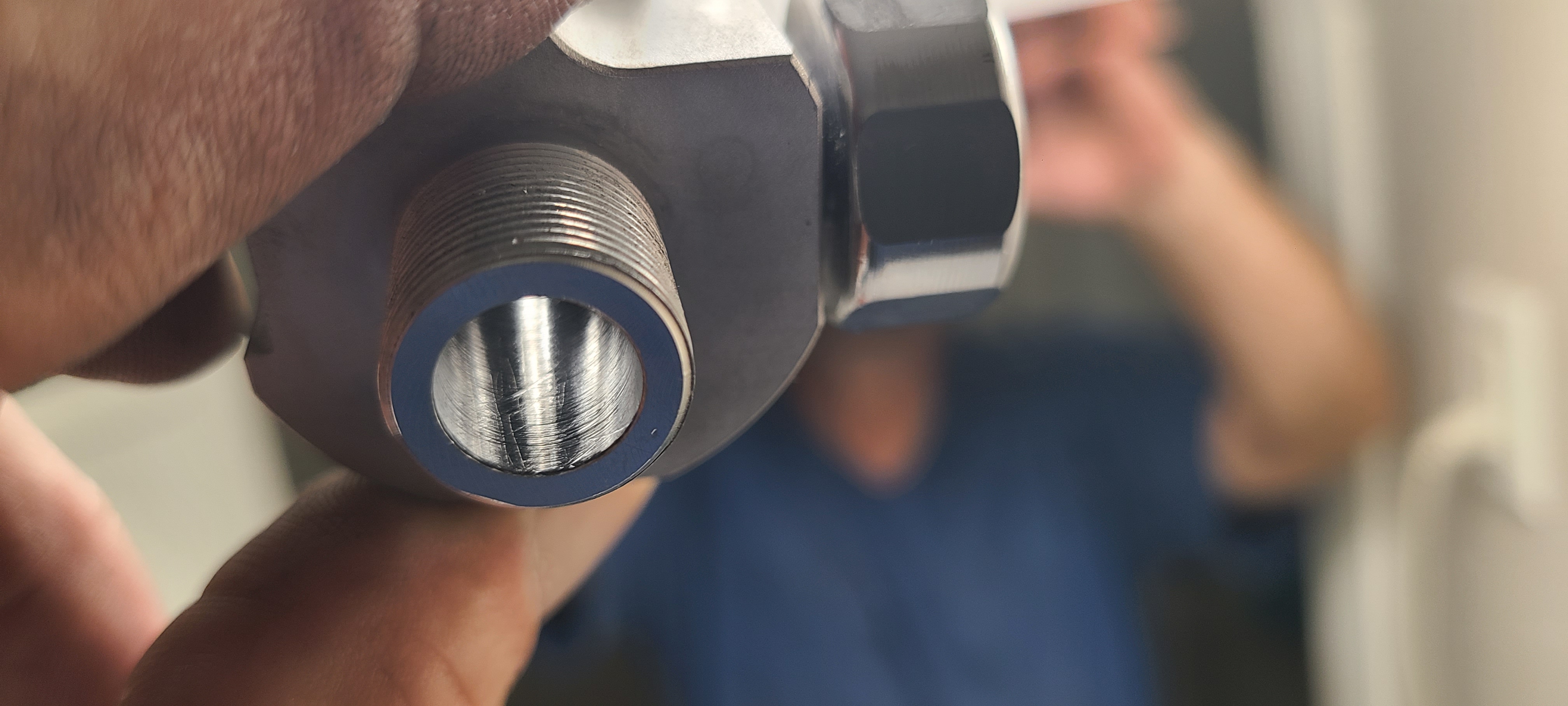

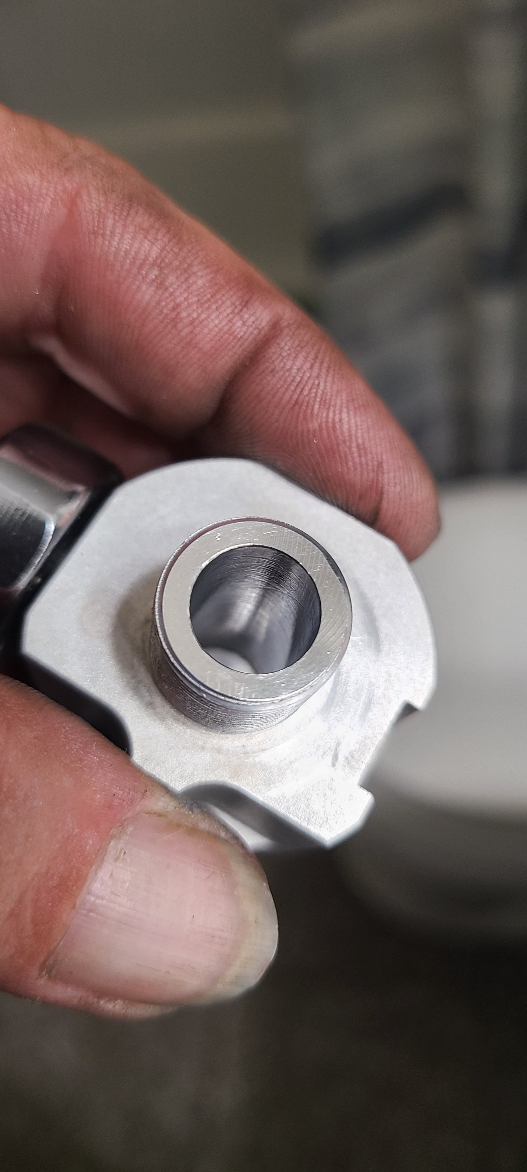

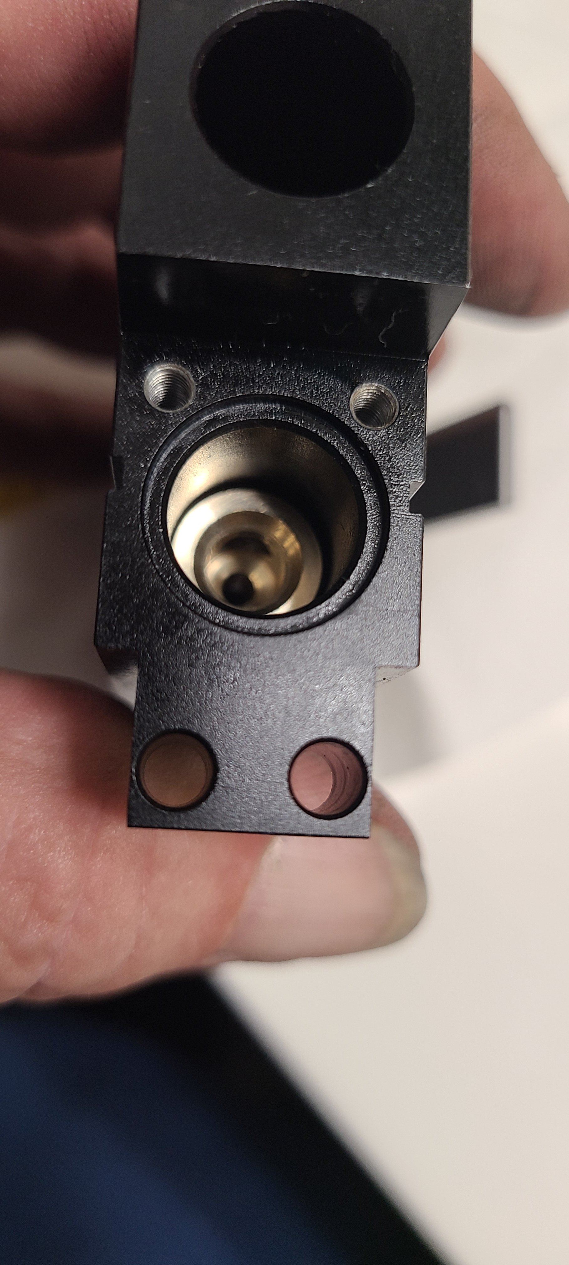

Decided to open all ports contour and polish to a mirror finish wasn't easy
Also got a peek valve
Ported polished the poppet seat all ports 4.2mm
Except the new gauge block that's at 6mm
My scope only goes to 5mm
Otherwise I could show all the polishing
Here is a pic inside the block

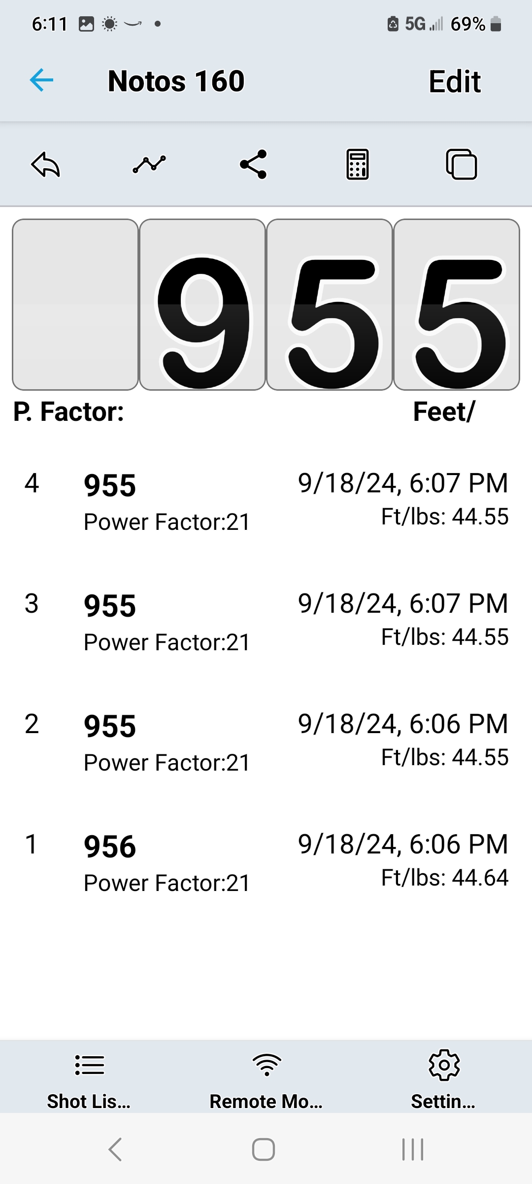

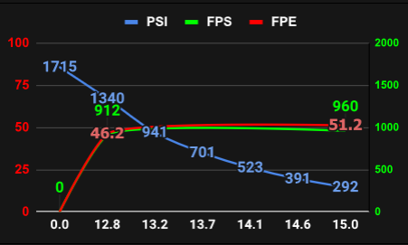

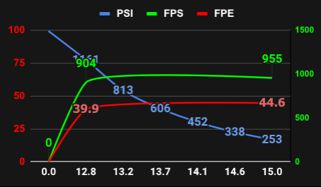

What I see is normal to me, left graph is 130 bar with 22 gr, right graph is 150 bar with 25 gr. Both are predicted outcomes using some maths.
Hope this helps. If you expand on what you're confused about I could try to shed more light on it. If your 955 with 22 grain and 960 with 25 gr was at the same pressure, I may be confused too!

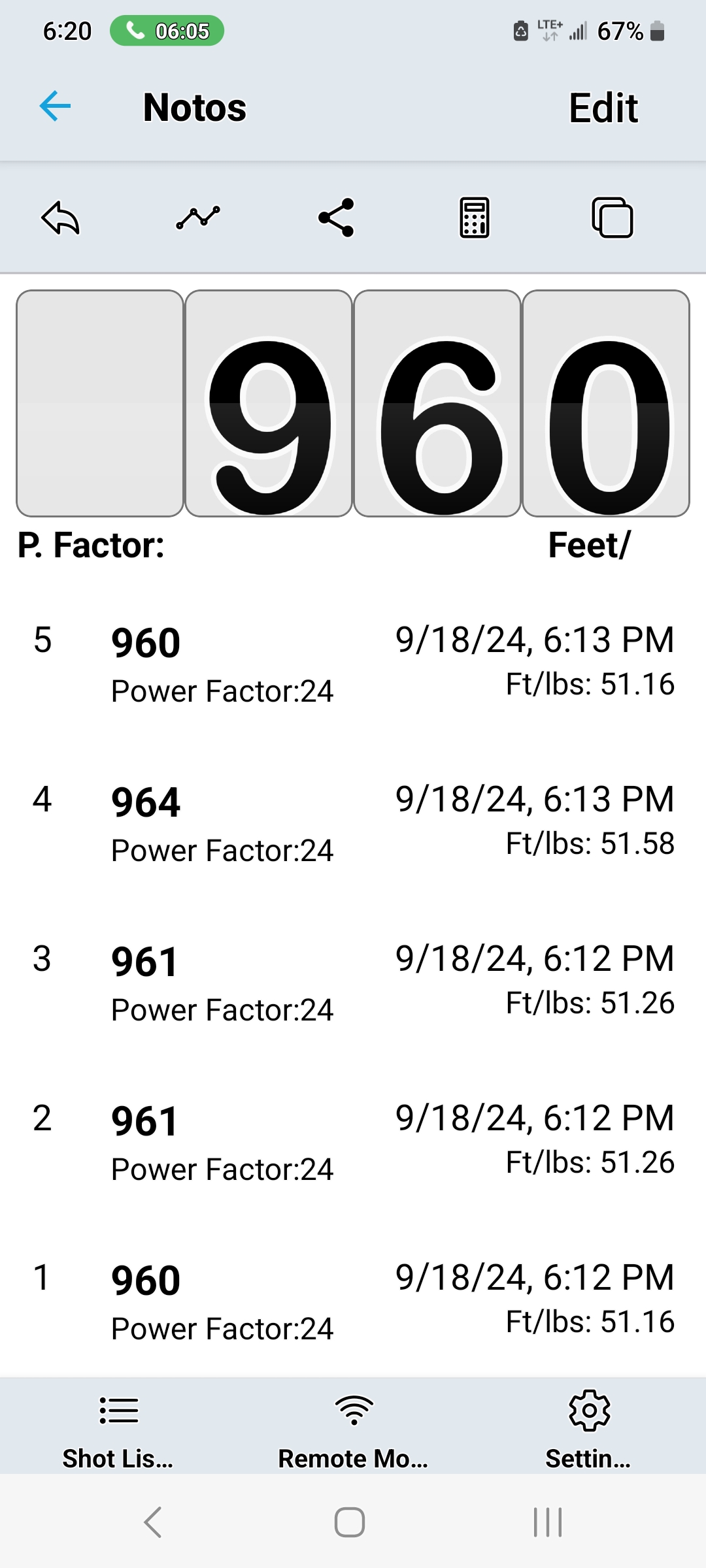

so you pick up 1 fpe for every 1 fps
is that volume of air at the bottom of the screen?

No no, you swapped from 22 gr to 25 gr on the two correct? Sorry if I misunderstand. Once you push a certain limit, the only way to gain more FPE is with heavier ammo, as the lighter pellets out paces the expansion of gas behind it, where as the heavier ammo remains in the barrel longer picking up more steam. Although that only applies until it doesn't, which happens to be around 1.6~ grains of pellet per 1 grain of air...which takes a bunch of more math to figure out.
Curious what your total plenum volume is, definitely up there in CC's, you generally want around 1-1.5 CC to 1 FPE to achieve near maximum energy available for a given gun.
The bottom is the barrel length, although I am unsure if you have a 500mm barrel or the 380mm barrel in that bad boy.
-Matt

No no, you swapped from 22 gr to 25 gr on the two correct? Sorry if I misunderstand. Once you push a certain limit, the only way to gain more FPE is with heavier ammo, as the lighter pellets out paces the expansion of gas behind it, where as the heavier ammo remains in the barrel longer picking up more steam. Although that only applies until it doesn't, which happens to be around 1.6~ grains of air per 1 grain of pellet...which takes a bunch of more math to figure out.
-Matt
