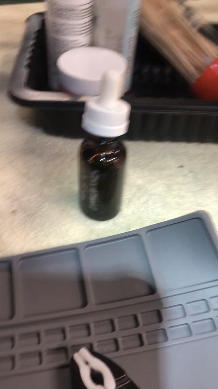

The applicator, which is the key tool here-

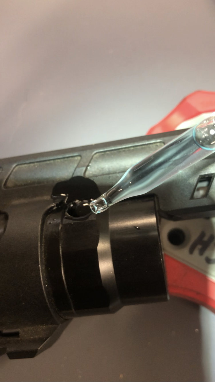

Just a small drop applied with a nose dropper bulb, as seen here-

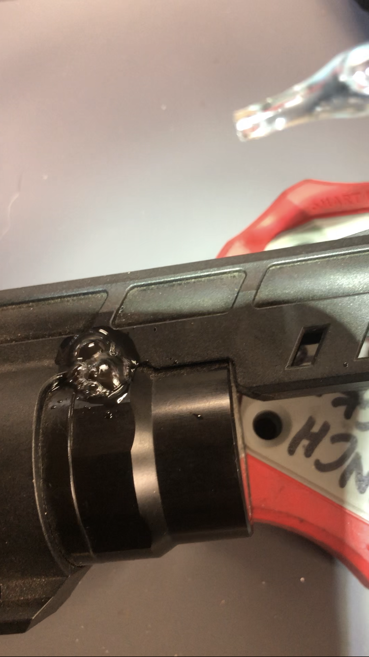

This was on an HW44 that wouldn’t hold air, very slow leak. I had a hunch, and found it instantly with this method-
Clean up was easy, no over spray or water running into other areas of the gun, and quick results.
The most stubborn leak I’ve found using this dropper method with, was the Dowty seal to bottle leak on an impact. When this leak detection solution worked its way into that very slim seam, with the use of a flashlight I could see a very very tiny leak. This was the type of leak that after a full gun fill of 250 bar, the pressure would leak down to 225 bar which took almost 8 days, then the leak would stop. Fill again to 250 and in 8 days the needle stops at 225 bar and never goes down anymore. Those are tough leaks to find, but this method found it
