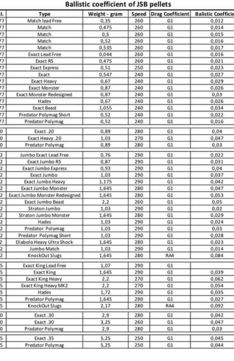

Thanks, yeah, I have that chart, too. ✅
The chart just doesn't inspire a lot of confidence when they use a drag law ("drag coefficient") for a projectile (G1) that is so drastically differently shaped from a Polymag.
Besides, we know nothing at what muzzle velocity or at what range this value was obtained, or which ballistic calculator was used. 🤷🏻‍♂️
➠ I was hoping that someone has done their own measurements, using a better and more transparent setup.... 😊

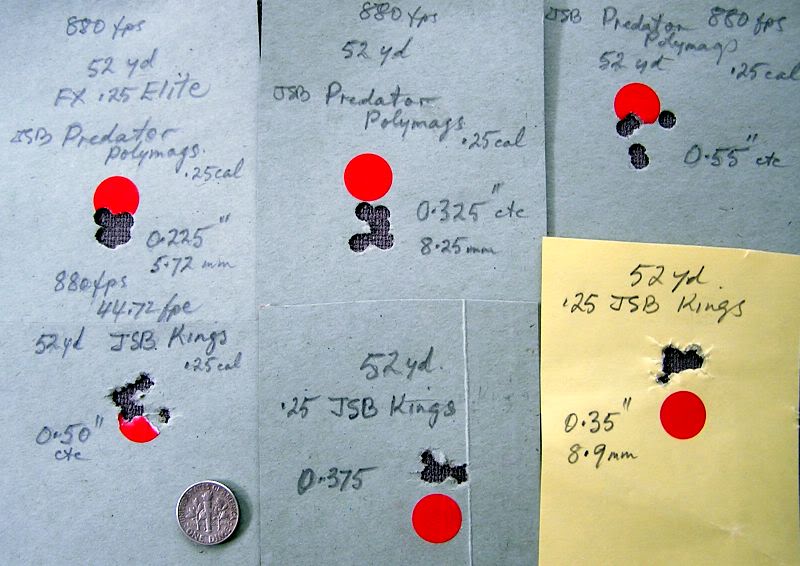

And guess what, I have registered your data in my collection, from 2011(!), that I found here:
No clue what BC calculator you used back then, what drag model, and if you had the chance to take into account elevation/ air pressure.
➠ But as always.... — you researched, you documented, you published — always helping, always moving airgunning forward. 👏🏼

.25 cal Predator Polymags are brilliant when shot from original Smooth Twist barrel. Nothing else beats their expansion at reasonable velocities. The sound on a rabbit or fox is like a bat hitting a mattress.
🔘 Harry,
your shooting skill puts you right up there with Dirty Harry. Thanks for those data points, such good groups at 52y and with pretty high velocities are very encouraging. 👍🏼
