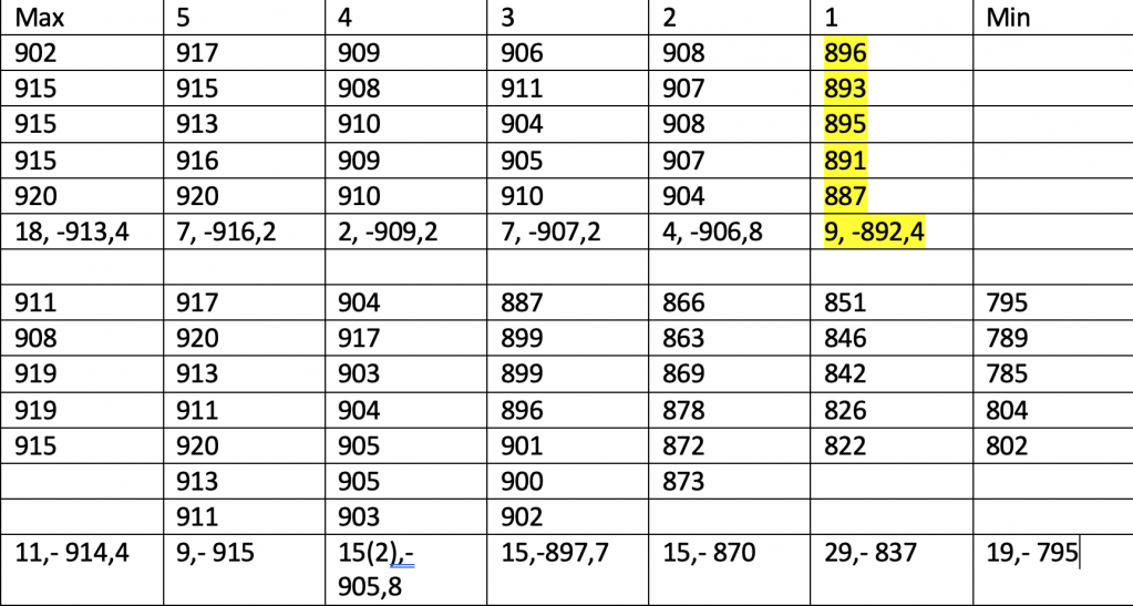

I tried tune the rifle by setting the hammer to max and reg pressure to130 bar. then shooting over chrono and adjusting the hammerwheel down. I had to loosen the hammer some and found shooting jsb 15,89 grains around 905-910 f/s was pretty consistent. My shots are from 904 to 910 f/s.

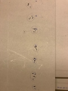

I then tried group testing. There was little wind and about 7 degrees celcius.
when I just took the rifle out it was shooting mayby 1" high for some shots then it would start group pretty good and then all of sudden it could shoot low, high or right.. But sometimes I had 4 shots in a row that was hole in hole.. Filling the rifle again, and brought it out shooting, it shot a new place..
What is the problem here? is it just not in harmony? should I go lower in velocity? higher?
