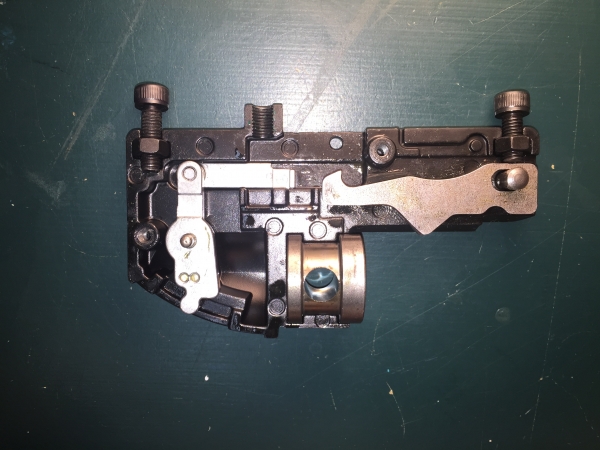

I have had three Terrus rifles. After shooting them for a few to many months they developed a problem with accuracy - specifically shooting erratically low. When the first two rifles developed the problem I got a return authorization and replacements. With the third rifle I encountered another problem. Over time the rifle would not cock when I tightened the front trigger screw. I loosened the screws and it cocked but was not accurate. I took apart the trigger on the third rifle and discovered both problems are related to the length of the trigger/stock screws. They are ok when you first use the rifle but with tightening the screws you compress the stock and the screws need to be tightened again. (There is very little bearing surface at the screws.) With successive tightening the screws impinge on parts in the trigger case. The front screw hits the bottom of the sear attached to the front pivot pin and keeps it from cocking*. The rear screw hits a metal stop that gets deformed and forces the trigger case to split open at the lower rear. I experienced this problem on both wood and synthetic stock versions.
My solution is to install shorter screws in both locations or shorten the stock screws. They should be at least 1/8" shorter. Perhaps another solution for the wood stock is to put a large washer between the trigger guard and the wood stock to shim it out and get more bearing area for less compression. There may be other better solutions. I am not expert and this is just my warning to look into it to avoid a these problems.
*diagrams of the Terrus trigger internals on line are slightly different from my rifle's trigger.
The left screw is to the rear and impinges on the metal below the nut deforming it and splitting the case.
The right screw (has been shortened) impinges on the sear below (in picture) and prevents cocking.

I've found this post 3 years too late. I purchased one with a wood stock and fealy enjoyed shooting it, light, accurate and powerful enough to warrant putting a scope on it. I took it out of the stock for a bit of maintenance work, oiling spring etc upon reassembly, the bolt in front of the trigger guard "popped" and started spinning, acting like a stripped thread, When I tried to remove the stock, it wouldn't come away, the bolt ,although not engaging, was firmly stuck in place holding the works to the stock. I couldn't return it to UMEREX as they only want the action,not the stock and it was well past the warranty. Last week I took it to a friend of mine who has a mech shop, we cut the bolt head away (wasn't easy) and were able to sperate the action from the stock. Looking at the rear end of the trigger housing, it had separated just as you describe and probably created enough space for the front not to engage properly. At this point, knowing that the unit is no longer 100% safe or reliable, I'm not going to do anything with it, save my time and money. put it down to bad design.and junk it. After seeing your post and adding in my experience , I strongly advocate anyone to take a pass on buying a Terrus with wood stock sight unseen or used, i don't know if plastic stock users have had problems ? ) Other airgun forums have also posted about issue with the "Terrus trigger unit".,, your post has the best answer out of many. I won't be picking up anything by Walther in the future, a real disappointment and shame considering their reputation.

John 57, are you sure the trigger had been modified ? Using my "rescued" Terrus yesterday, not only was the trigger extremely sensitive but the gun discharged spontaneously a couple of times immediately on turning the safety off. . Could be that once the trigger unit has become separated, it makes the whole trigger assembly unstable. Maybe your friend hadn't modded the gub at all and was just passing his problem over to you. Can you take your gun out of the stock and have a look at where the two halves of the unit come together and see if there's a gap ?
