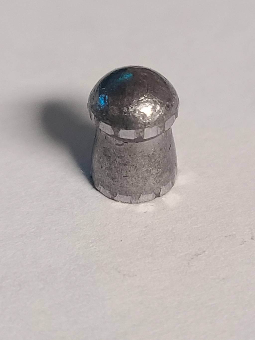

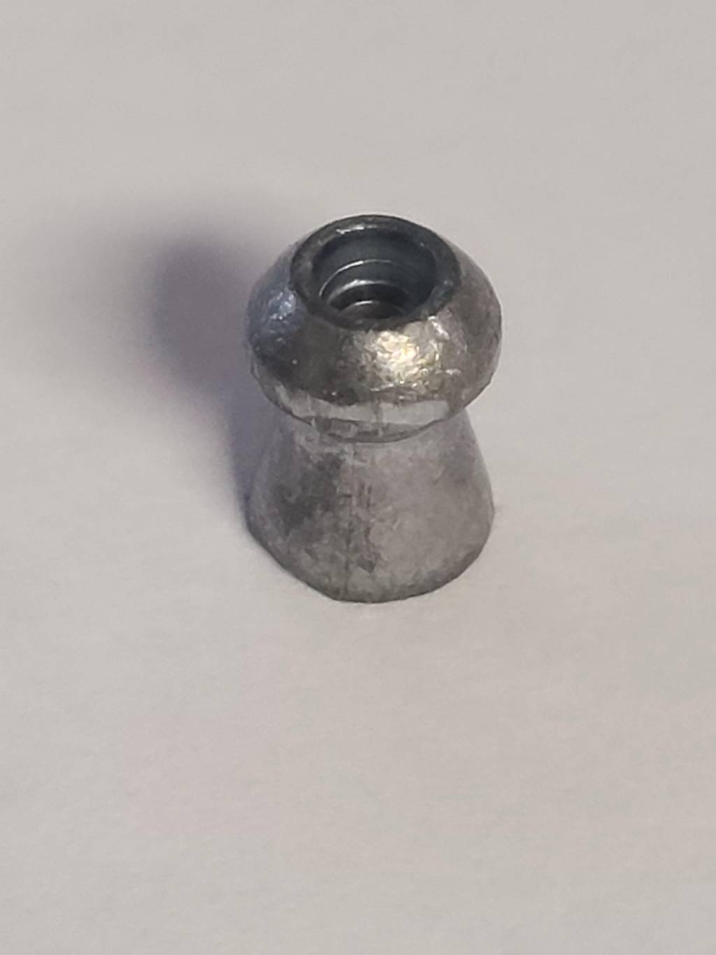

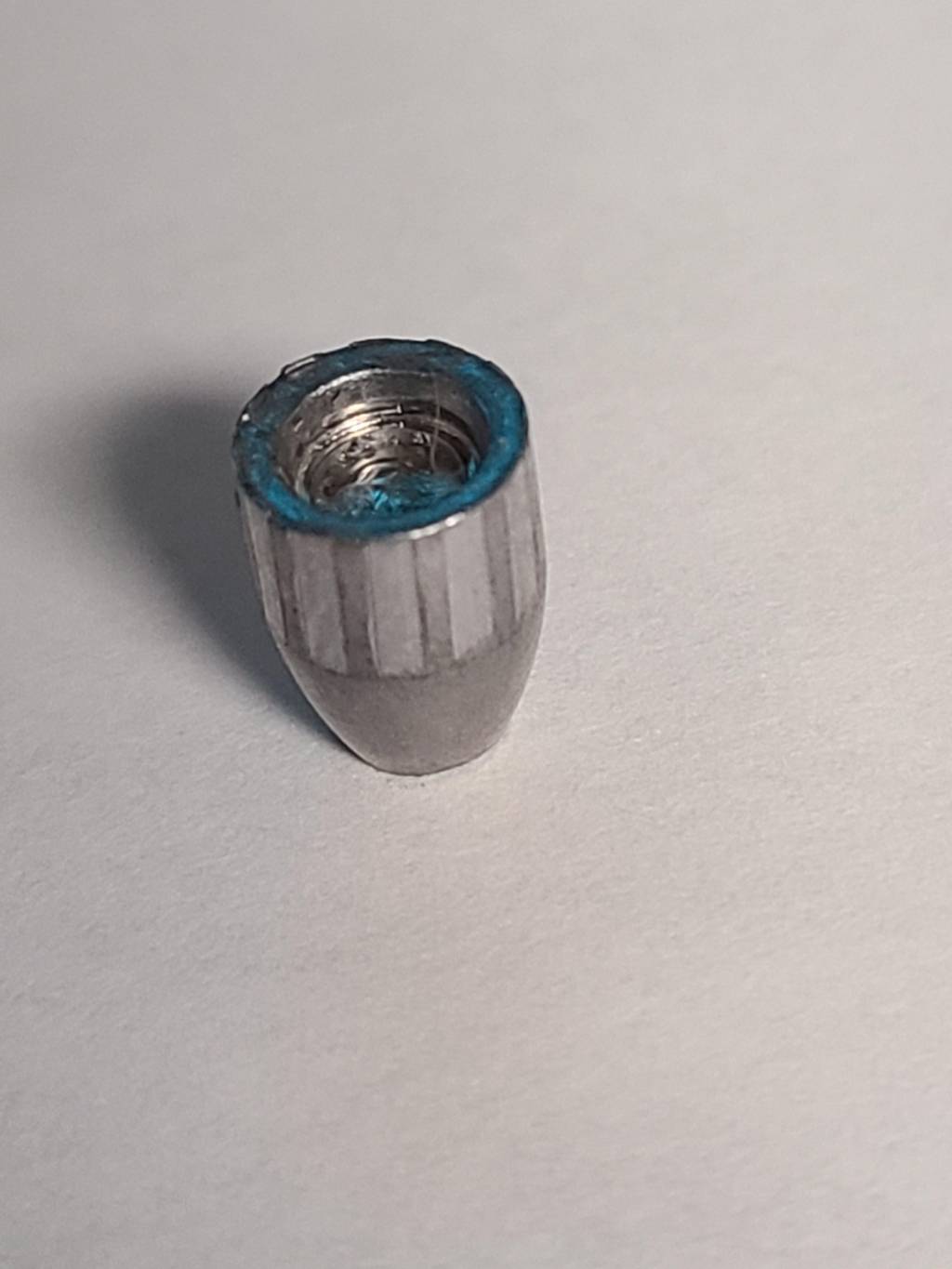

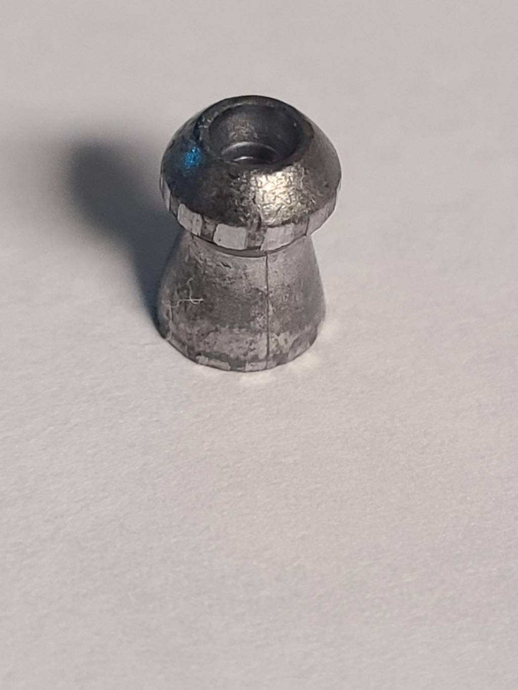

However, tonight I pushed a few pellets and slugs into the breech using the single shot tray and back out for inspection. It appears that the pellets are being pushed across some kind of burr in the breech, while the more pointed slugs don't exhibit this same effect. It is most noticeable on the H&N Barracuda hunter, while the JSB look like good crisp rifling marks on one side, and light marks on the other. I would think that the choke would eliminate this as it exists the barrel, but without removing my barrel completely to put a pellet all the way through I don't know for sure.

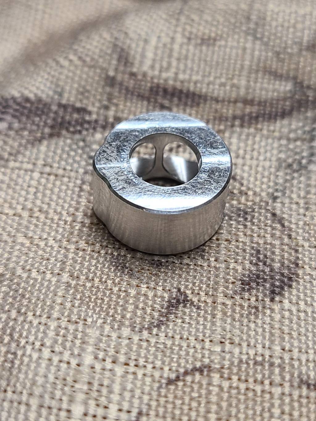

I removed the barrel and found the culprit causing slight shaving of pellet during chambering, and took some 2000 grit and cleaned up the burr that was causing it.

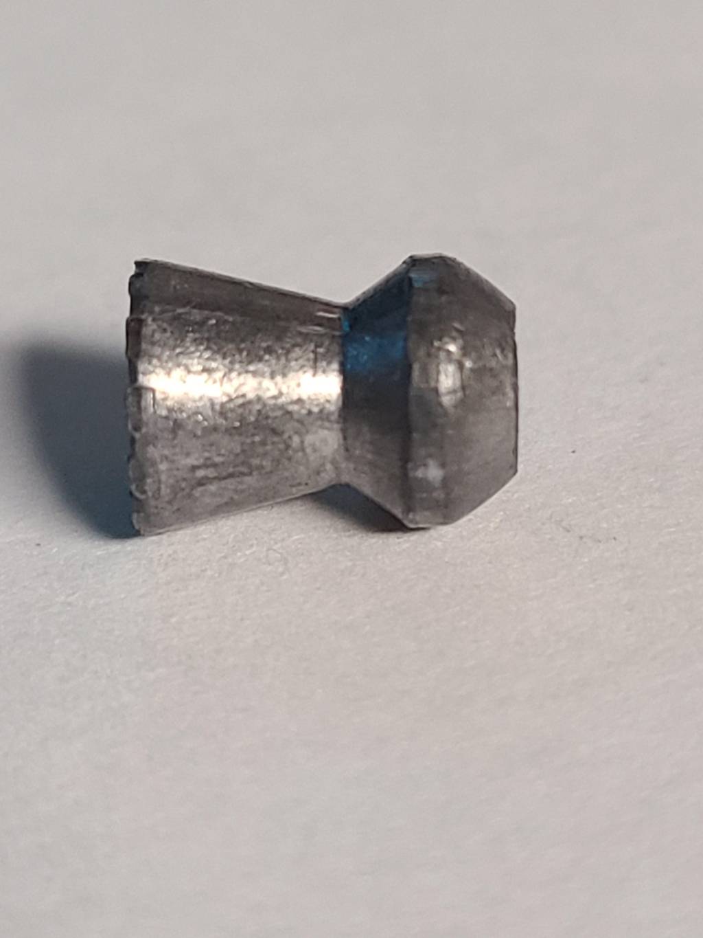

Pellet after removing burr.

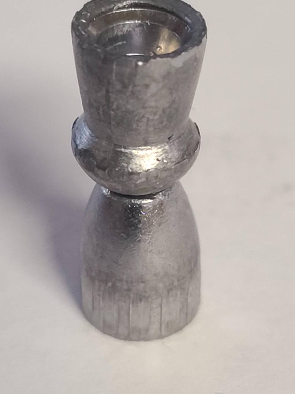

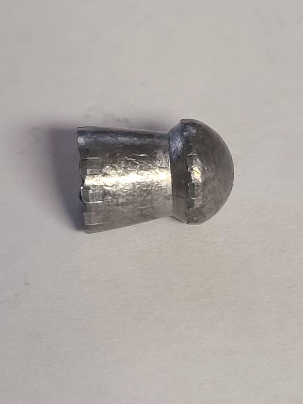

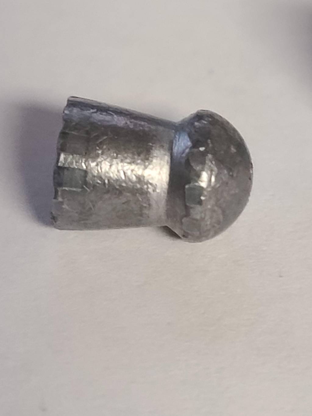

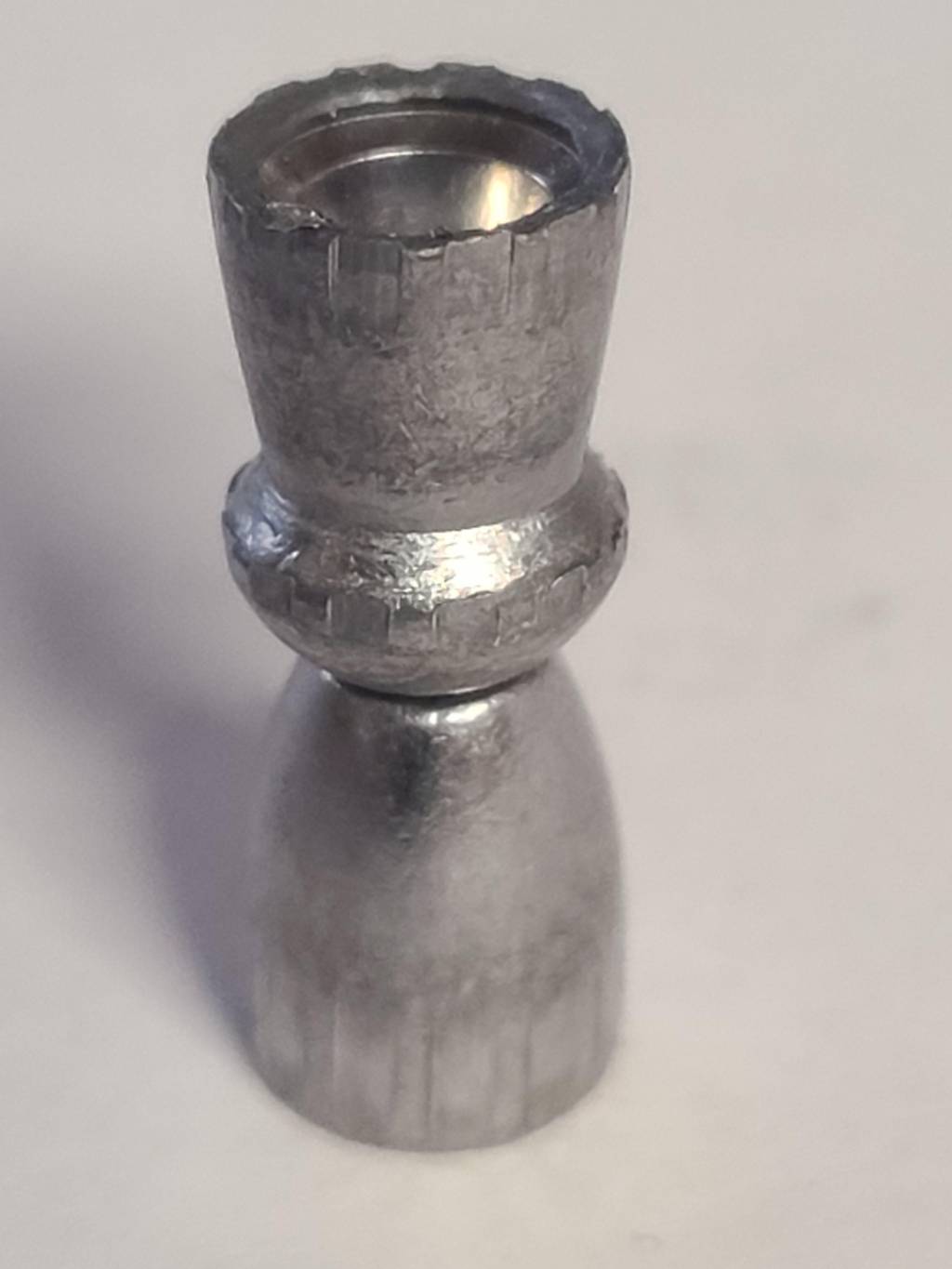

I pushed a few pellets and slugs through the barrel while it was off as well.

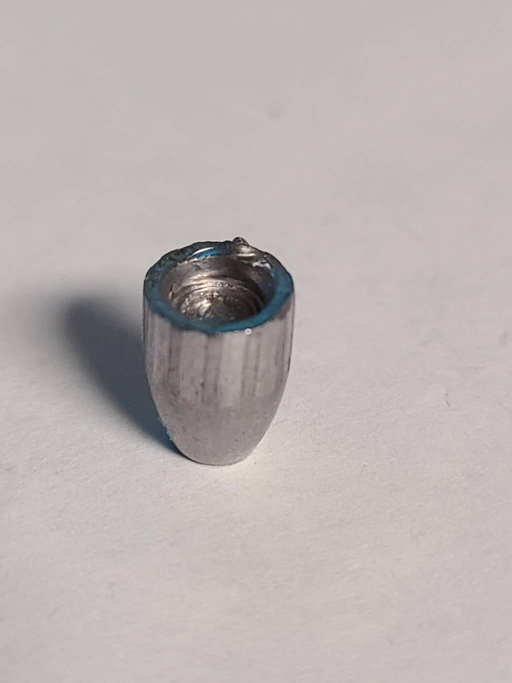

Rifling looks good on the pellets, but the slug shows that lead is being pushed back, with the slug that was tapped through the choke a little quicker showing the most deformation. Prior testing had already shown this barrels choke didn't prefer any of the slugs, which this damage from the tight choke appears to answer the reason why.

Great detective work, sounds like you need a bore scope. That slug is pretty badly damaged, curious on the cause.

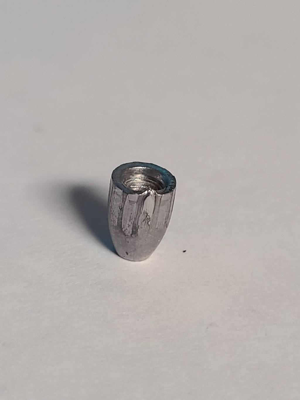

I looked down the bore the best I could and there doesn't seem to be anything that is blatantly obvious that could cause it. My best guess from all the lead fouling and dust that the slugs were causing from shooting, that it's just due to the tight choke and the amount of engagement between slug and rifling. Since all the lead has to go somewhere that is displaced by the lands, the faster it is moving the more friction causes a galling effect on the lead.
I definitely tapped that one through pretty quickly, which might not allowed it to turn on the rifling as well, as it was pretty adhered to the dowel rod I used... with the next slug I tapped it through very slowly to see what the cause of the first condition was, which was the better looking of the two. With pellets there is much less contact area, and more room for lead to be squished to where it needs to go. I believe this is why most slug barrels are unchoked, or a slug sized appropriately must be available to shoot as intended.

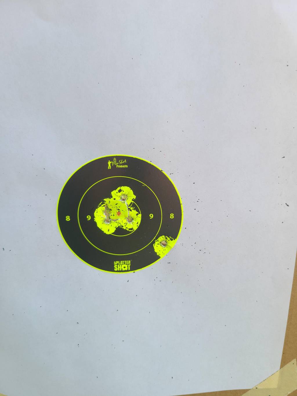

I missed your first post about this so I don't know what what constitutes a 'flyer.'
Sorry, this is continuation of a post where I took the gun out and shot at longer ranges. This target is one example, but this seemed pretty typical of each group having a flyer. The wind was still, so even at 100 yards crosshairs could be held dead on, with only adjusting for drop. Pellets sorted and all weighed 34.20-34.29 by my scale for this group at 48 yards.
Good job on the find/fix! It looks to me like your choke is a bit aggressive regardless of the fix. The peeling back of lead on the tails and the extra deep grooves gives it away.

Was this group before or after you removed the burr? Have you done a chrono test? If not, you will be doing yourself a favor to keep the Taipan reg unless chrono testing indicates an issue. I seriously doubt that it is a problem. To cause that kind of flyer at 48 yards, the velocity variation would be extreme.
This was a group before finding TP burr.
