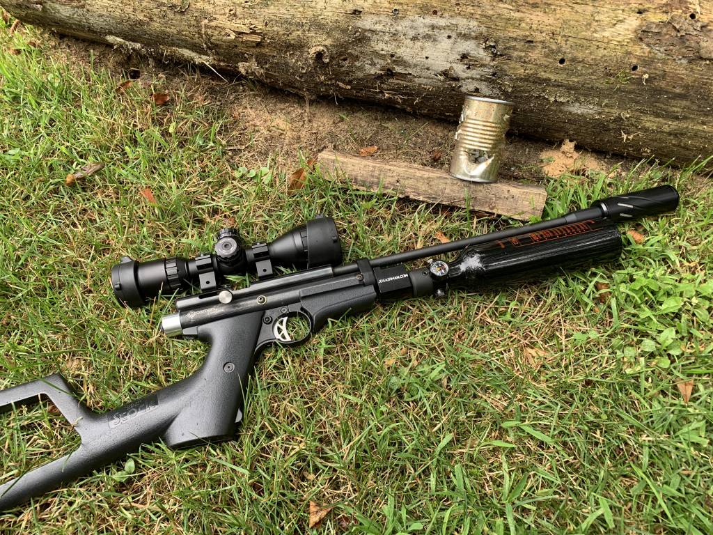

Mine will but I’m cheating with a bottle and a reg. It was quite a few shots that made that hole in the can. Finally got bored of swishing pellets through that hole. I hadn’t shot the gun in a while and was pleasantly reminded of how well it shot and it inspired me to snap the pic. This was last summer and I don’t think I’ve shot the gun since. Sometimes when I reach a goal with a build, I don’t shoot it much after I accomplish it.
