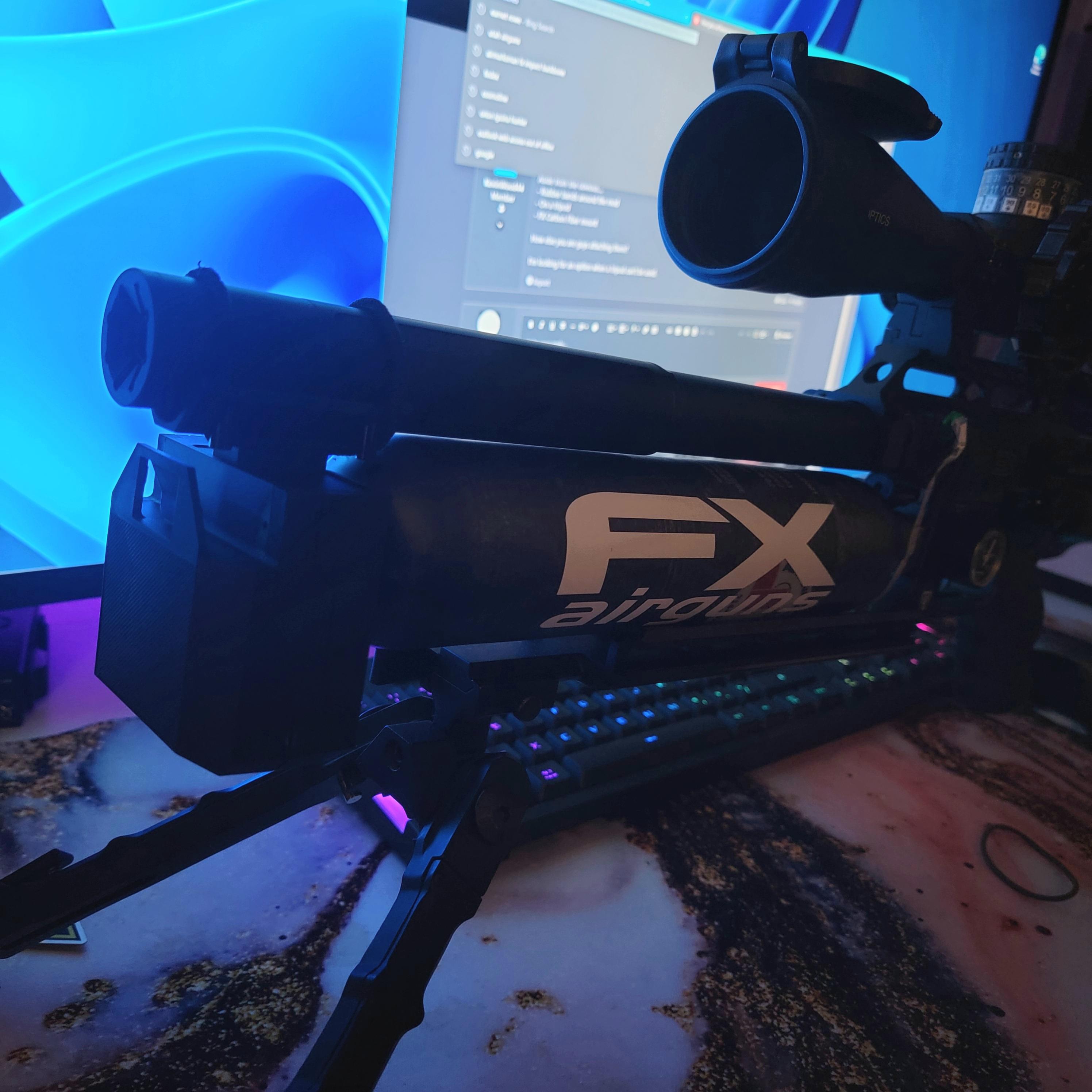

Post pics of how you set up your FX Chrono...

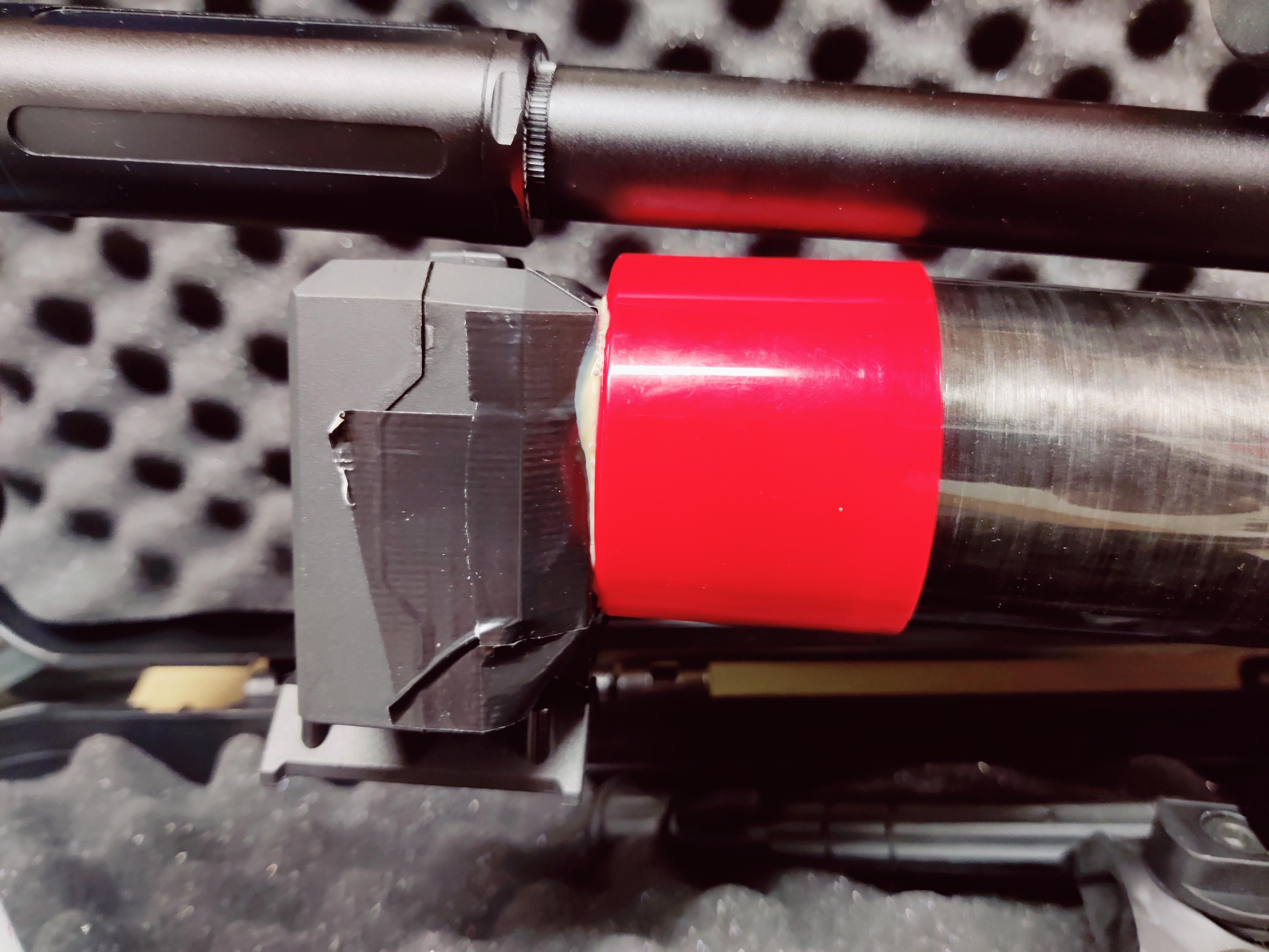

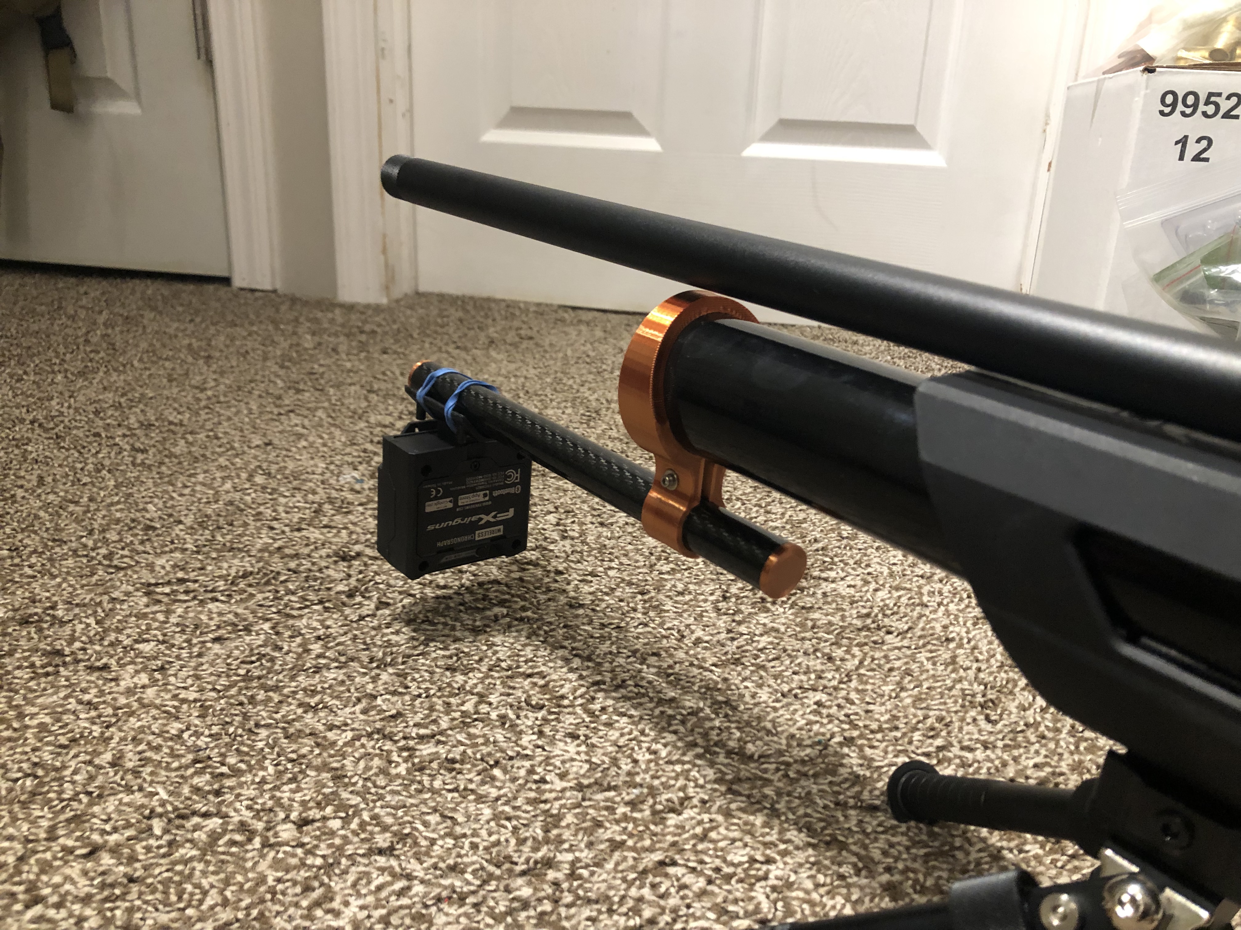

took one of the wifes black hair bands

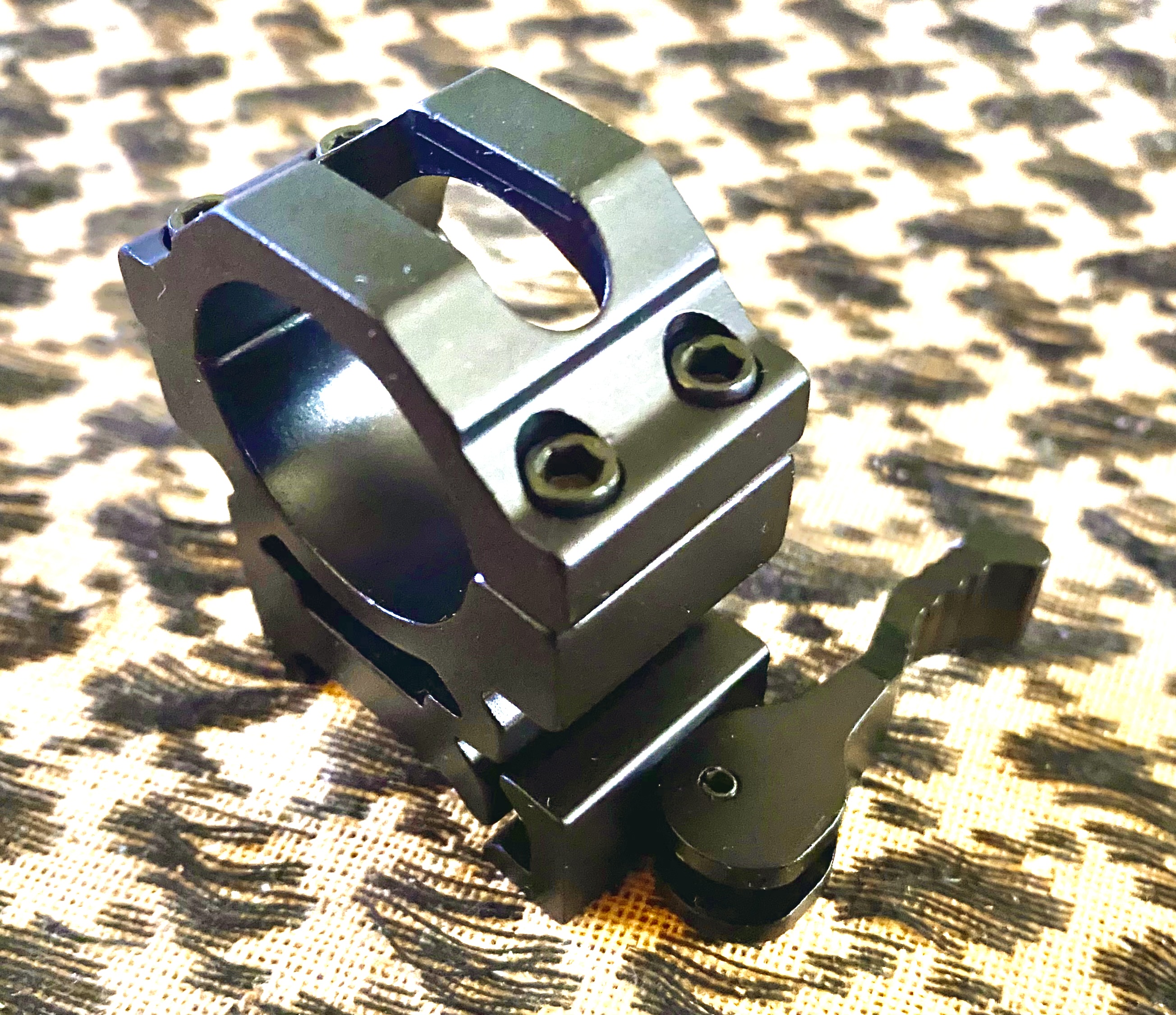

heres the best way ive found for attaching the fx chrony.
midwest elite airgun picatinny mount.
im sure other people make them by now,
but thats where i got mine.
best thing ever for the fx chrono IMO!
slides right on the side picatinny rail on my impact,
has a screw to tighten it on the rail,
but i took mine out and its just a friction fit on the rail,
takes 2 seconds to pull it out of the case and put it on the gun ready to go.
Reactions: cavedweller

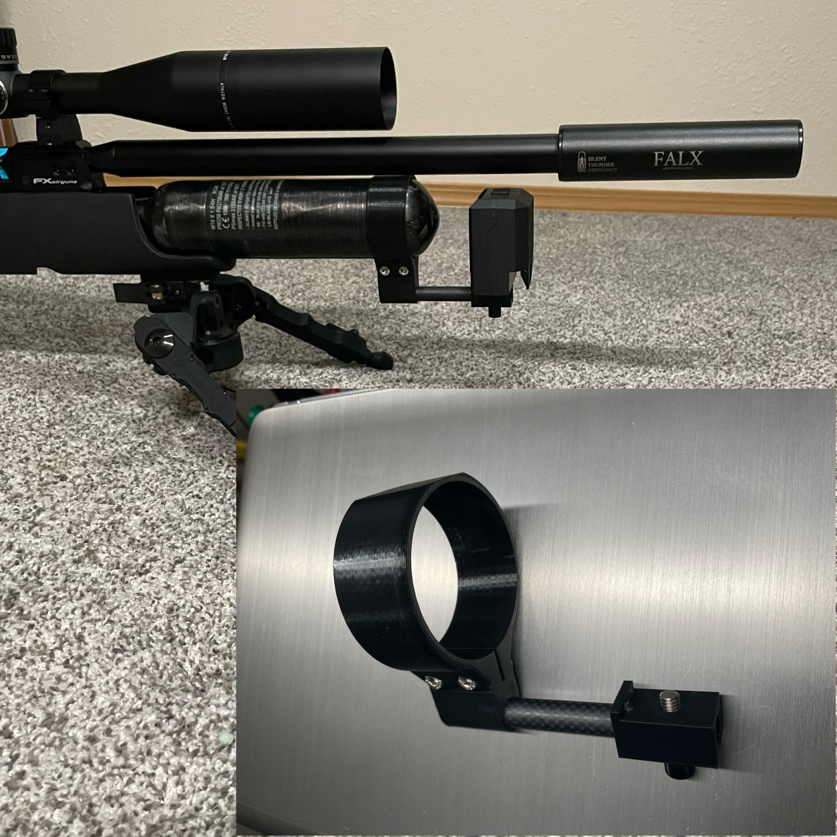

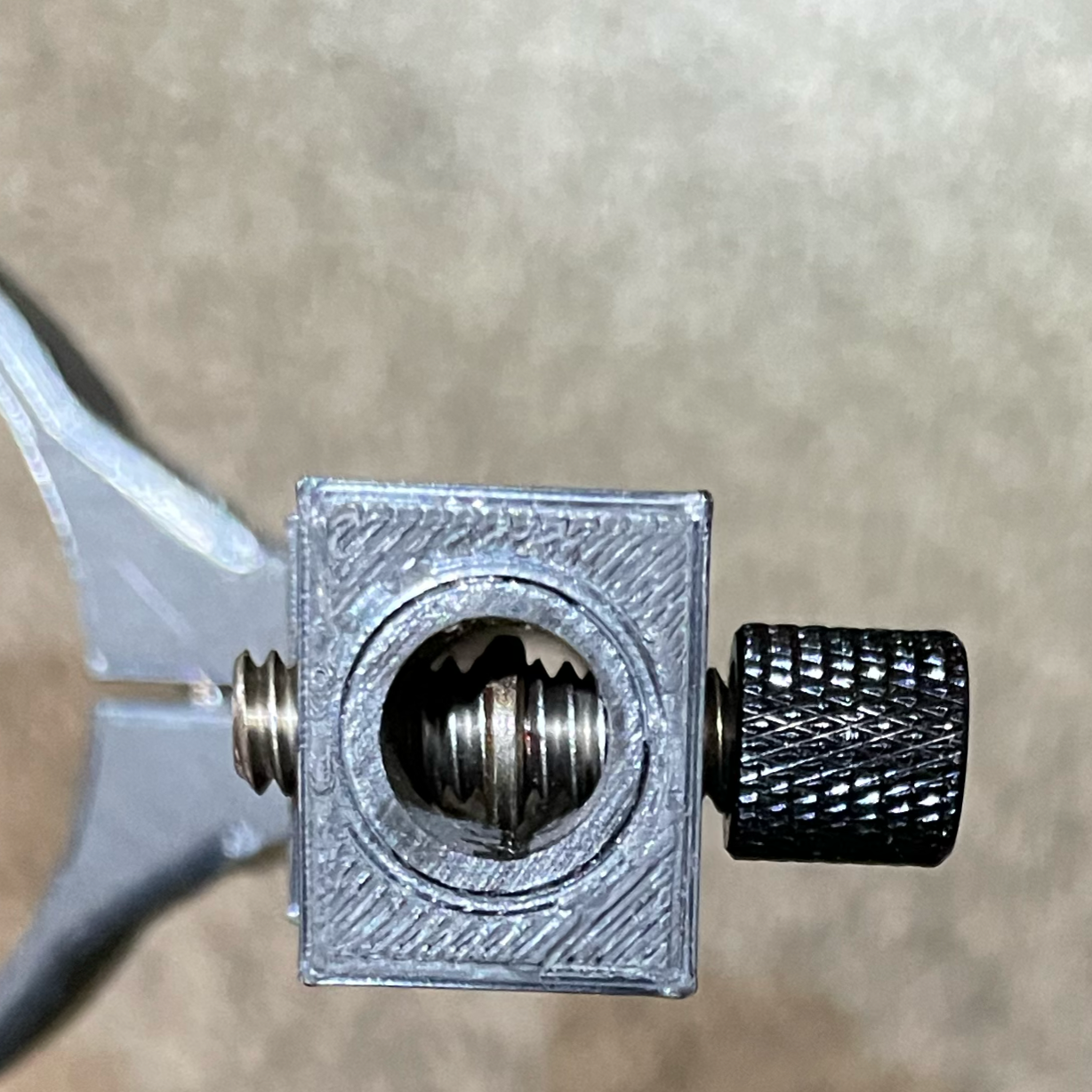

i like that threaded seat for it. car to share the file?

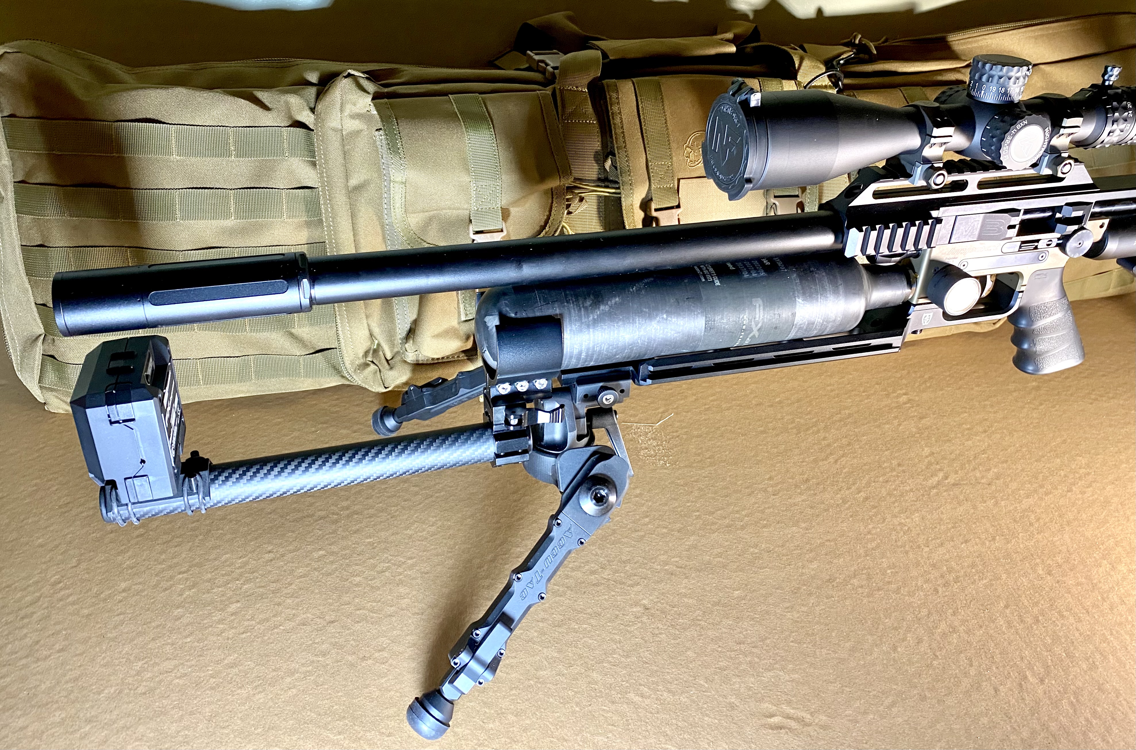

The carbon tube was from some extra .25 fx liner sleeve I had.

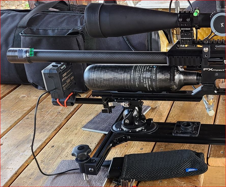

The set-up is a cheap, clamp-style 1” scope ring, mounted to the Picatinny section of the Saber Tactical Arca rail. The carbon tube is 26mm with end caps.
