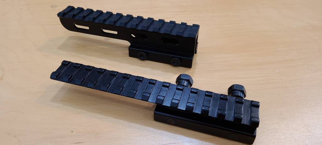

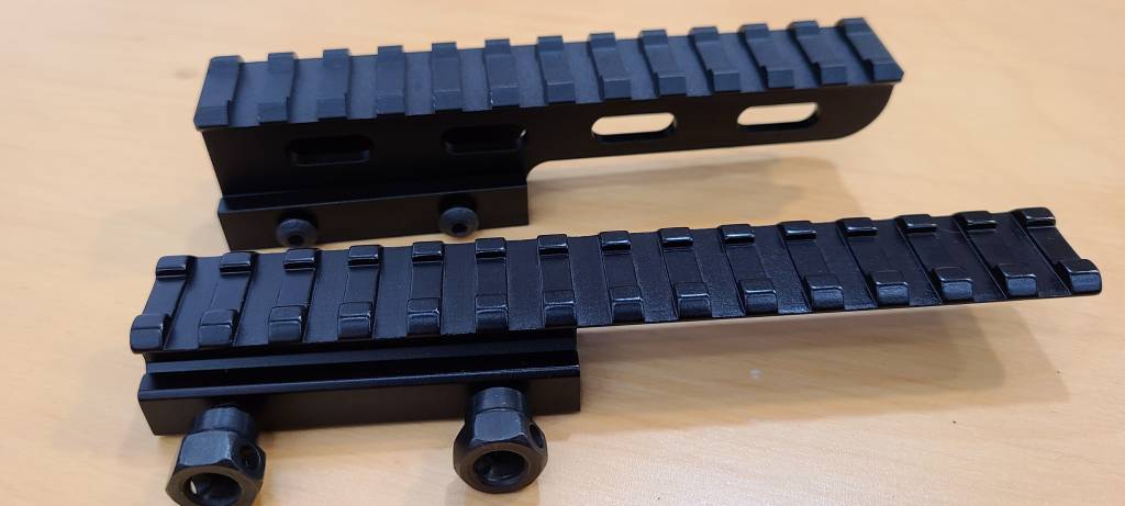

I got the sight mounted as far back as possible by heating the release lever and flattening the top portion where it was coming in contact with the scope mount. That gained me about 1/2” further back. I find it more comfortable with this extended tube with the LOP at about 15” . I’ll need to do some unrested shooting with it just to be sure. I’m sure it’s going to be staying in this configuration.
A 15” LOP isn’t too bad at all, given that you seem to have solved the eye relief issue. I’m definitely going down this road!
