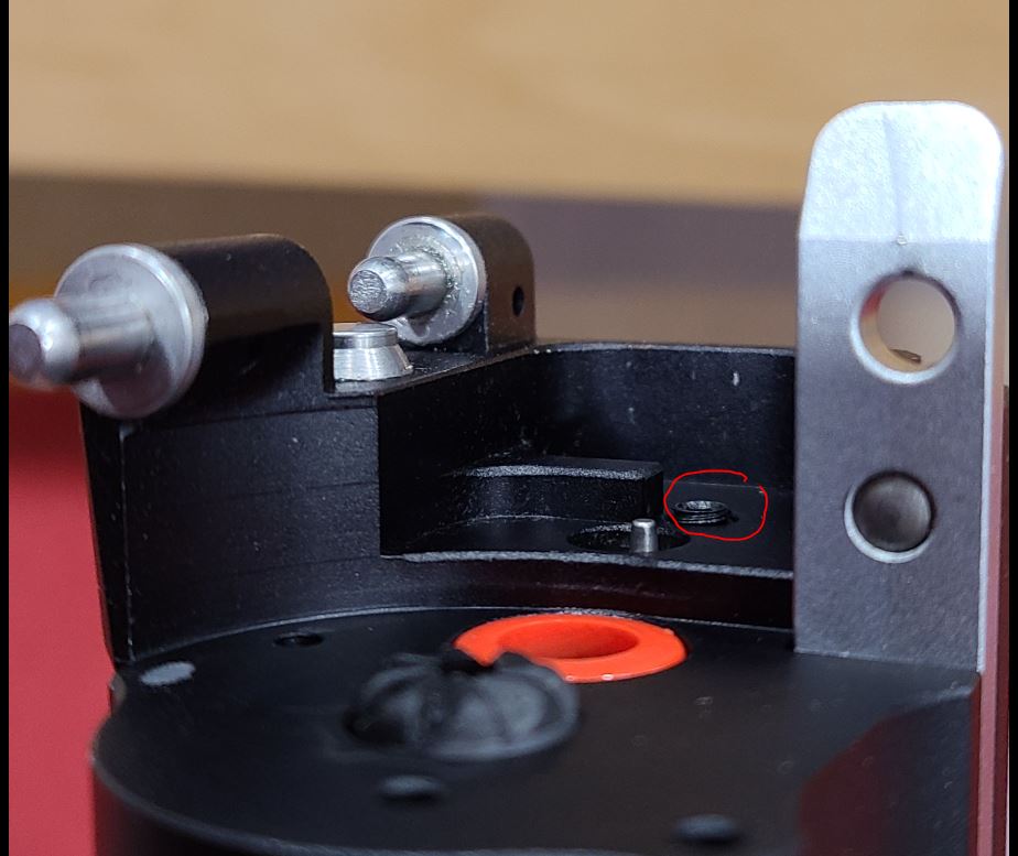

I just broke my setup intentionally.........I was playing with that "valve adjustment"screw / from my perspective that screw is only a trigger length adjusting screw, but anyway.
So I played with that screw blank plinking and I made the (blank) shots really quiet down, but now I have no idea what pellet speed will be - I ended up with.
What is your optimum dimension let say from the bottom of the pocket or from tip of the valve - to the top face on that screw?
The installed jets are probably some random sizes, that is common with a factory boxed L2. I measured mine when arrived with small micro drillbits. Nothing is wrong with that, after a year of shooting several combination of jets and many 1K shots I got back to a same ballpark again = that is called a learning curve with jets.
