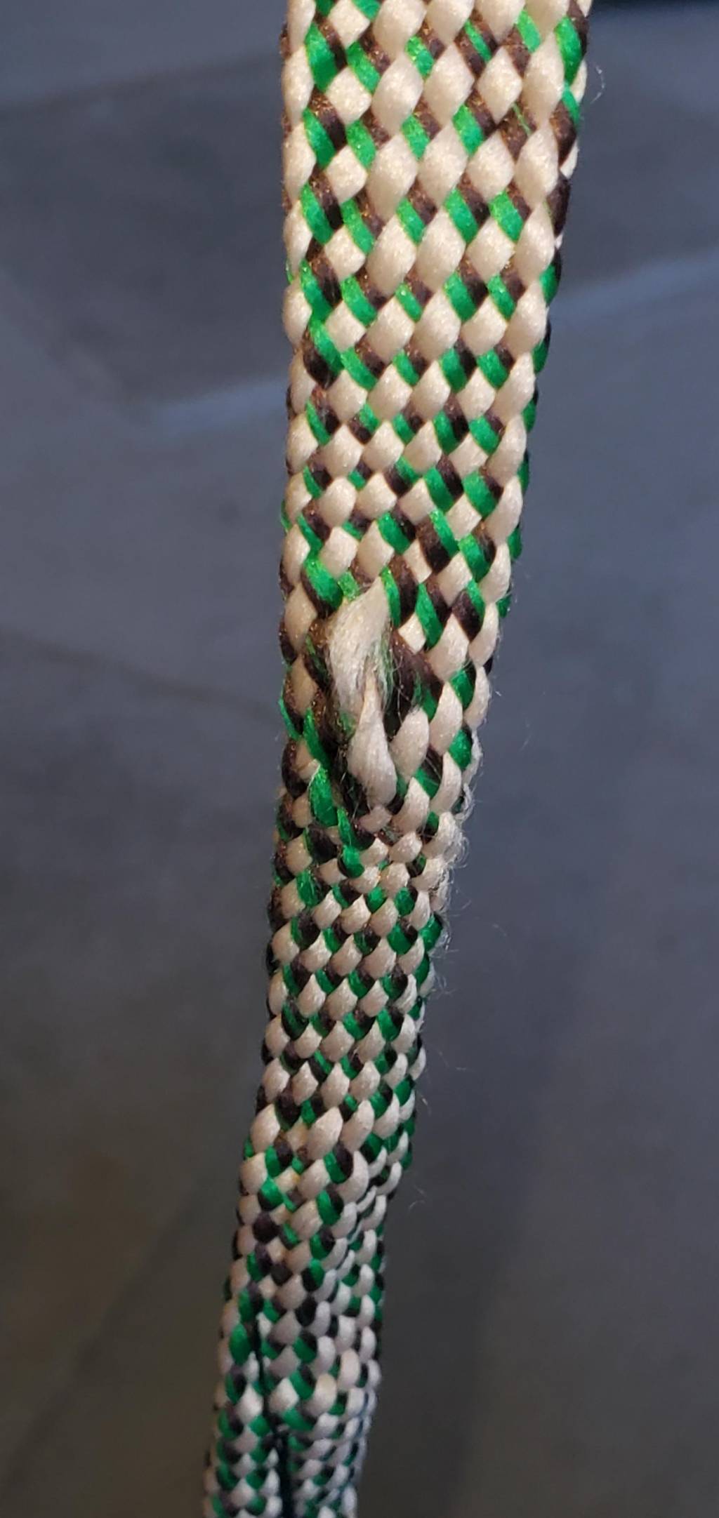

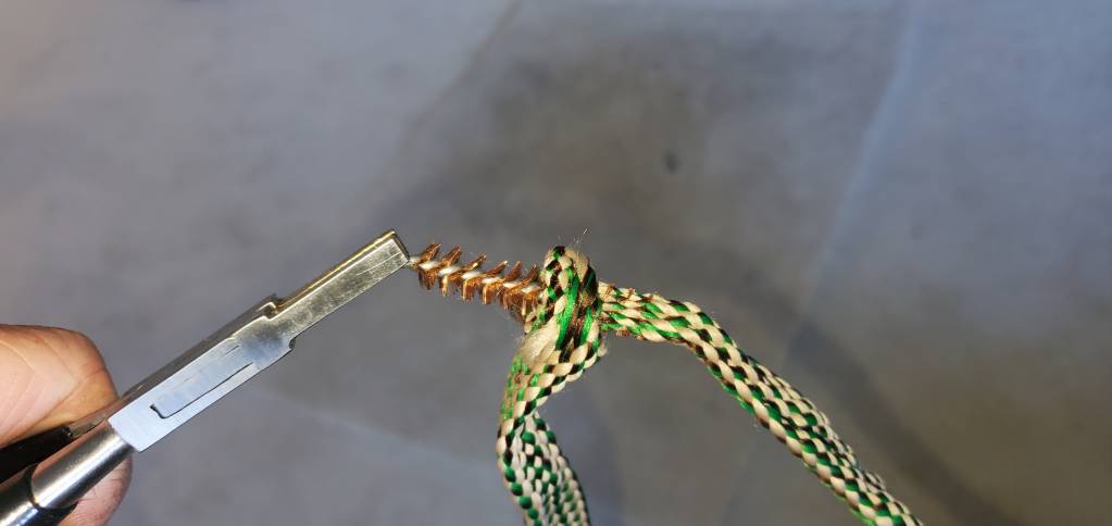

I just pick a spot in the weave near the bristles and push the weaving aside to get a set of pliers on the stem of the brush and start pulling the weavingdown and inside out as i pull the brush out...
Brush out...

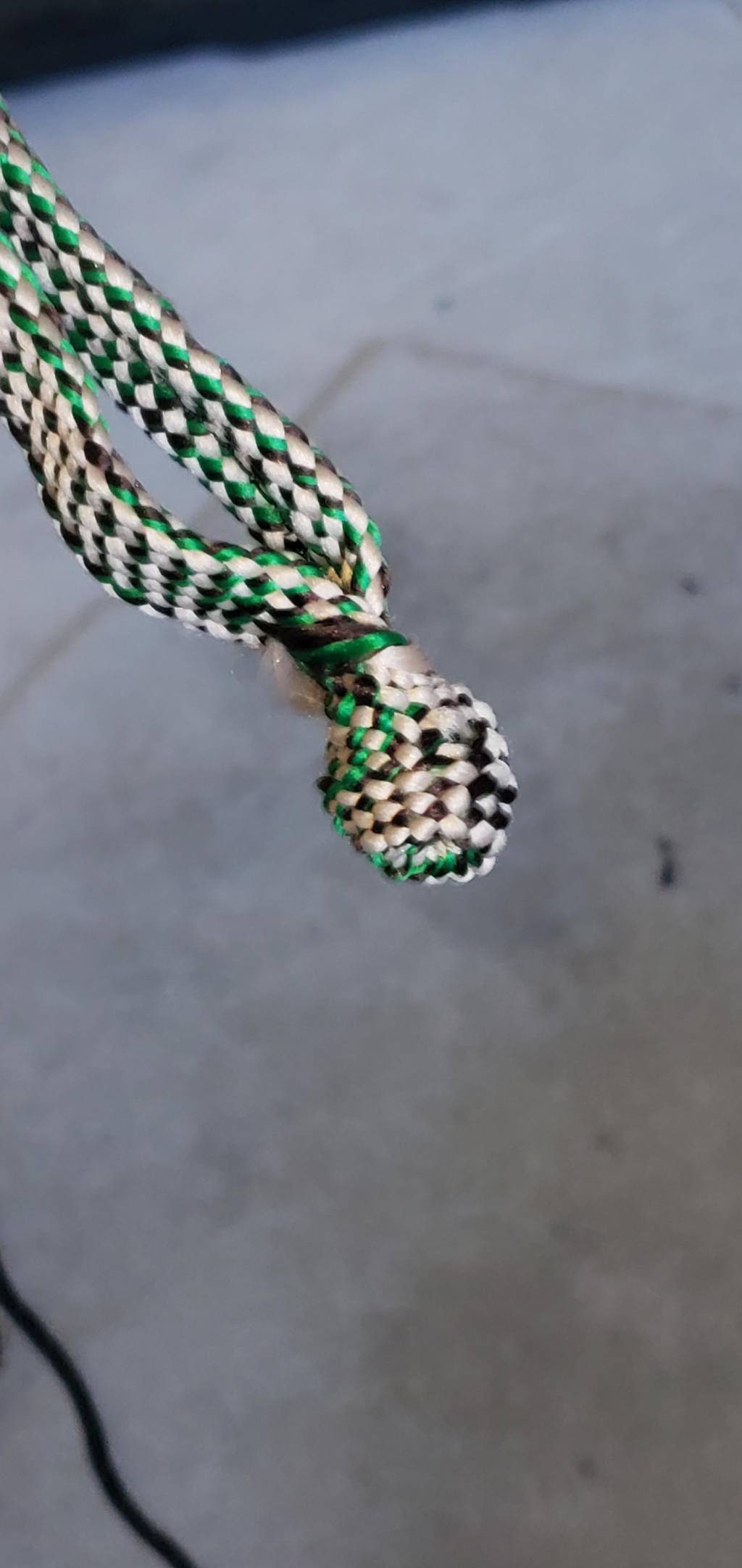

And

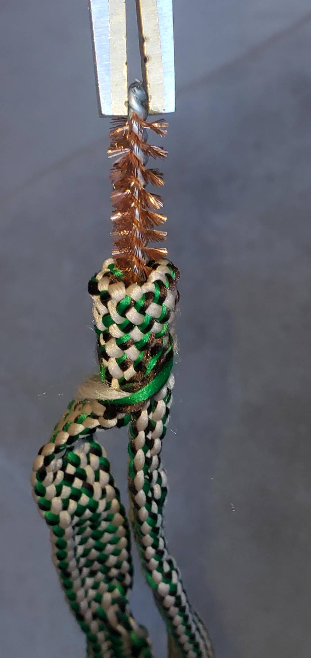

It just looks like a sock partially inside out..
Then just pull the ends of the bore snake on each side of the part inside out and ..
It's normal again!
Probably could have put a nylon brush in place of the brass but this still works great!
