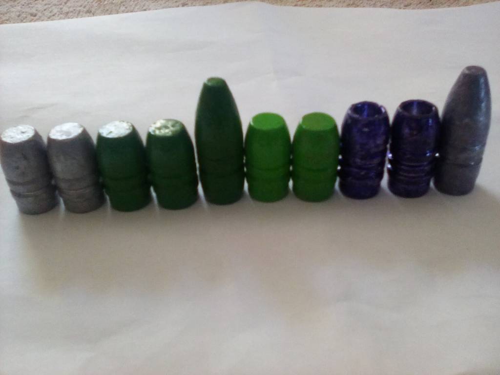

Eastwood Hotcoat Mirror Red polyester - works great, flows out to perfection and easy to get good coverage before the oven.
Eastwood Hotcoat Bright Yellow TGIC poly - not good, very splotchy every time I have tried it (not giving up yet)
Eastwood Hotcoat Lime Green TGIC poly - works very well when ammo is clean and heated to a warm temperature before shaking
Elvis ammo YouTube channel has a nice video with a list of 1-10 the best powders for the shake and bake method. Watch Columbia powders clearance for good deals. I bought some industrial ag green powder coat on eBay cheap $12 a pound or 5 pounds for 50 dollars and it is excellent. I have had great success with Columbia silver that I bought on clearance. I found 0 difference in 20 a pound powder coat and the commercial ag powder coat I bought on eBay. Silver and At green give the best overall coating. I have a Columbia coatings bright green doesn't cover nearly as good as lime green. My favorite maybe Columbia coatings illusion Hawaiian blue with Columbia silver it the last slug. Hope this helps someone a lil.

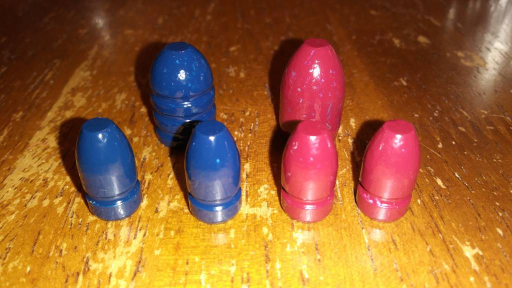

The Eastwood Cadillac Blue works really well, flows out really nice covering thin spots. The Eastwood Maroon is only OK, doesn't flow out great, slightly lumpy, doesn't stick as well on things that have not been cleaned. The 50 were not cleaned, but the 357 were cleaned in alcohol. Both colors of course worked better after cleaning the ammo, but the blue worked better over all. Both are TGIC polyester. The maroon is in the same as the lime green I have used before where it can be a bit lumpy. Both of these went on pretty thick, gained 0.003 inch from the coating so definitely needed to be sized again after.
