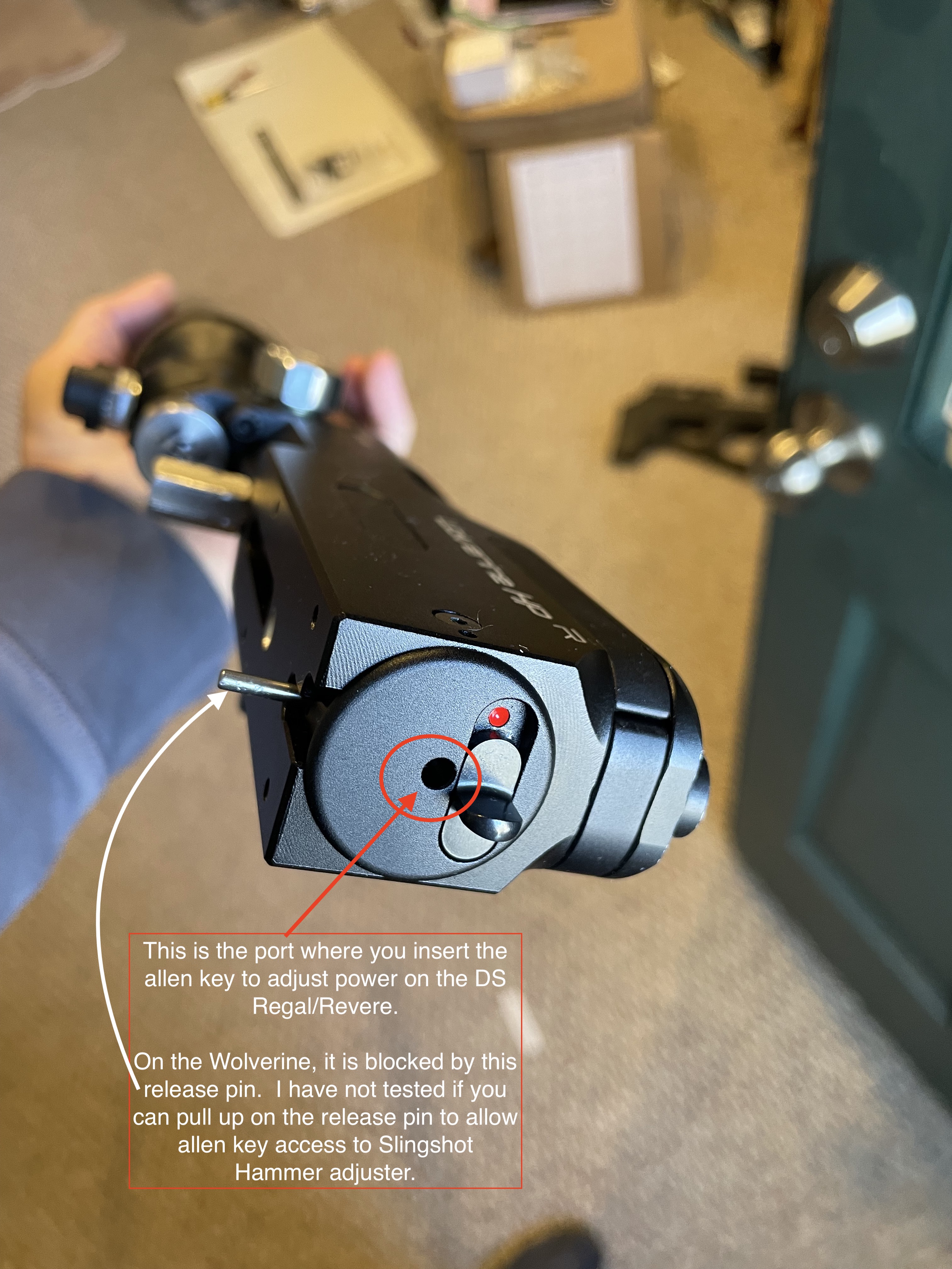

Hi Daystate Tuners,
I'm looking to adjust the Length of Hammer Throw on a Daystate Wolverine R...
Huntsmen Regal/Revere:
This excellent Sub12 YouTube video shows how length of hammer throw is adjusted on a Huntsman. I believe that all Daystate slingshot hammers allow this same adjustment, but it may require more disassembly and be more inconvenient on a Wolverine:
Wolverine R:

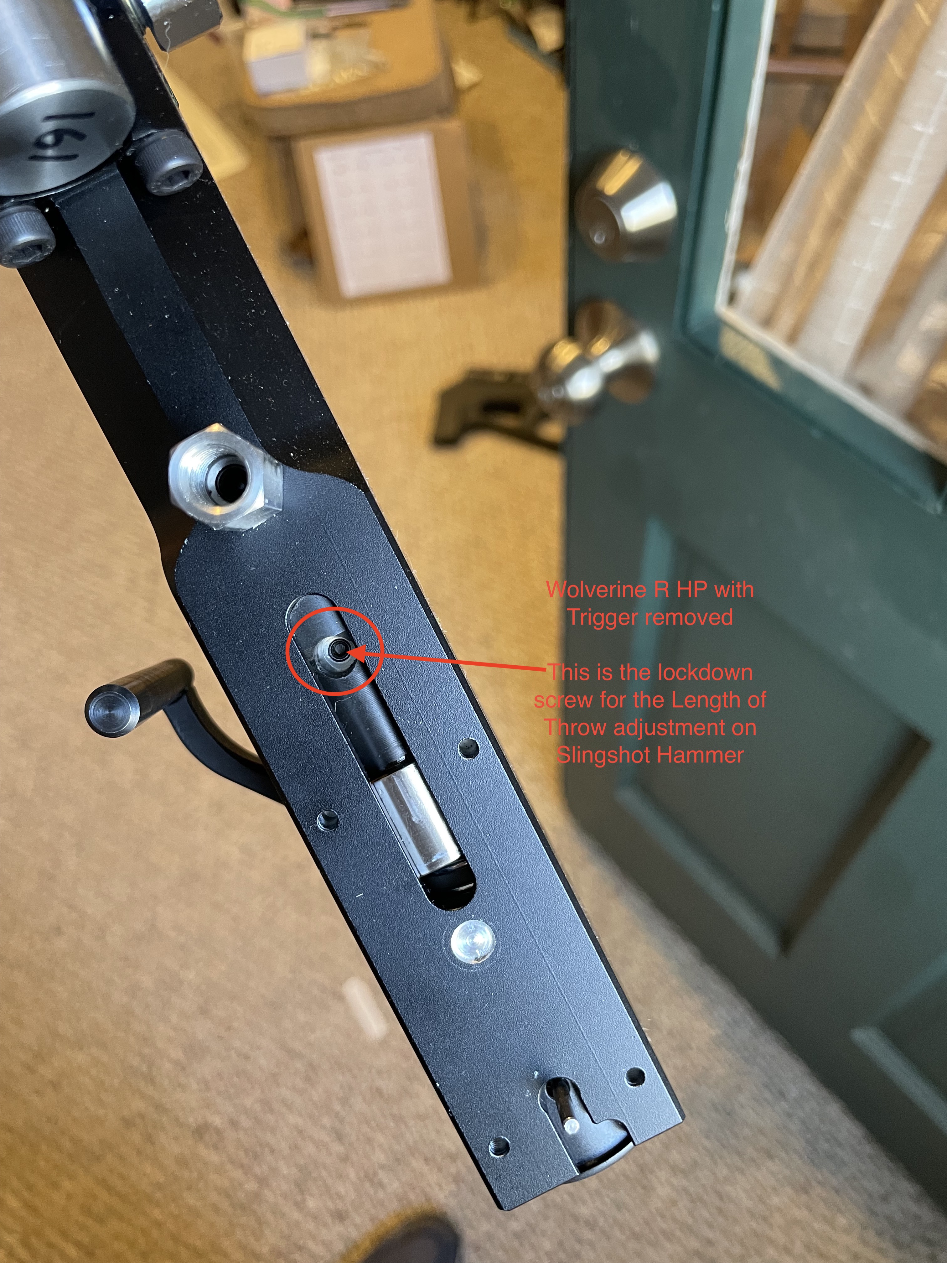

On Wolverine R, it appears that you can’t do the iterative adjustment process that you can on the Huntsmen – because you had to remove the Wolverine R trigger to gain access to the locking grub screw on the slingshot hammer. Also, as per my photo, the rear port appears blocked. You may be able to pull up on the rear cap release pin (it won’t release the rear cap as the grub screws are still in place) to allow the allen key to be inserted, but I have not tried that yet.
Finally, because you have to remove the Wolverine R’s trigger to gain access to the locking grub screw on the hammer, I’m not sure what will happen if you try to cock the rifle without the trigger installed (probably will not cock as no pressure on trigger sear). In any case, without the trigger installed you can't do the iterative "shoot, view chrono, adjust, view chrono) type of power adjustment process like you can with the Huntsman... or can you...?
Does anyone have any experience adjusting the SS hammer length of throw on a Wolverine R? If, yes, were you able to do it with the trigger installed - or do you have to disassemble and remove the rear cap to access the SS hammer adjustment (allen key into rear of hammer)?
Thanks,
-Ed
