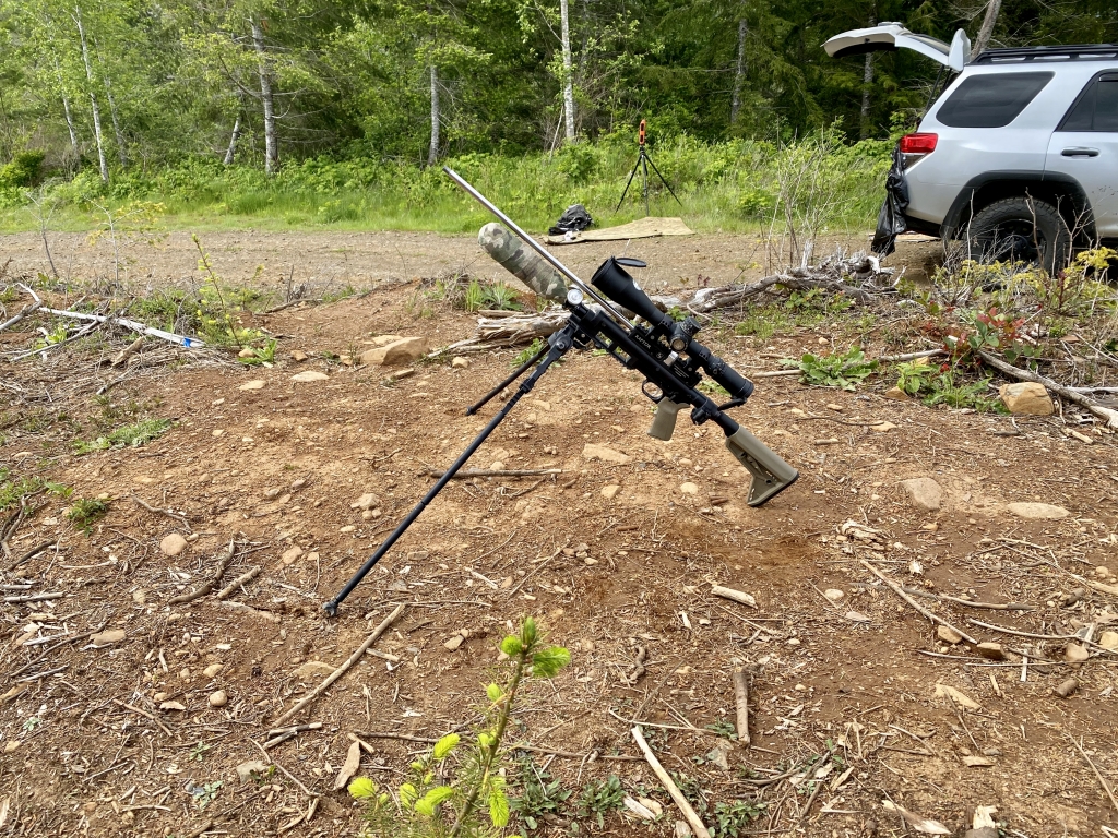

Hi mtnGhost and thanks for the comment. I have also considered such options and have now focused on Vanguard Equalizer 2 QS /
https://www.vanguardworld.com/products/equalizer-2qs /. This biped was shown to me by a friend who saw it with Marno from AirGunnerSA on YouTube. My friend bought it from here (Bulgaria) and I expect impressions from him because unlike me (I only shoot from the table at the moment) he does pest control.

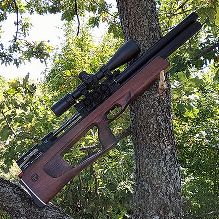

I have also tried to shoot from a natural support (wood, large stone, etc.) but the wooden stock is very "sensitive"
. I have no experience with another rifle with a wooden stock because my Hatsan is polymer but I am definitely not very fascinated by it - only for two test shots and I managed to inflict small damages which even with several types of wood felt-tip pens I can't hide and that's why honestly for now I avoid doing so ... Now I have ordered from AliExpress some plastic protectors for the bus (for biped) and through them I may be able to shoot calmly.

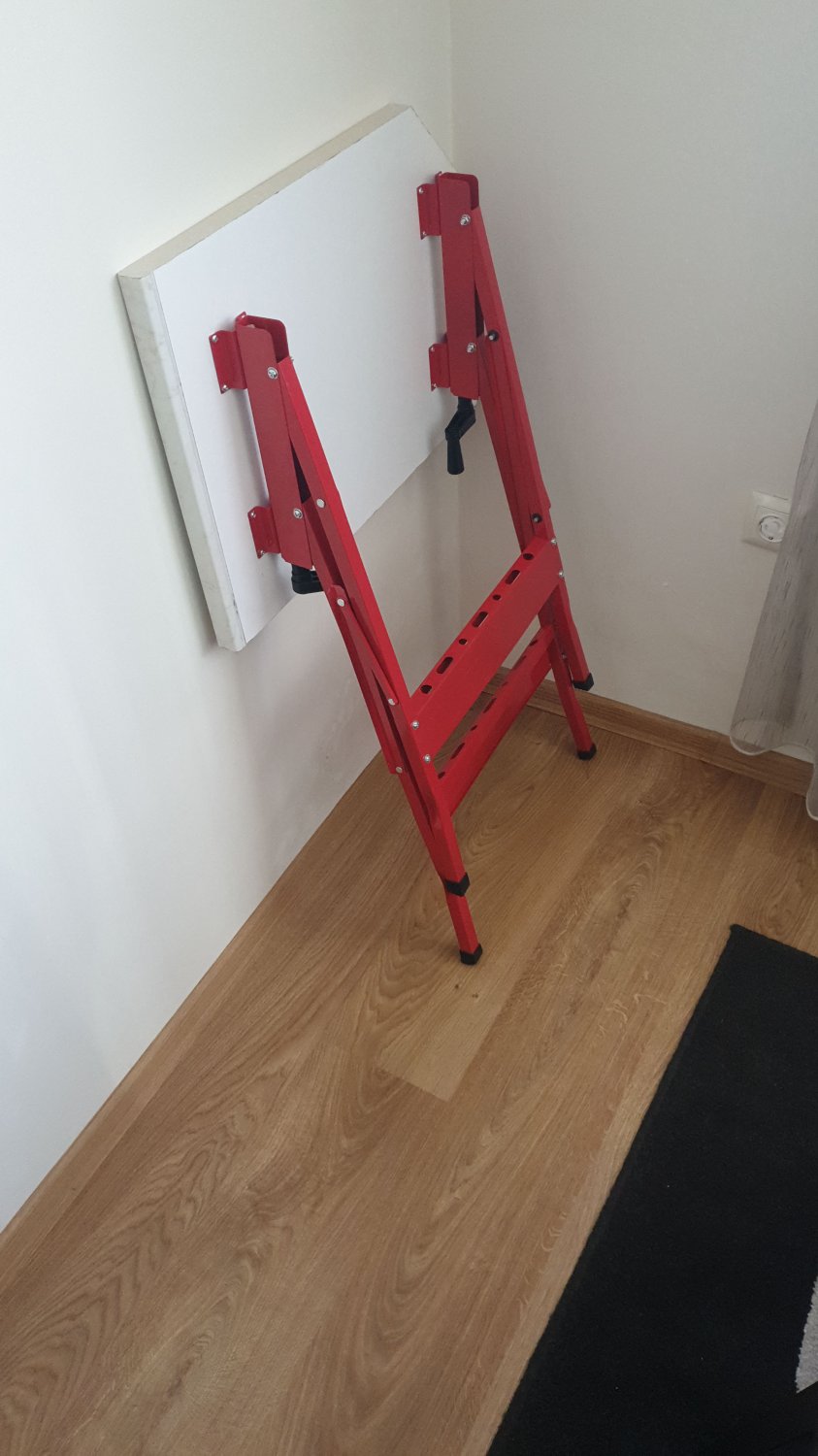

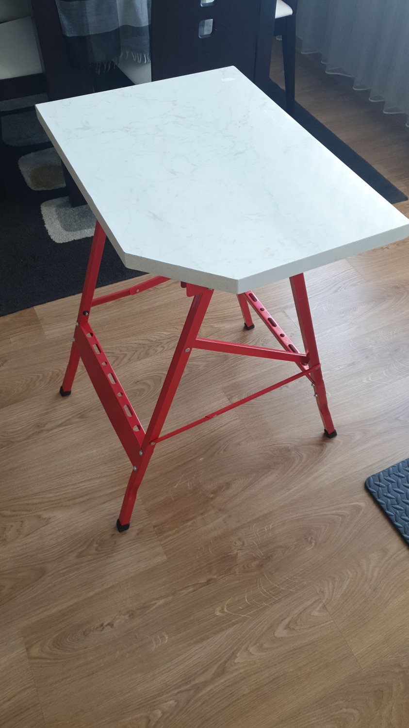

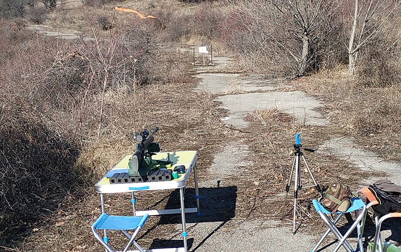

Of course, shooting from a table will be much better accuracy, but the table itself is also important ?! In the videos on YouTube I see various tables - prefabricated, but when I look on eBay or Amazon I see that people are not happy sometimes even at all, so I ask if anyone here is happy with a factory-made table?
