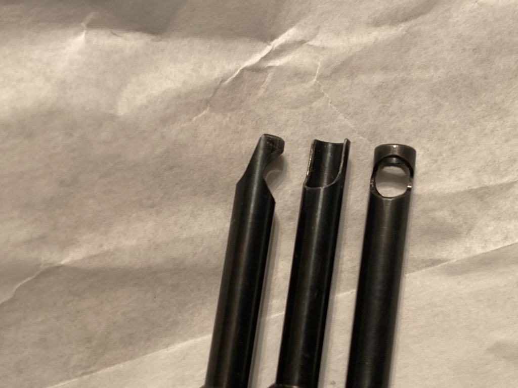

I think I will use this modification.
It says that it's fine and it's simple.
or what other do you think to use?
@Libellule1

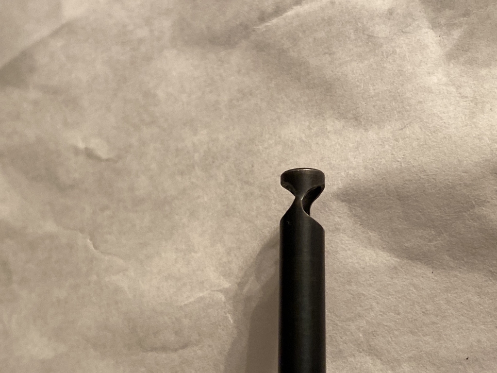

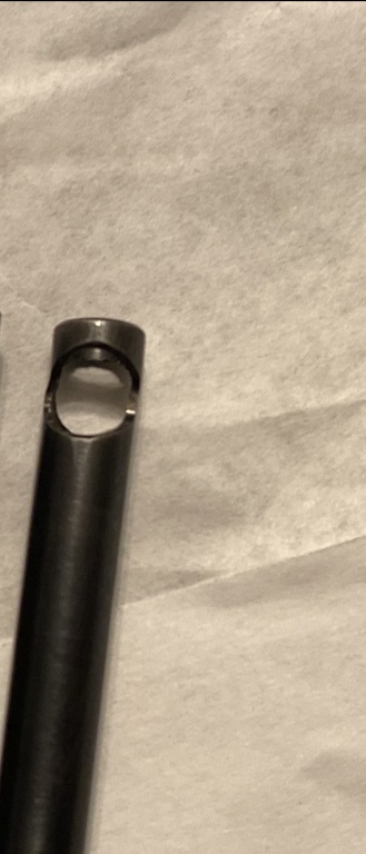

I would advise against that one. I've modified 20 or so probes and found that the one that causes the least problems (no problems) is the double ported one on the right:
The other two created strange accuracy problems and velocity was more i consistent. Max FPS is the same with the double porting.
I made one last fall with a pin design which gave me 10-15fps more, but I had seating depth and loading problems.

Could you send me more photos about the one you recommend? well if you have, sideways and closer please, it would be a great help since you already tried them, you would save us a lot of time

I thank you for the information. I too, in my great ignorance, would have done that of the photo of @mtnghost. Yes, if you have some photos from a different angle, it would be a welcome source of inspiration. So is this ??? And for the brass TP, it is better, in your experience, that of the Huma, or the "home made" one. ??
This is all that is needed to achieve the same efficiency...

That is the side profile, it's identical on the left and right side. I posted the top view earlier (the one on the right side in the photo of the three probes).
