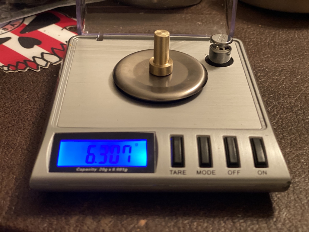

This brass is much heavier than 360.. I made a short weight for another member this evening, 6.3 grams 💪
