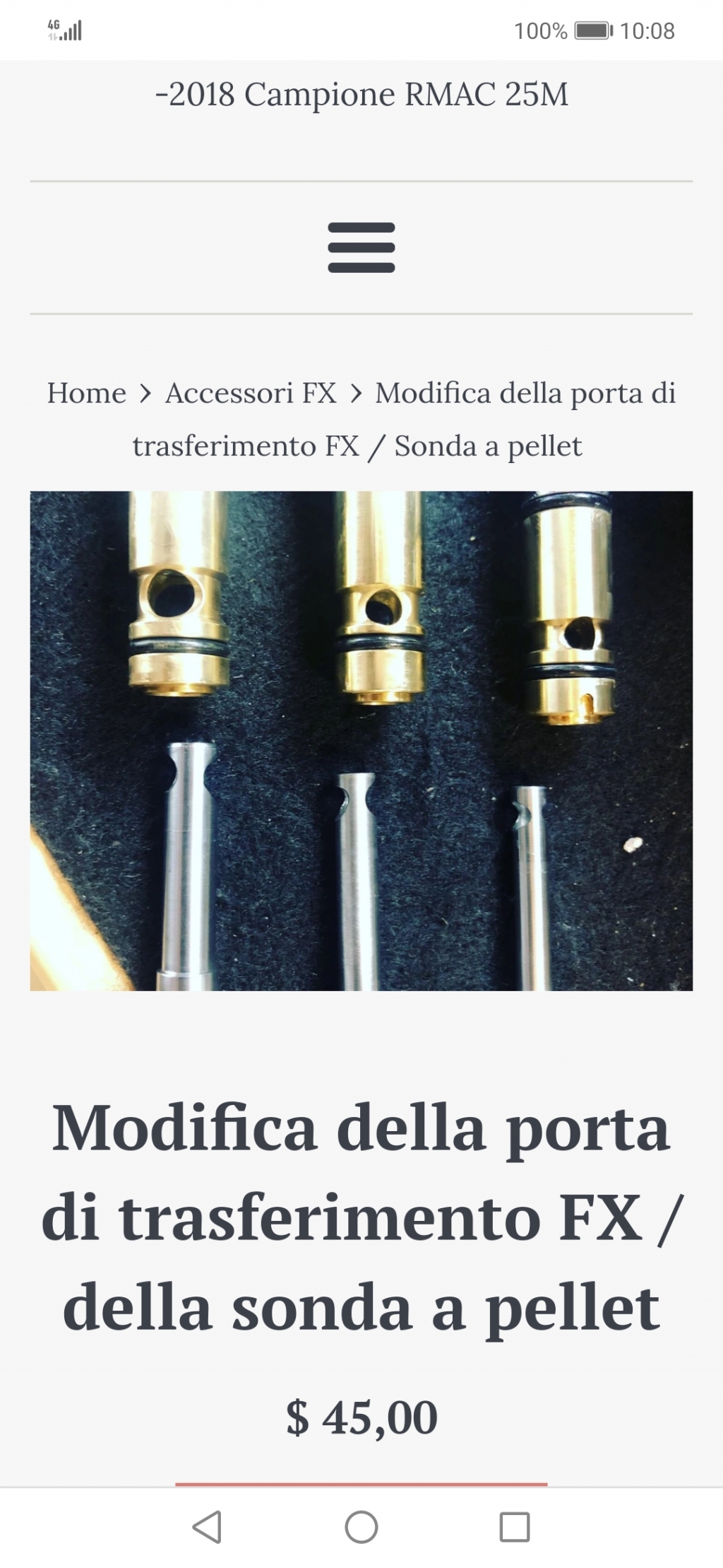

I have seen that in this USA online shop they make the modification to the brass TP in this way ... They enlarge the original hole, making it flared at the sides, and they also make a hole on the other side, as in the pellet pusher. But, in your experience, the modification of the second hole higher than the brass TP will lead to greater advantages ???
