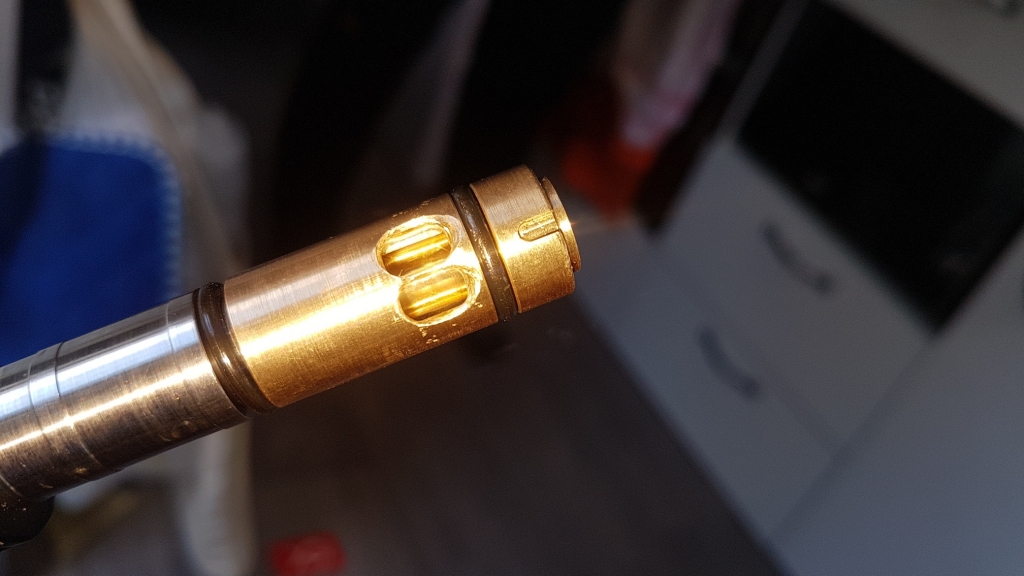

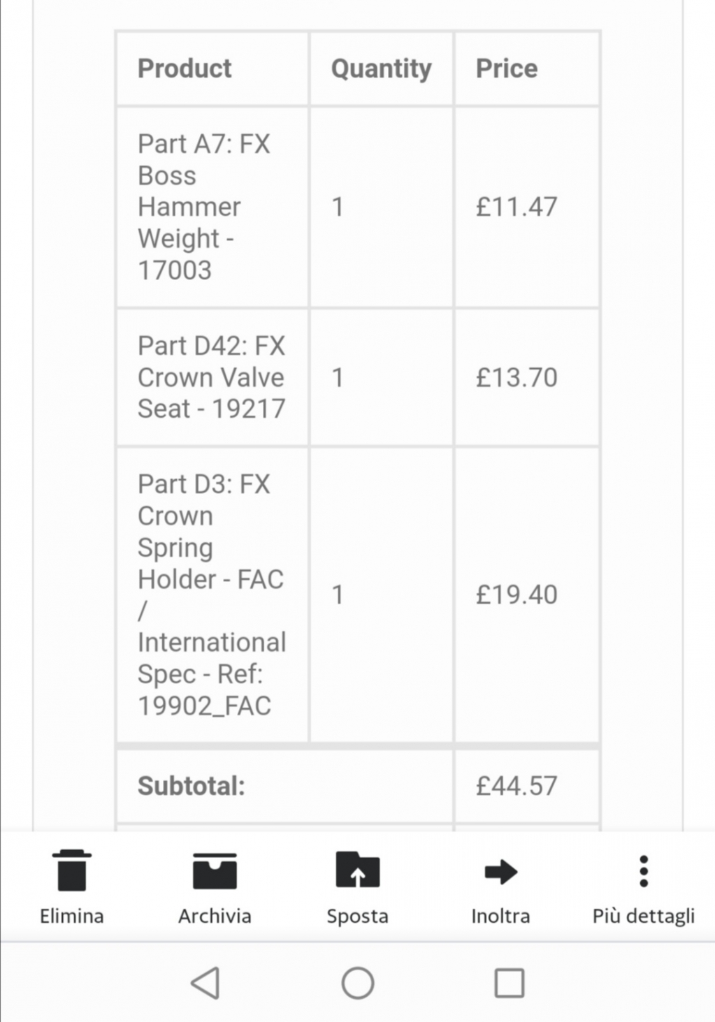

I finally ordered the pieces necessary for the customization of my crown. 25.
- Hammer of the FX boss.
- VS original in steel (I will enlarge the hole makes 5.5 mm to 6.2 / 6.3 mm).
- spring holder (to be modified according to the length of the hammer) .... Pieces ordered by the UK.
From Huma I ordered High flow dual hole transfer.
As soon as the pieces arrive I will get to work and tell you that power and autonomy I will be able to "squeeze" from the crown.
For now, thank you all for your valuable information.

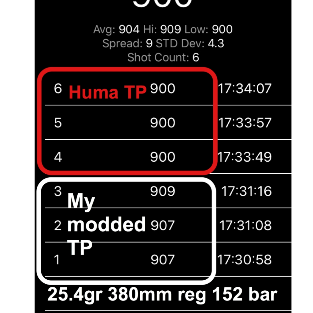

Just wanted to give an update on my testing of the Huma TP.

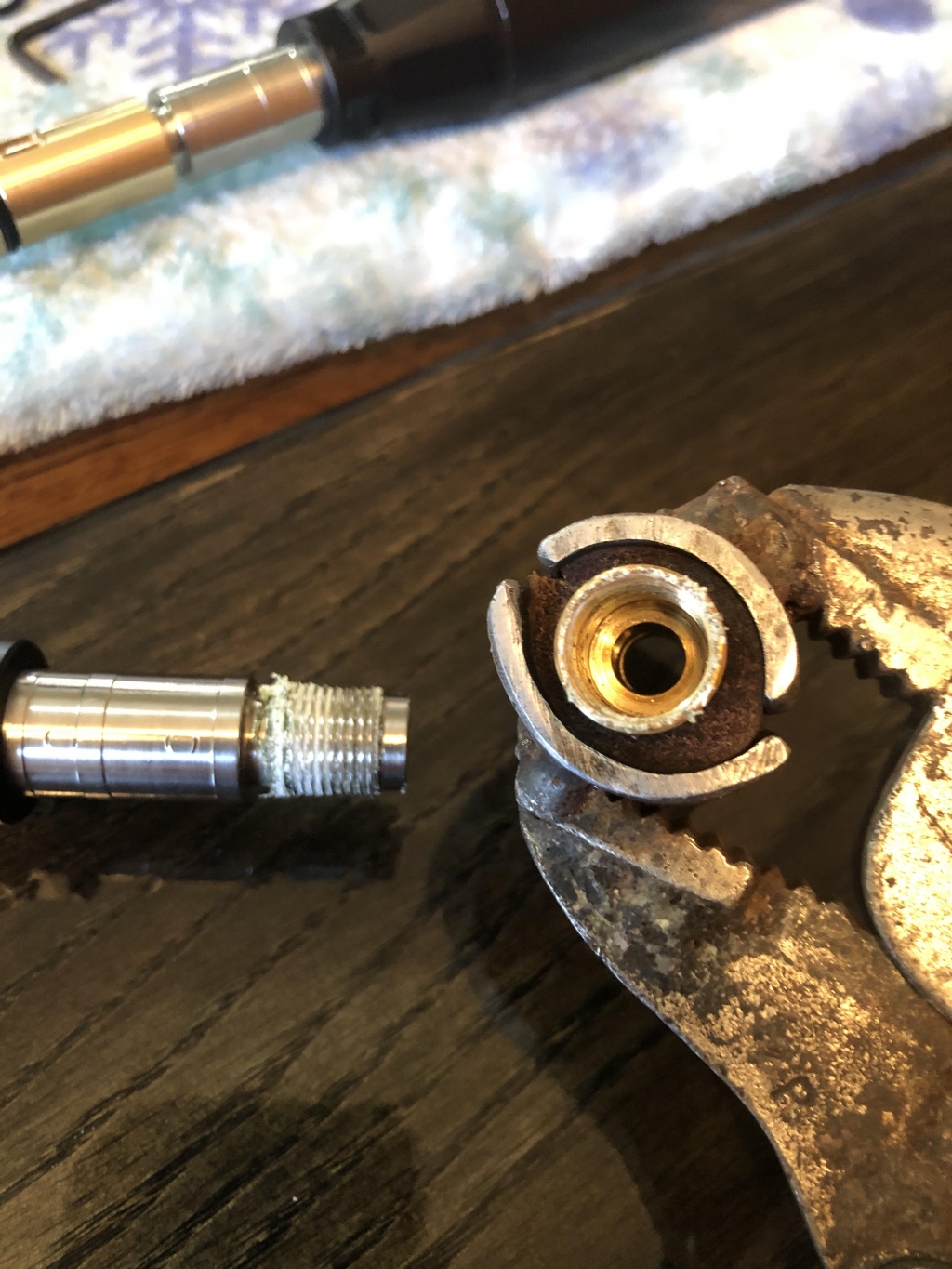

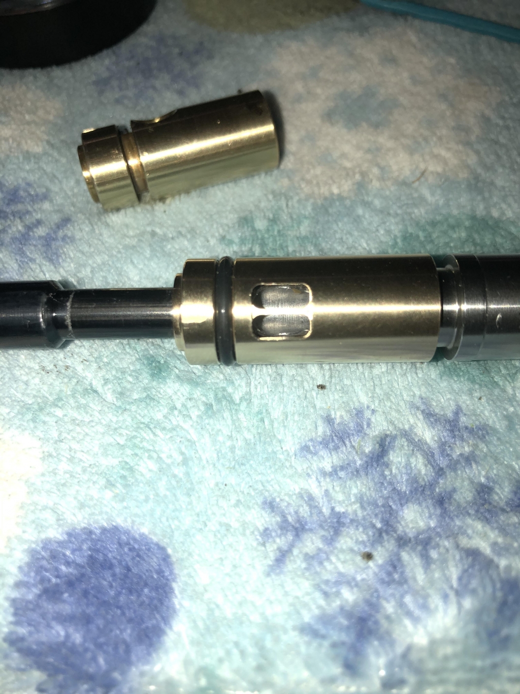

First thing was to get my modded factory ones off. Getting the inner oring out was a little tricky. I didn’t have a dental pick so I made a little custom pick.
I tried to heat the TP with a heat gun but it wasn’t quite hot enough so I gently heated with a propane torch until just a little smoke came off and then a leather wrapped vice grips did the trick. FX used an awful lot of loc tite.

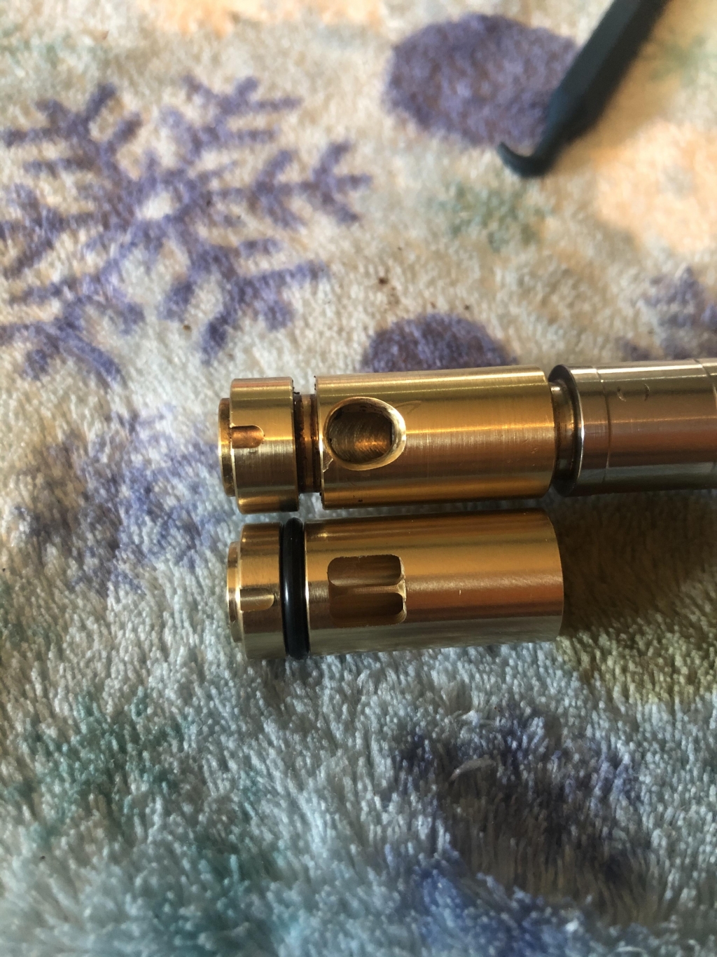

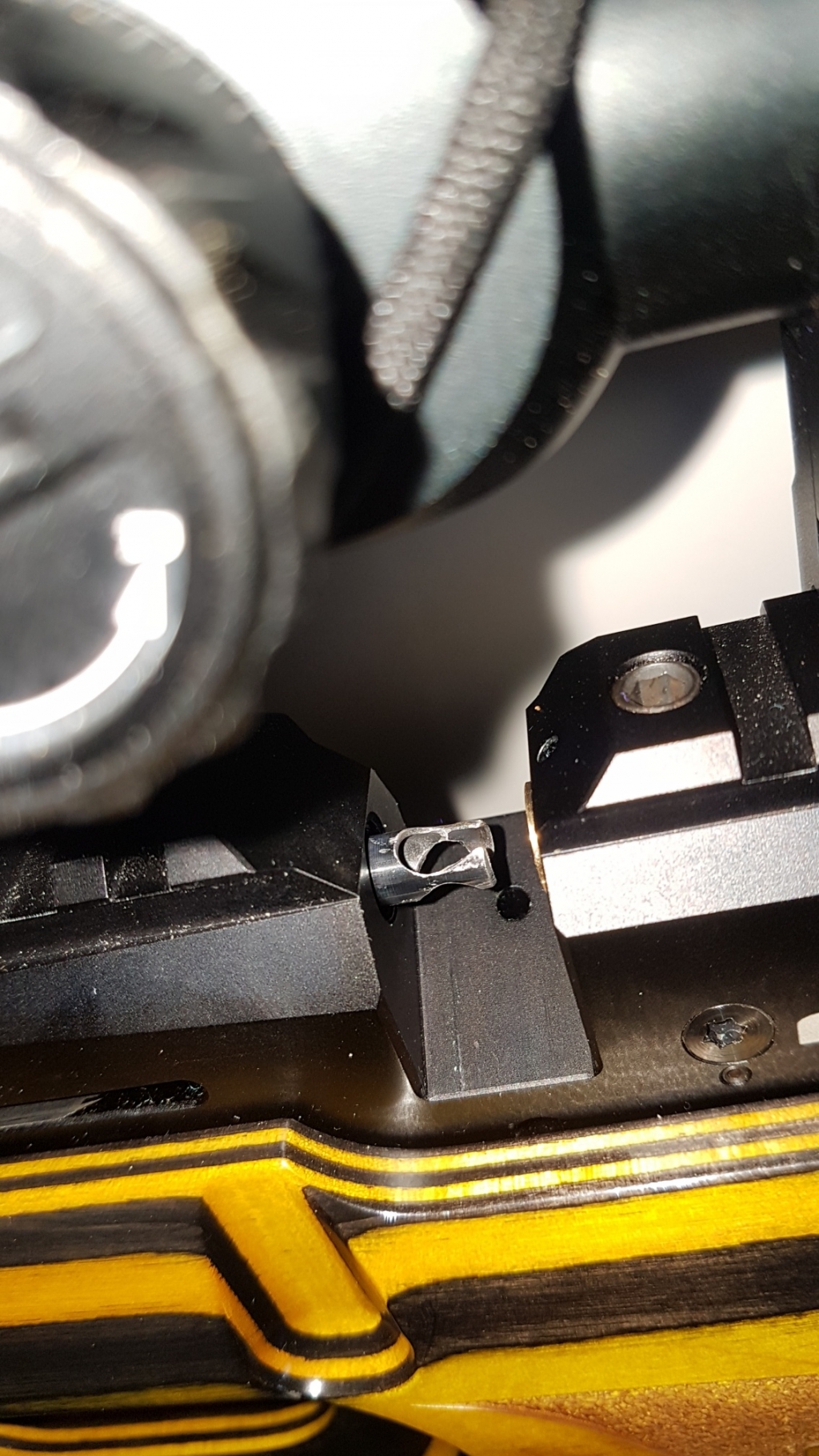

Here’s a pic of my modded probe in the Huma TP. It appears there may be a few fps hiding in the corners, but for most part it appears to line up pretty well. I wish I had a stock probe to check.

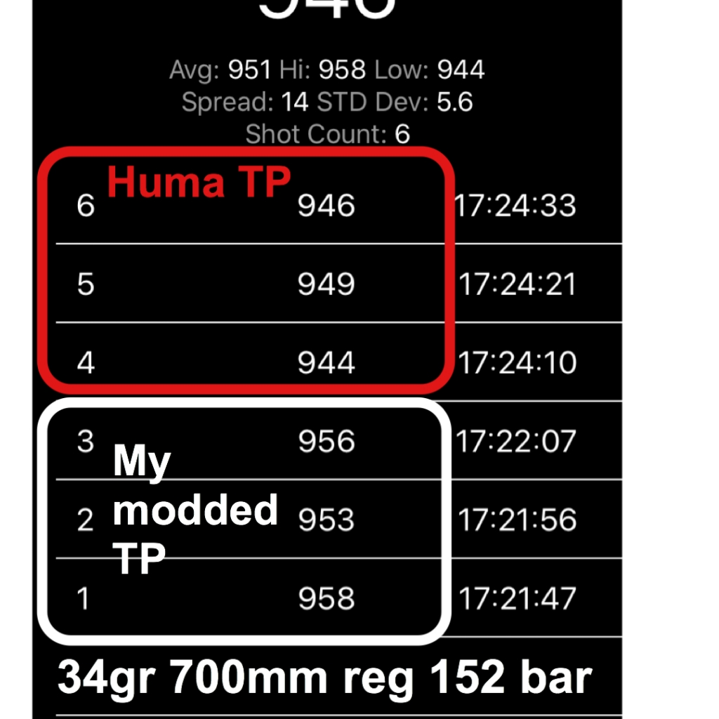

I recently tuned the gun back to full power. With the reg at 152-155 bar I fired up the FX Chrony. Here are the results.
The Huma TP came very close to my modded TP and I think there is room for improvement on the Huma. I did notice that pushing pellets through the Huma felt quite rough. I didn’t check accuracy yet . I may push a few pellets through the TP and see what they look like. It may need a little polishing.
Next up I’ll be installing the larger valve seat. So far I’m pretty impressed with just TP and probe were nearing 70 ft/lbs in 700mm and I can put on the 380mm and dial down to PW3 and stack 25.4’s at 50yds at 865fps.

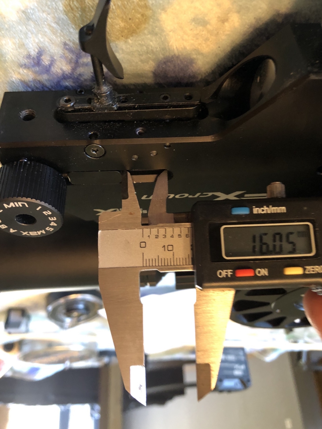

What is the measurement for your adjustment screw? Mine is around 16mm using the weight. I am set at 160 bar and getting 60-65 FPE depending upon the type of ammo I am using. With the 34 grain jsb heavies I am shooting at around 930 fps. It looks like you are actually getting more power out but at a lower reg setting, so I am wondering what I might learn from your settings, to see if I can improve mine.

I also ordered a TP Huma 10 days ago, but it hasn't arrived yet. I read that there are domed problems that don't go well .... I hope it doesn't happen in all their TPs. But to polish the inside of the TP, which product are you going to use? Fine abrasive paste?
I noticed that the mod to the original TP makes 10 fps more than the TP Huma .... as you have suggested, widening or lengthening the double hole by 1 millimeter and flaring it slightly, you could get the same fts.

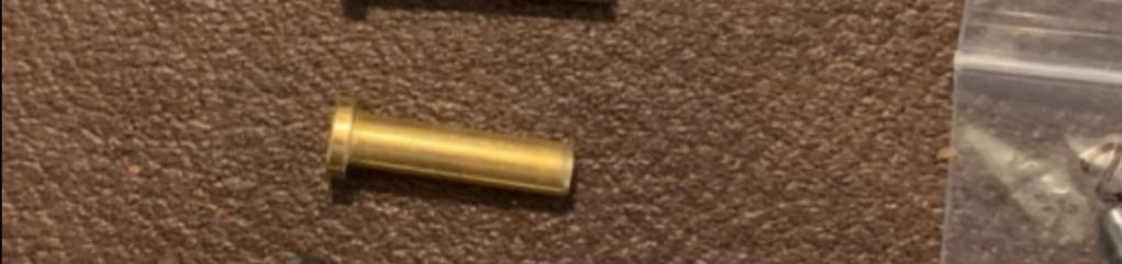

The one in the photo is Ermest Rowe's hammer.
Rowe's brass hammer has a flange at most 3 or 4 mm high, like yours .... I will work my hammer in order to obtain a weight of about 7 gr and a flange not more than 4 mm high. Thanks for the valuable information you gave me.

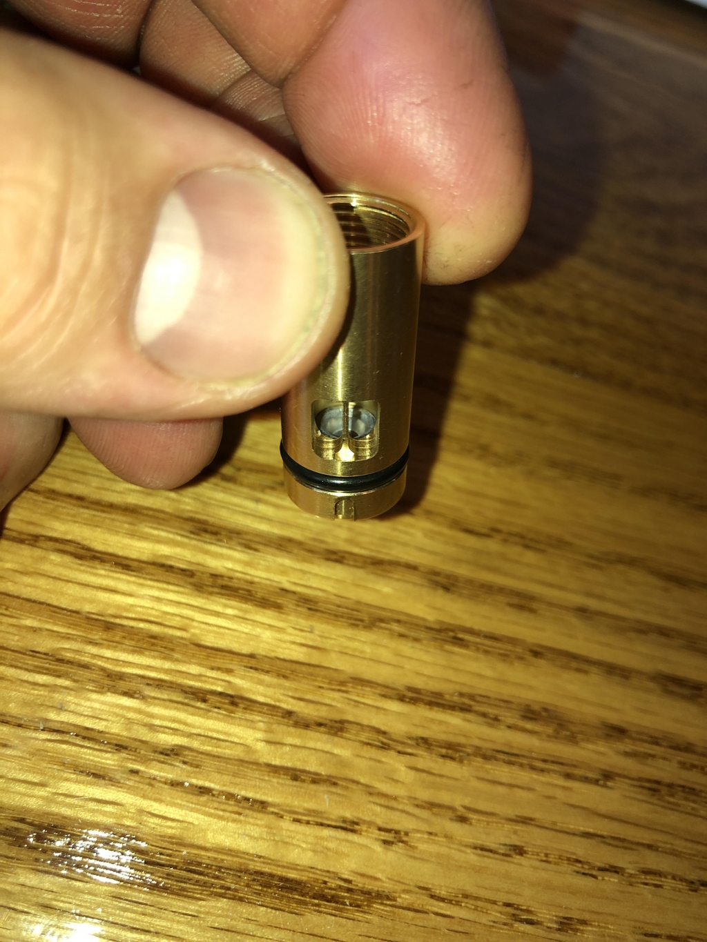

@dani357k - Yes I modified the factory TP’s on my 380 & 700mm barrels. The Huma I tested was completely stock. I followed the instructions from the Impact guys modding them in this thread.
https://www.airgunnation.com/topic/fx-impact-mods-for-more-fpe/

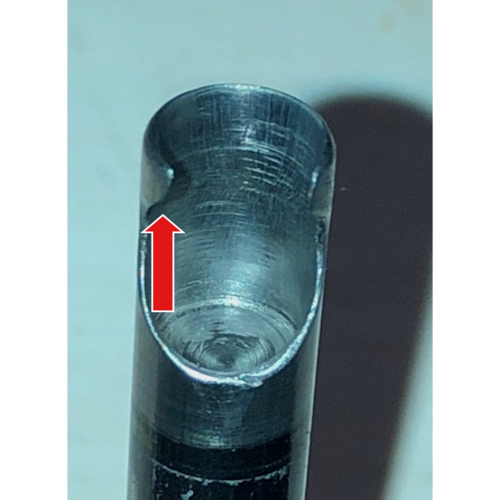

My pellet probe was actually referenced here on page 3. mtnGhost said he had accuracy issues with this design. While I don’t doubt his findings mine has preformed flawlessly and I’ve found no accuracy issues.
I think some people had loading issues if they cut too much off. I left the tabs/ears shown by the arrow. I also did quite a bit of thinning on the inside diameter to create a larger opening for more exposed surface area behind the pellet. My TP’s were slightly elongated and then tapered in on the inside towards the back of the pellet.

I'm not sure how you are measuring your hammer spring screw adjustment but from that number I’m guessing your using the same method as I do. I keep track of my adjustments by measuring like this.

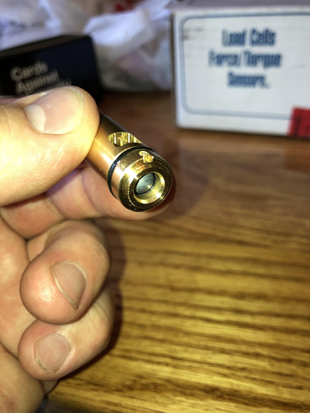

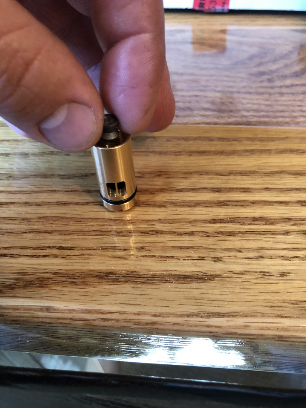

I tested pushing pellets through the Huma TP by hand and I’m happy to report the pellets look just fine. From what I can tell the resistance/roughness I perceive is only from the pellet pushing through the inner oring. I even put a few through from the opposite end and they drop right passed all the porting/machining with no resistance and stop right at the oring with the skirt completely past the porting.
My thoughts are 1. Maybe they use NBR 90 instead of 70 like factory. 2. Just needs some time to break the oring in a little. (I’m comparing the feel to my well worn factory orings.) 3. Maybe there oring groove is not machined quite as deep.
again all just speculating but at least it doesn’t appear to be damaging the pellets. Accuracy testing will have to be done to confirm. I will still probably do some smoothing with the dremel for better flow.

@BSJ Nicely done! I decided to re-work one of my dual port TPs, so I opened it up a bit and rounded out the transitions and I also turned my probe into a double hole but I also took out the ring at the end and just left two vertical walls. Seems it gained me about 5 more FPE. I am now shooting .25 cal 33.95 gr heavies at 960 FPS and 69.5 FPE.
I still have a little bit of grinding to do and I am still waiting for my 6.3 mm valve seat. I am looking forward to seeing what I get when I install that!
