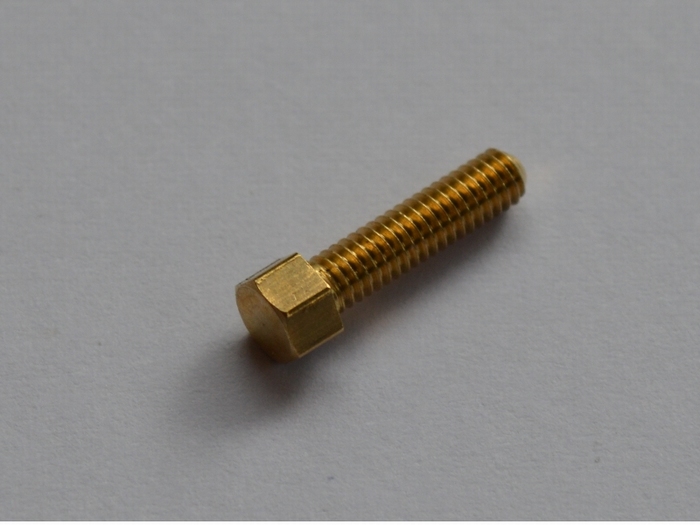

I m still to make 2 additional hammer weights, but this time in brass. But i m still to visit the hardware store to acquire the appropriate brass bolts with various head hights i ve ordered there.
Been considering brass to be better suited for the purpose (i think), since its volumetric mass density is somewhat higher than the specific mass of stainless steel.

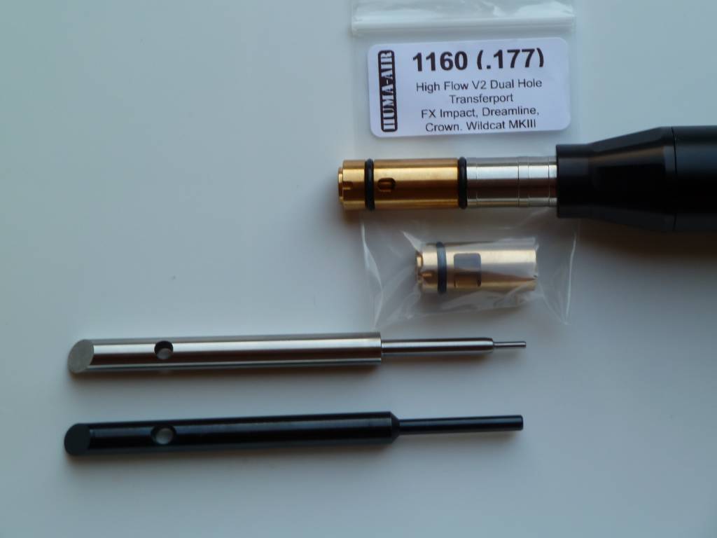

In the meanwhile i had last week ordered some pin probes and some V2 dual hole transfer ports (in 2 calibers), together with still another tuning hammer spring, with the guys from Huma. As soon as my 2 brass weights (with different head hights) get finished, i ll start combined testing the 6 available hammer weights on the 4 different springs i ve collected (somewhat varying lengths, different coil numbers and coil diameters, but all springs with the same OD).

I have the Huma twin port and I just got the pin probe, but have not tried it yet. I also got the tuning spring from Huma to give a try.

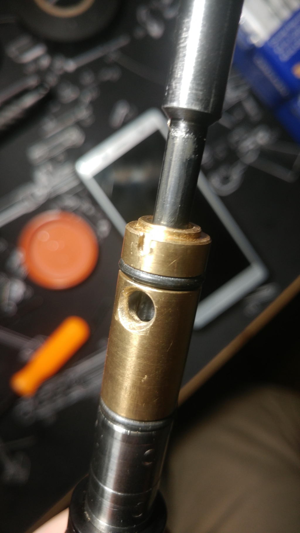

No photos or sketches are shown of the pellet probe mod, except from RabbitBlaster, which seems rather drastic.(oops, I didn't see all the posts on the other 7 pages of this thread) I squared the hole off on mine with a file and installed the dual port TP. One probe mod seen here has opposing holes. Since the air flows in from one side, what advantage is there with the second hole?? Isn't there a pin probe available? Seems that would be the best thing. Running my reg at 165 bar.

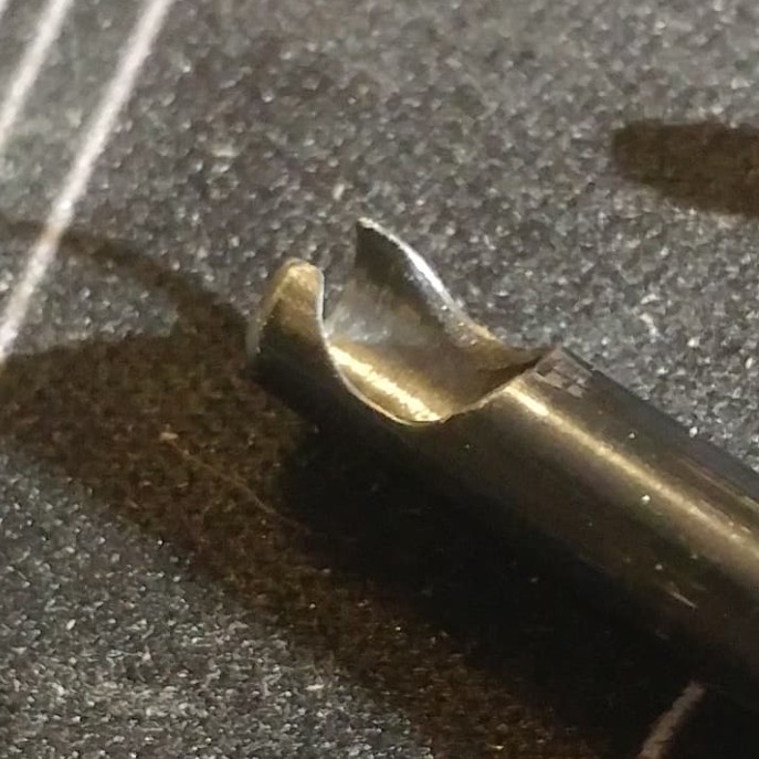

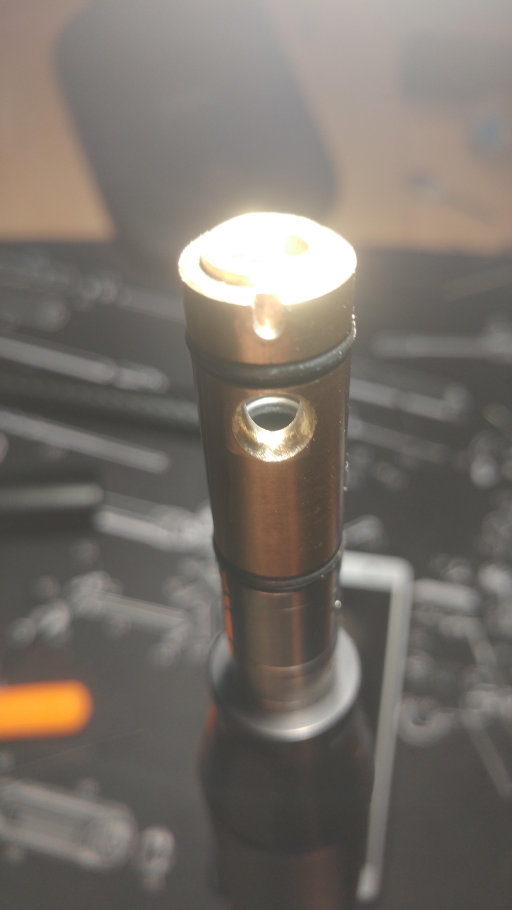

Huh. A bit dated now, but if anyone wants to port an older barrel... I noticed I never put up the port work I did to my gun in this thread. Probe also cut to match.
General Idea being based off of a power increase I noticed on my .22 when turning to the larger .30 port setting on the port wheel.
I made a bellmouth with the outer diameter matching the tranfer port @ .30" Left the middle of the port un-touched. And radiused the inside of the port toward the barrel/projectile, also elongating the port there, and cutting the probe to match. Gains were 50fps and 75fps over factory maximum on 380mm and 700mm .22 barrels, respectively. Putting me at 930fps with 18.13gr pellets in the short barrel.
Should be noted that smoothing/polishing the newly cut/ground port profile caused a loss in power. The finish of the port is better left in a some-what rough state to aid laminar flow
I agree, Paul.
Pin probe is the best way to go (imo anyway) for anyone who doubts whether they can confidently achieve an absolutely perfected cut-out of the factory probe, entirely and completely matching the barrel inlet air-dynamics. If not, then incoming air stream is bound not to be any longer 100% optimal, resulting in some degree of "swirling" possibly mortgaging flow.
That mere consideration has lead me not to start hand-dremeling stock probes, but immediately insert pin probe substitutes. At the same time also leaving me the option to -at any given point in time- go back to stock with my original probes intact, if ever i want to.

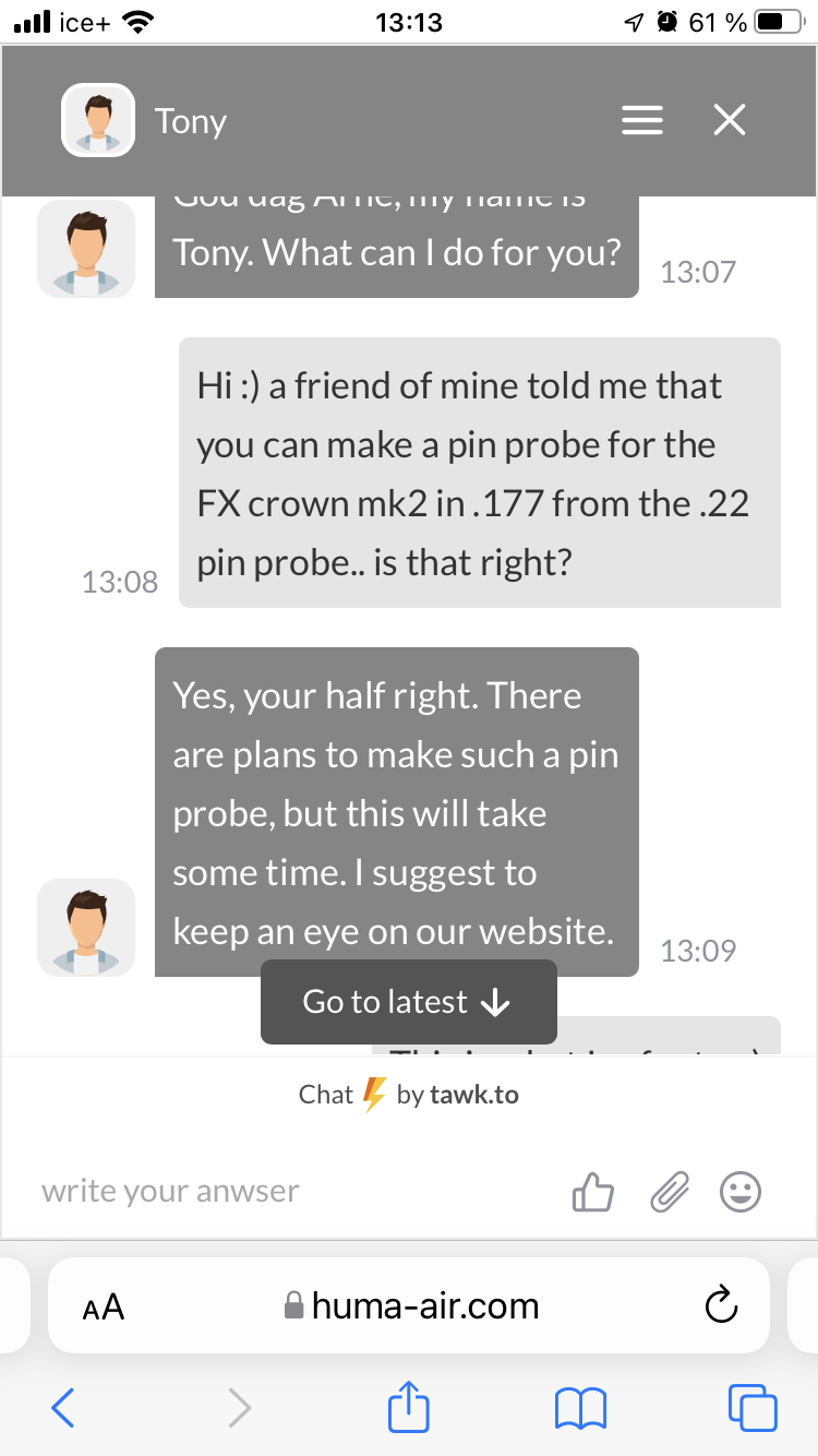

Since recently, Huma has the pin probes available for Crown in .22, .25, .30 .
However, Huma does not yet offer the .177 version. So I asked Marc (of Huma) to also make me a .177 pin probe (starting from a .22 one). And he immediately did so.
I m now shooting all of my Crown calibers on pin probes (with V2 Dual tp's combined).
I have not yet encountered any disadvantage. On the contrary.
Especially the pin probe in .22 cal delivers a massive surplus efficiency compared to stock probe. (when combined used with V2 Dual)
For those .177 Crown shooters with a keen interest :
Within short term .177 pin probes will also be continuously availabe on the Huma webshop (as Marc told me). But i m sure if anyone right-away-today were to ask him to make a .177 pin probe , he will accomodate that person immediately. (like he did for me)
