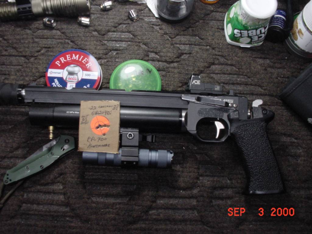

.22 PP-700 with a few mod's.

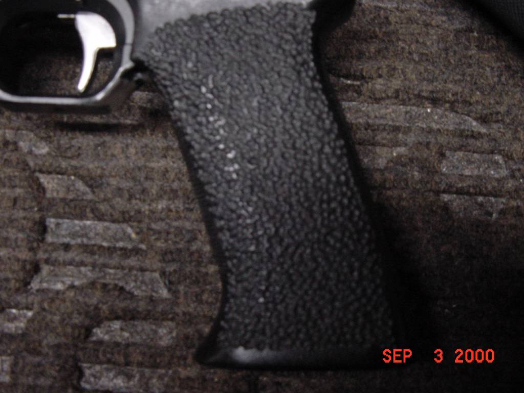

Re-shaped grip, to more match my 1911's, fully stippled, Tuned for high shot count and used for scorpion hunting at night. First summer 1837 Killed. this year, not so many with a total of 730.

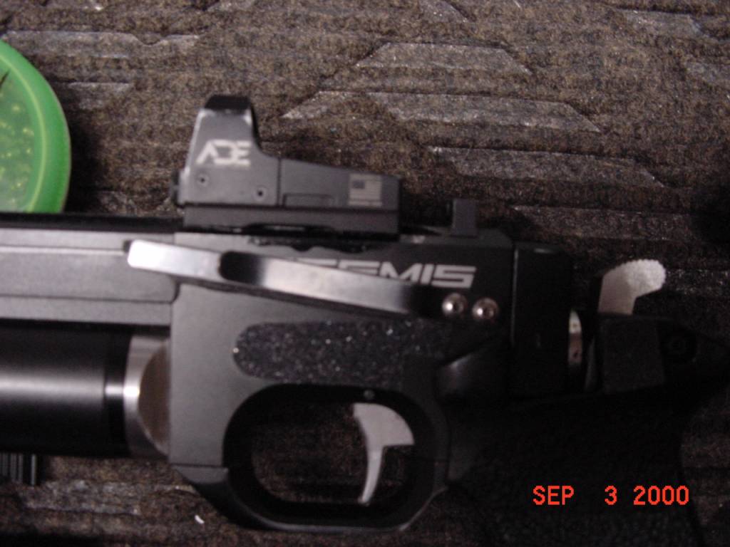

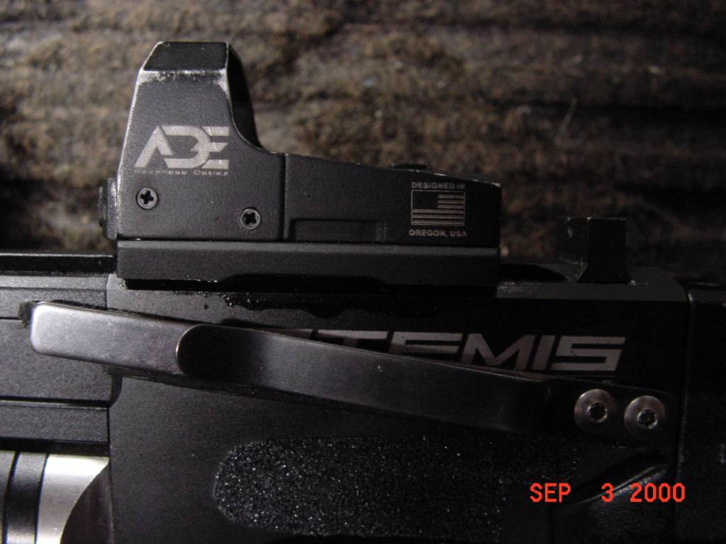

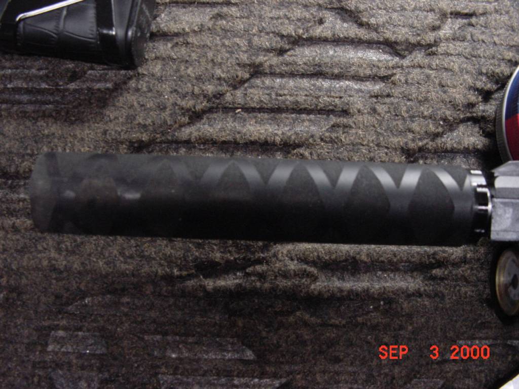

Rocker LDC, ADE B-600 Green 3MM dot Reflex sight, carry clip on action, Lower Picatinny rail with Black Light for hunting the Scorpions mounted.

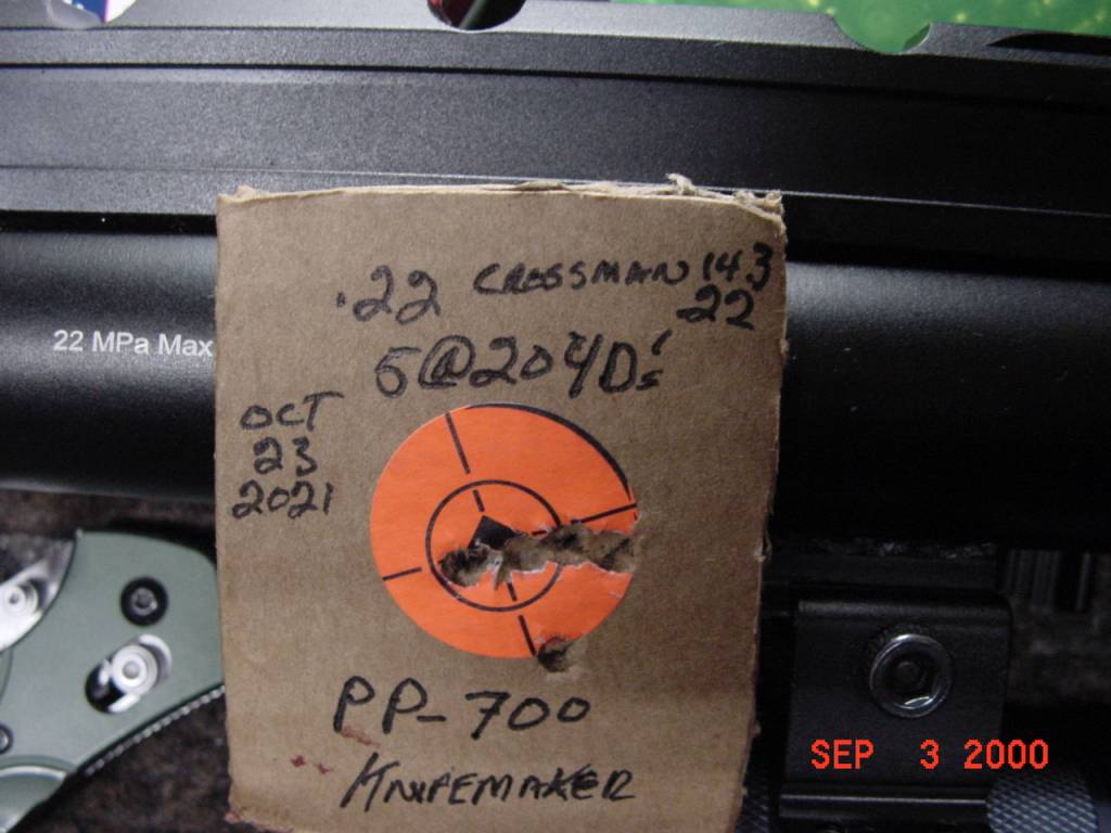

Never an issue with the Reg, with many thousands of both factory pellets, hand cast pellets and Hand cast slugs. It is accurate with all of them. Yes, evern the lowly Crosman 14.3 hp's. Only gun I have ever had that is accurate with them.
For such a low cost gun, it out preforms many high dollar guns. GRRRRRR!!!

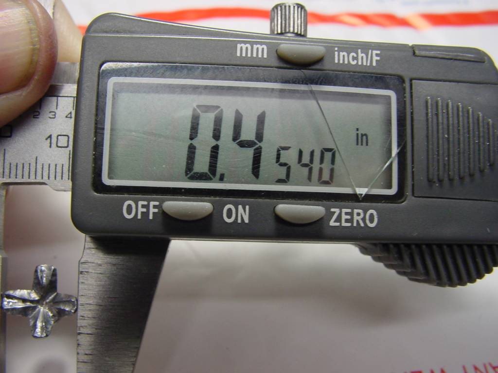

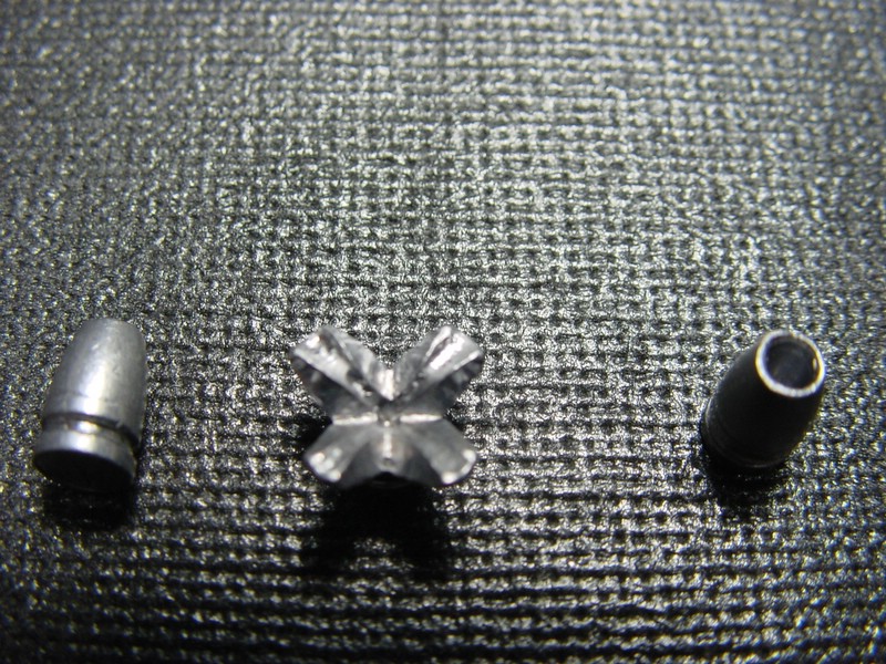

My hand cast segmented vermin Slug. Opens easily at 500 fps. Here, 560 fps from the PP-700 in water jug at 50 yards Expanded to .454".

The mold is a decked 257420 from Arsenal Bullet Molds that I fully modified. . FPS with the Crosman 14.3 is just over 600 fps. It can easily be tuned much higher.

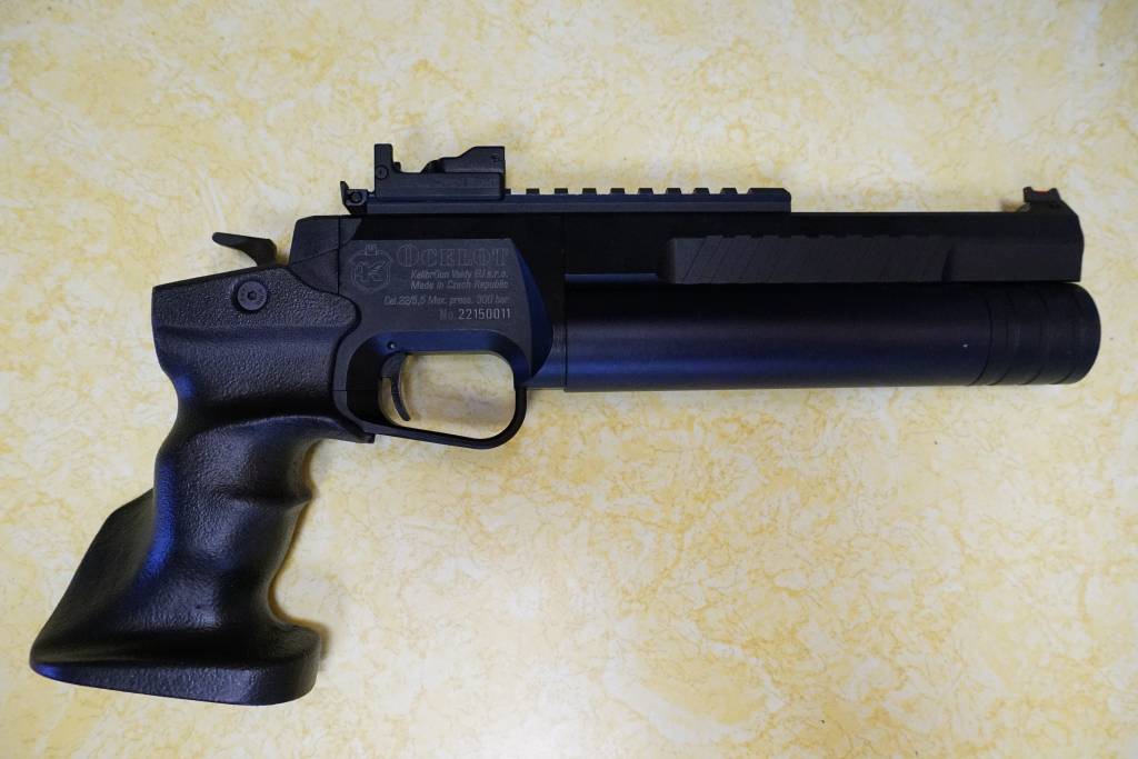

Which one was on the market first, the PP700 or the Kalibrgun, Ocelot ?
They appear to be much the same gun, just little differences here and their. I got mine second hand. Modified the grip to better suit my hand, still needs more though ! And yeah, I agree, accurate and a good time to shoot.

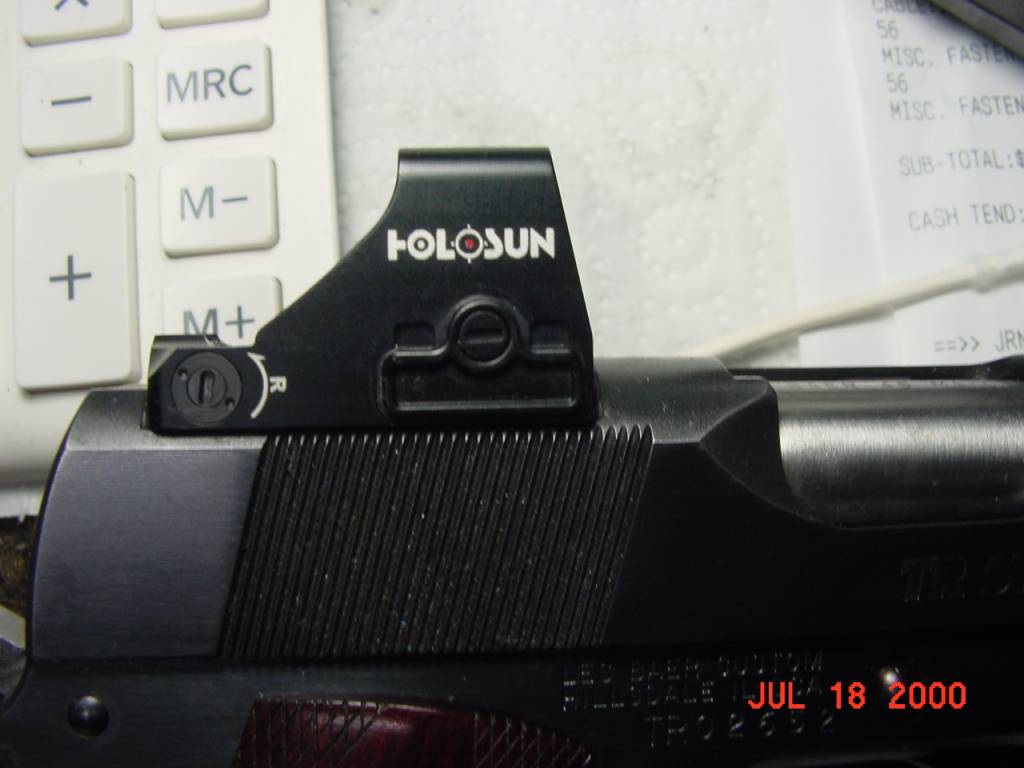

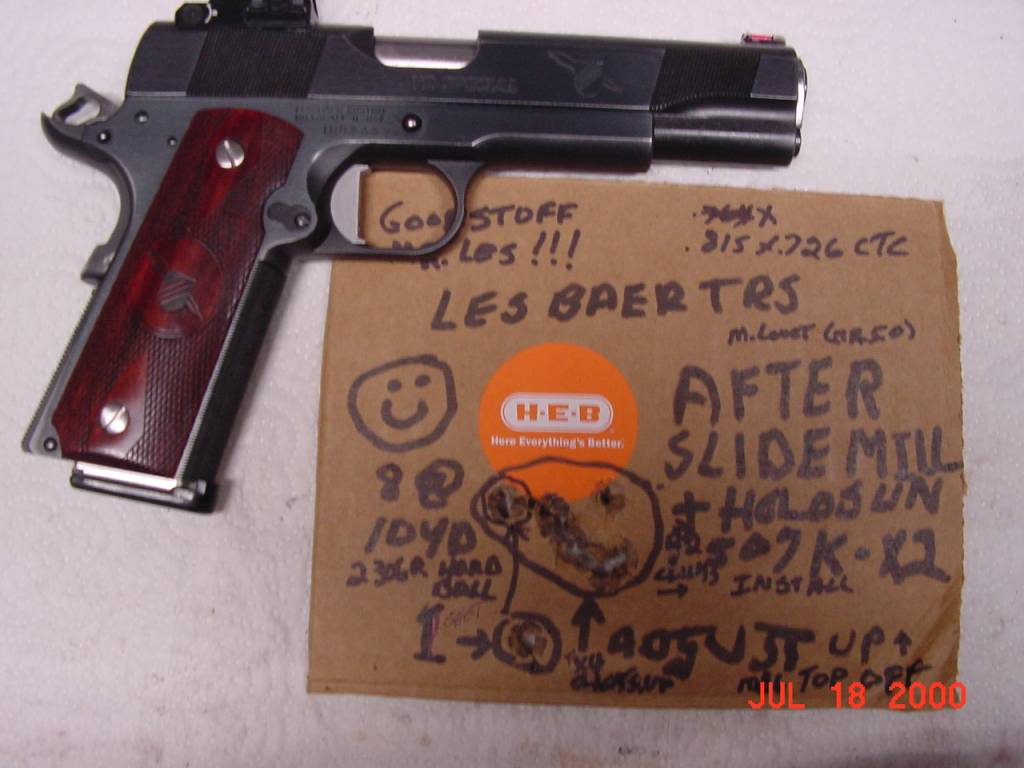

Mike, what is the mini reflex you have on it? I recently put a nice HoloSun 507K on my Les Baer. I was warned that it would take some time learning to transition to a reflex. However, with shooting the 700 for two years with the ADE, the transition was a natural. love a Good Reflex red or green dot.
Shown as an example only. Juts imaging it has a co-2 adapter on the bottom of the grip. LOL all mill work for mounting was done my myself.

While I like and also have a "few" Holosun red / green dot sights myself, the one on my Ocelot above is a "SeeAll" sight. It works sorta like a cross between a red dot and an iron sight. It takes a little getting used to, but now that I have, I have three of them. You can buy with or without Tritium to light the sight for in the dark shooting. No batteries, tough as hell. The testing one guy did in YouTube... He beat the hell out of it...with NO change in impact point. They have several different methods of attaching the sight to your gun. They have a new "plate" method that attaches to where a Holosun / RMR would be. I bought it as a backup for my Sig P-229 in case the Holosun that's on it dies for some reason.
https://www.seeallopensight.com/products/tritium-night-sights

that see all looks very cool. Question:
1. How is it for folks who need reading glasses?
2. How is the Delta reticle for doing hold over?
Thanks!
Brad
Salt Lake
I wear glasses, and have an astigmatism to boot. The Delta reticle is very clean and crisp, even in low light (with the tritium version).
As far as any "hold over", it will work just like iron sights...your best guess ! Like I said above, The SeeAll is a lot like a cross between a red dot and iron sights. There is no second dot, line or point in which to attain an accurate hold over position. A single point in which to aim.
Go to YouTube, there are various videos to watch on how it works, adjustments, and punish-ability.
