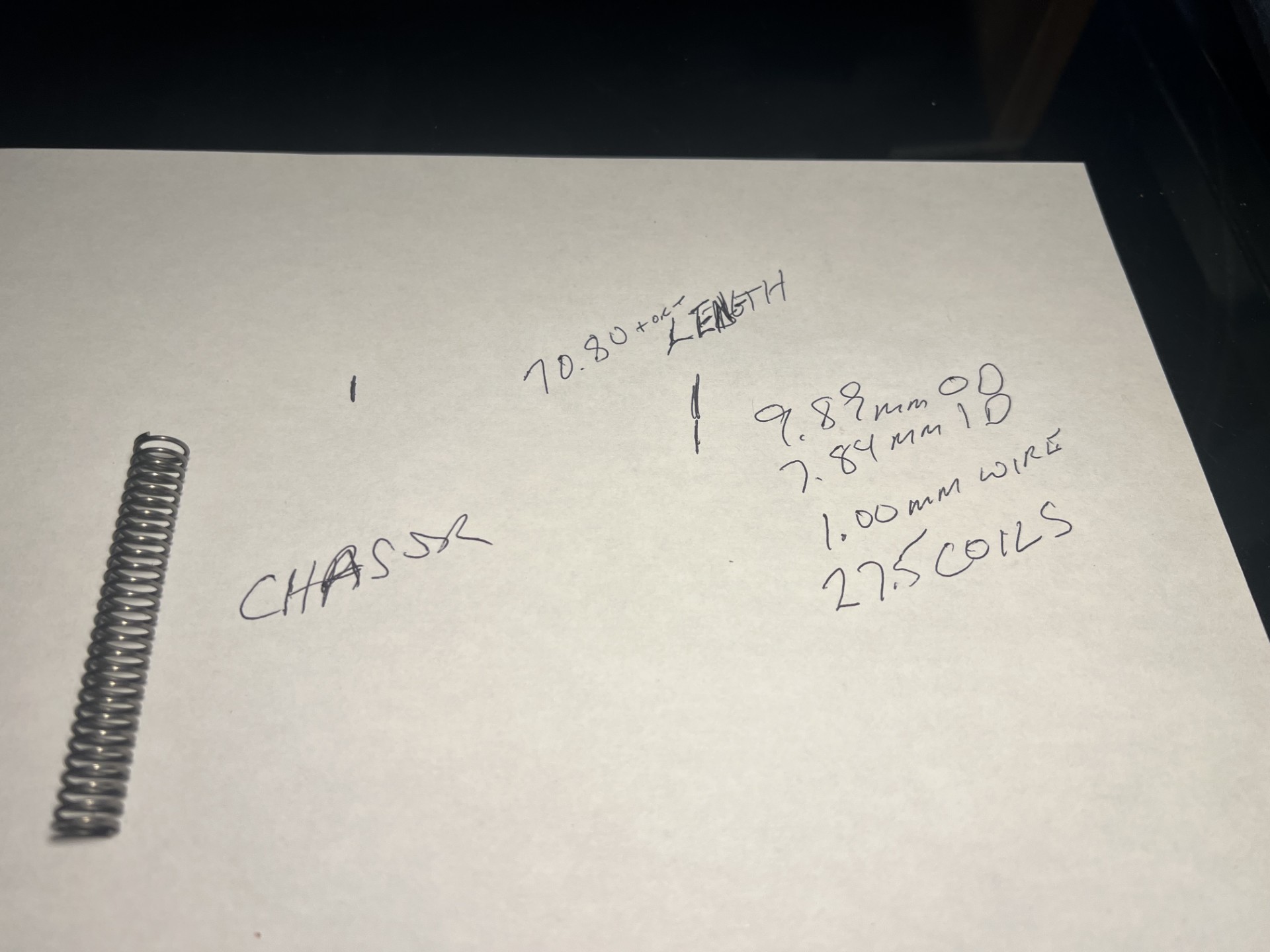

if i knew the spring size i could compare against one of my Chasers the shims are easy to find i buy from this seller
https://www.ebay.com/itm/164573184907?var=464175123552
get me the spring sizes wire diameter, overall length, number of coils but the fact will be hard to match and then you would guess
also spring ID and OD

Wow my spring ( because it has already been cut so not sure of original length ) is a bit longer at 73.44mm and I have just 20/21 coils? The OD and ID are the same and also the wire diameter.
I will try and find a spring with your dimensions, I could not find one with my dimensions. Unfortunately WB Jones does not have a stock with that length so to have them custom make one is $19.18 and you have to buy 10 pieces.

just buy them from Ebay the spring that are sold in the states come from China anyway
spacers
if you get .5mm or 1.0mm or both spacers, washers call them what you like to sit in the piston or whatever they are using for a spring guide on the rear cap
you can get springs in 305mm lengths cut your own
this is all a guessing game because if a guy find a spring somewhere in the states could you find the same spring
i would go with 0.8mm and 0.9 mm wire
spacers
