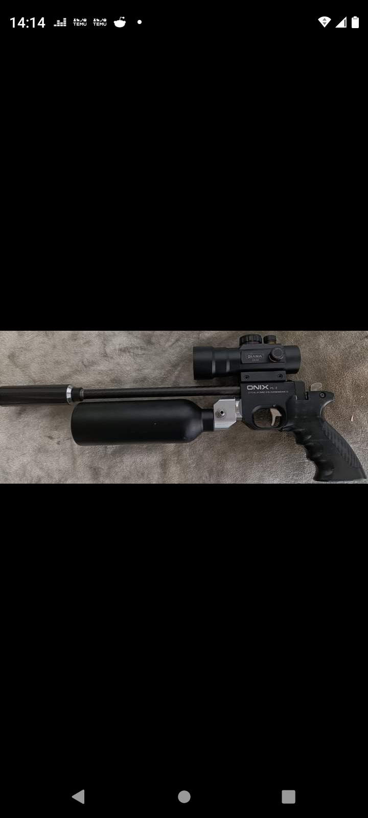

i know of no other gun in the Snowpeak-SMK-Artemis-Diana group that share that tube at all but i could be wrong

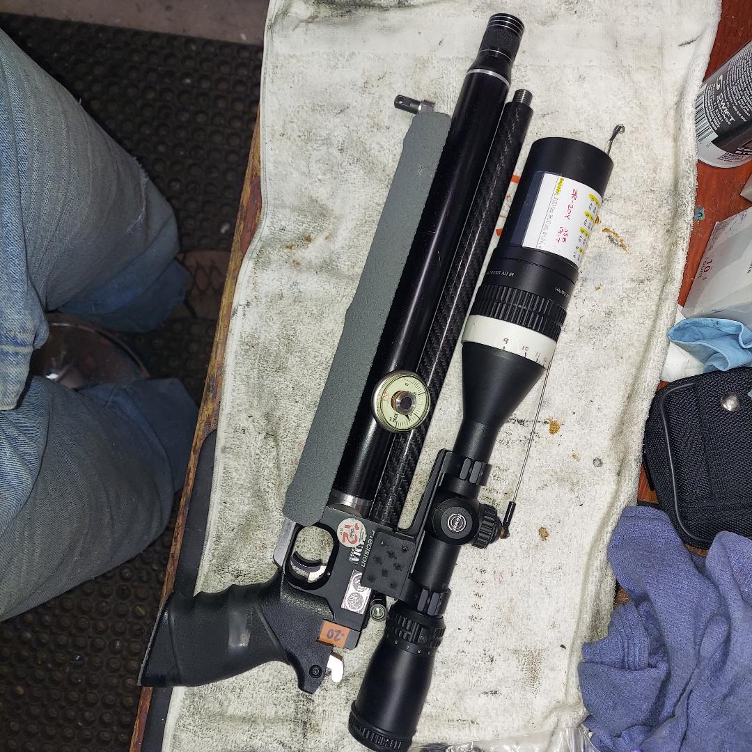

Why ... 20 FPE modification to shoot EXTREME FT pistol. Am able to make the power, don't have the air on board for many shots.
Could USE 3 inches more ;)

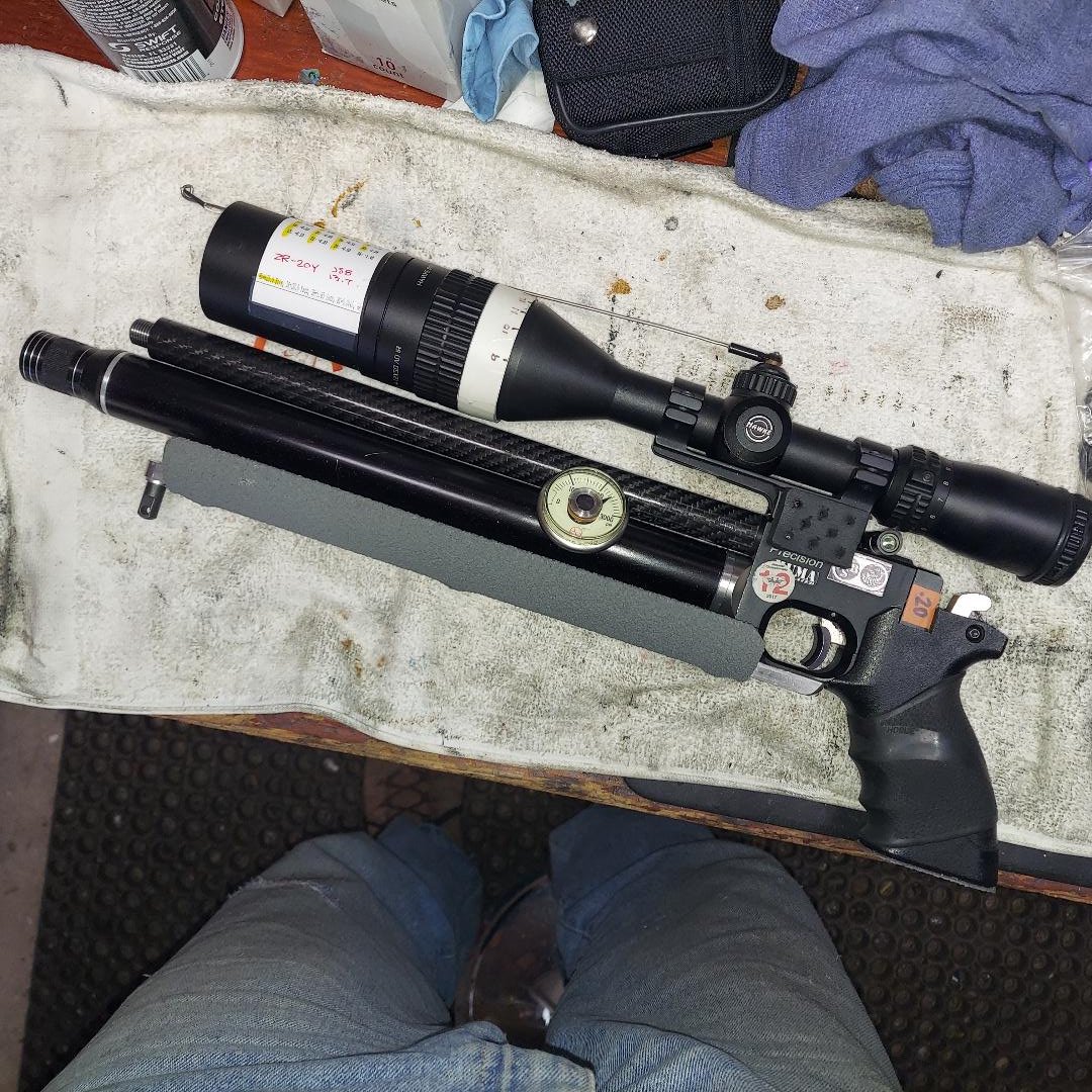

My barrel as shown is at 15" and an air tube COULD NOT be any longer to be legal for what I'm trying to do.

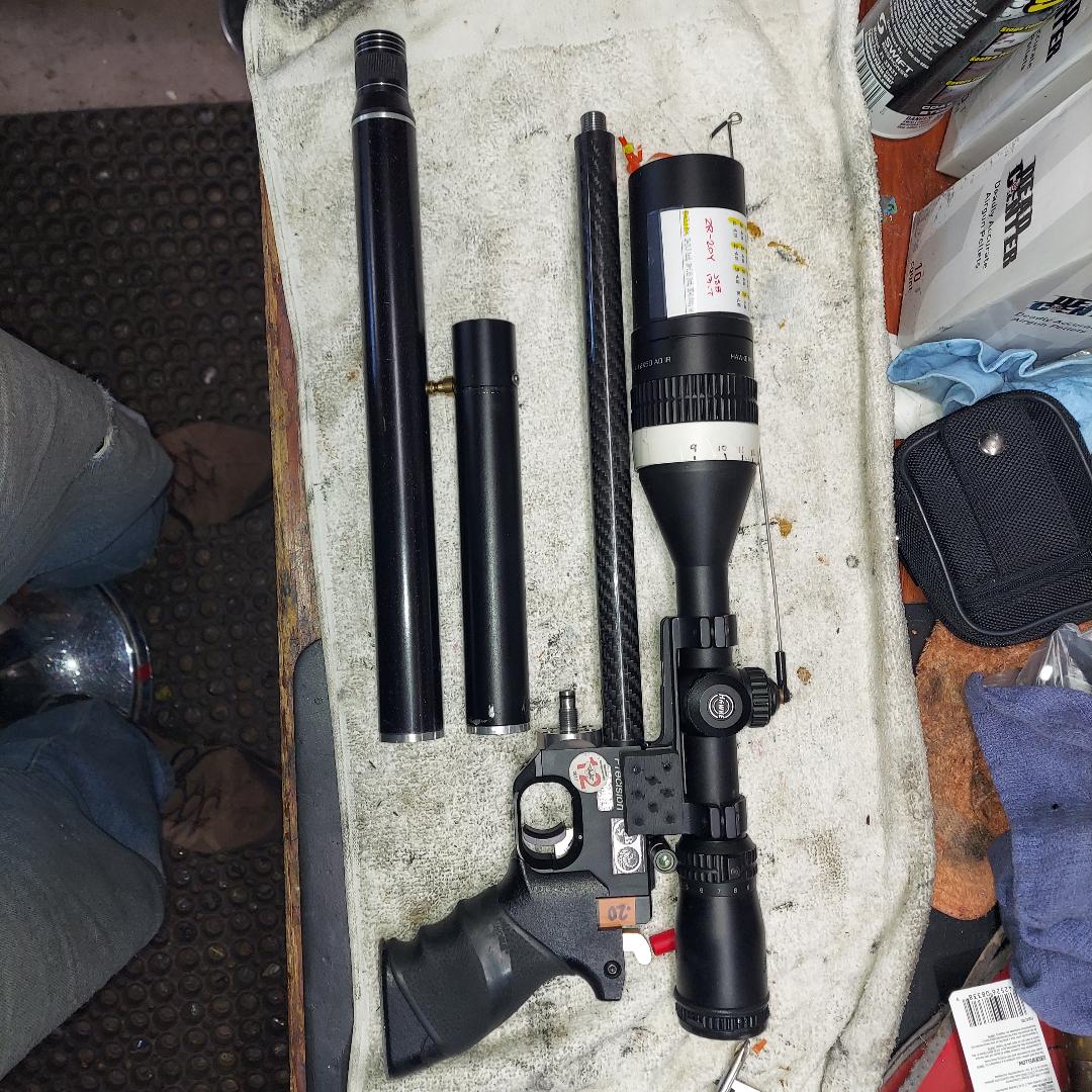

Deep digging in parts piles, recalled having a short length of 1 1/4" DOM tubing as scrap from my time at JSAR.
Correct O.D. but tube already tapped both ends for M-rod threading :unsure: Not to be deterred dug deeper in the m-rod parts stash coming with an a filler end & cap, and a previously made tube end of unknown origin. Onto the lathe fabricating it all to fit in place (As an Assembly ) onto the gutted regulator male snout having 10mmx 1.0 threading.
Inside the tube a hogged out M-rod gauge manifold positioned to not interfere with the HuMa in tube reg while having gauge on left side for easy viewing.
Increase in tube length was 5" over oem more than doubled the air capacity. ( Distance inside tubes end caps OEM a@ 4" and now 9" tho do have gauge manifold inside tube now. SAWEEEET !!!!!
