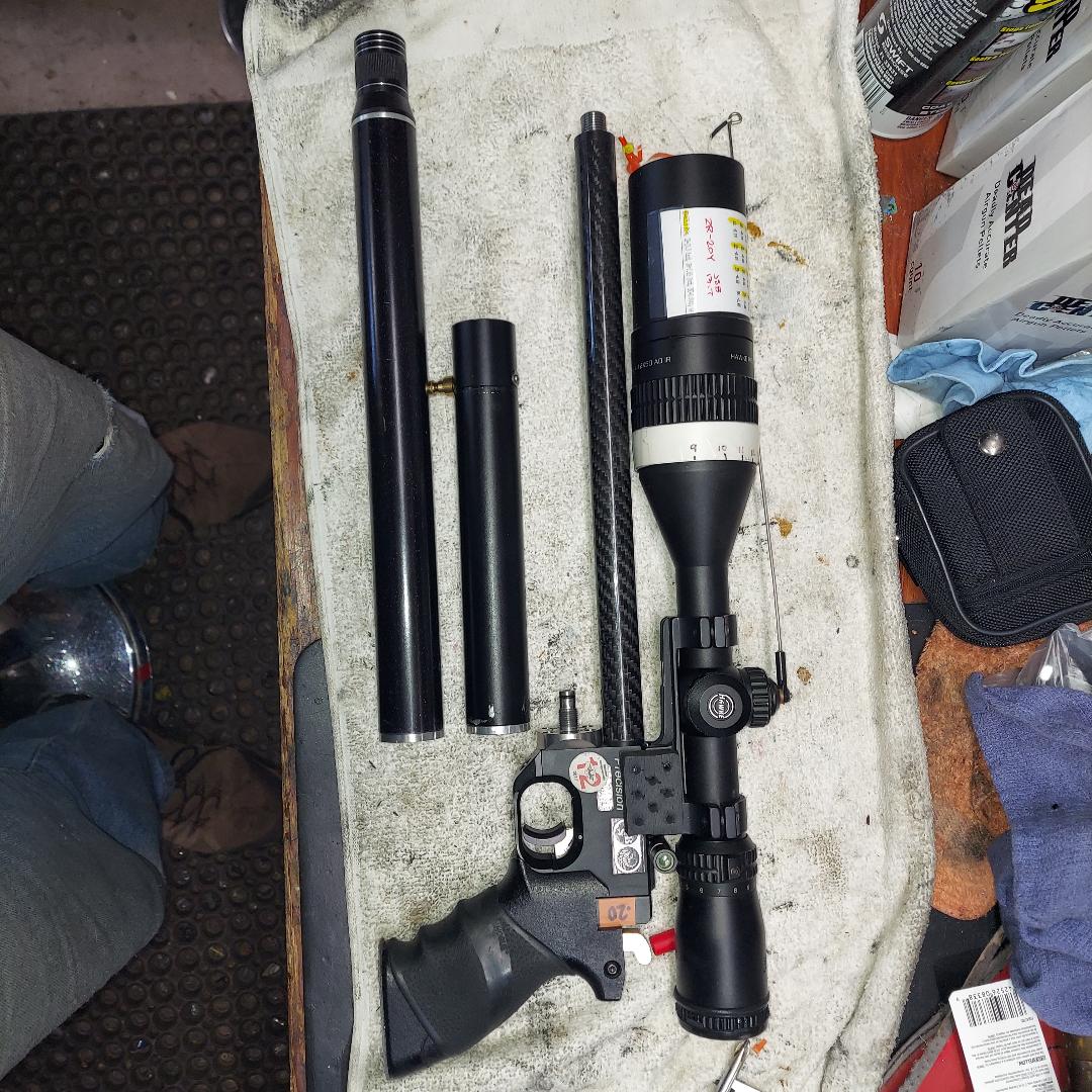

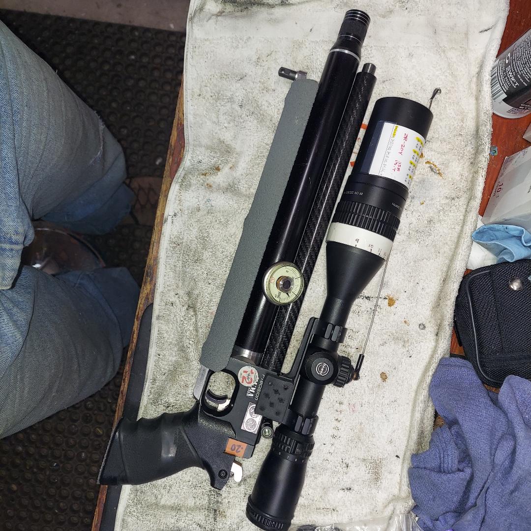

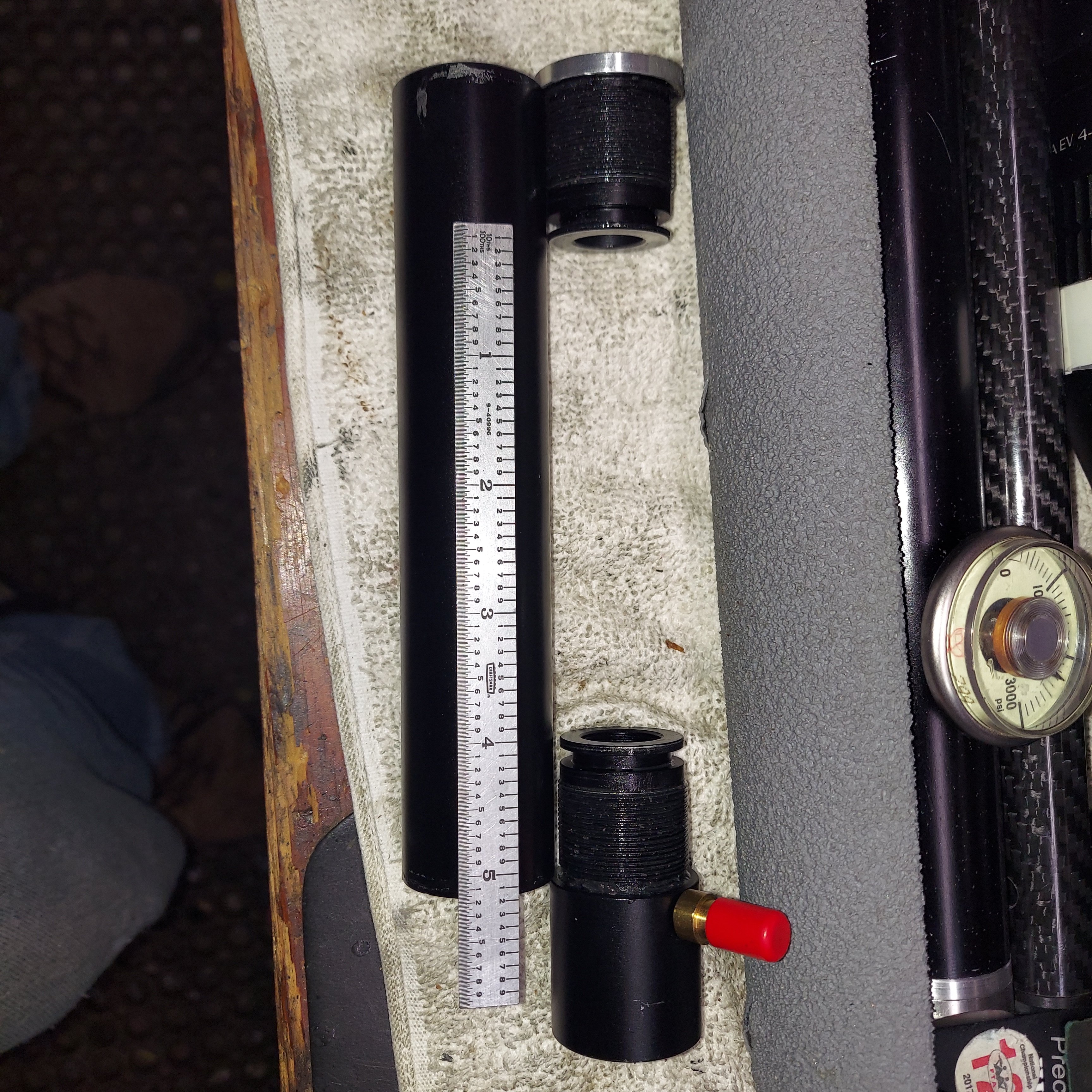

PP700 .. Longer air Tube / No lucking finding .. So MADE ONE
Deep digging in parts piles, recalled having a short length of 1 1/4" DOM tubing as scrap from my time at JSAR.

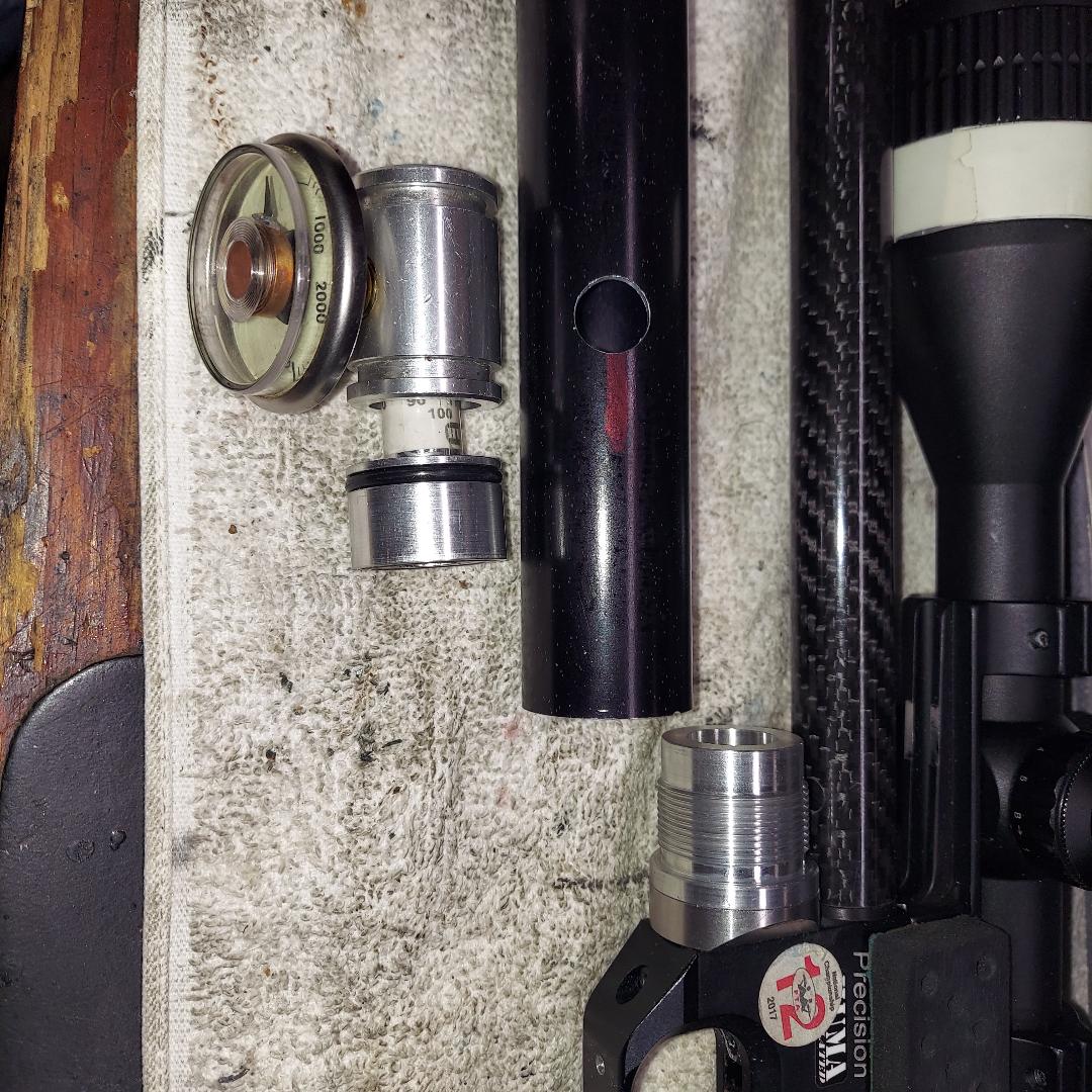

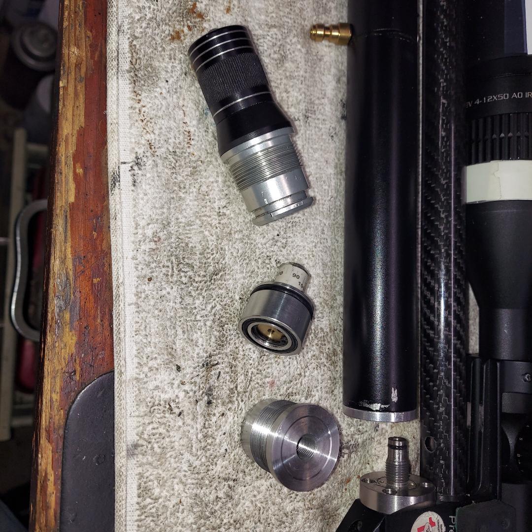

Correct O.D. but tube already tapped both ends for M-rod threading :unsure: Not to be deterred dug deeper in the m-rod parts stash coming with an a filler end & cap, and a previously made tube end of unknown origin. Onto the lathe fabricating it all to fit in place (As an Assembly ) onto the gutted regulator male snout having 10mmx 1.0 threading.
Inside the tube a hogged out M-rod gauge manifold positioned to not interfere with the HuMa in tube reg while having gauge on left side for easy viewing.
Increase in tube length was 5" over oem more than doubled the air capacity. ( Distance inside tubes end caps OEM a@ 4" and now 9" tho do have gauge manifold inside tube now. SAWEEEET !!!!!

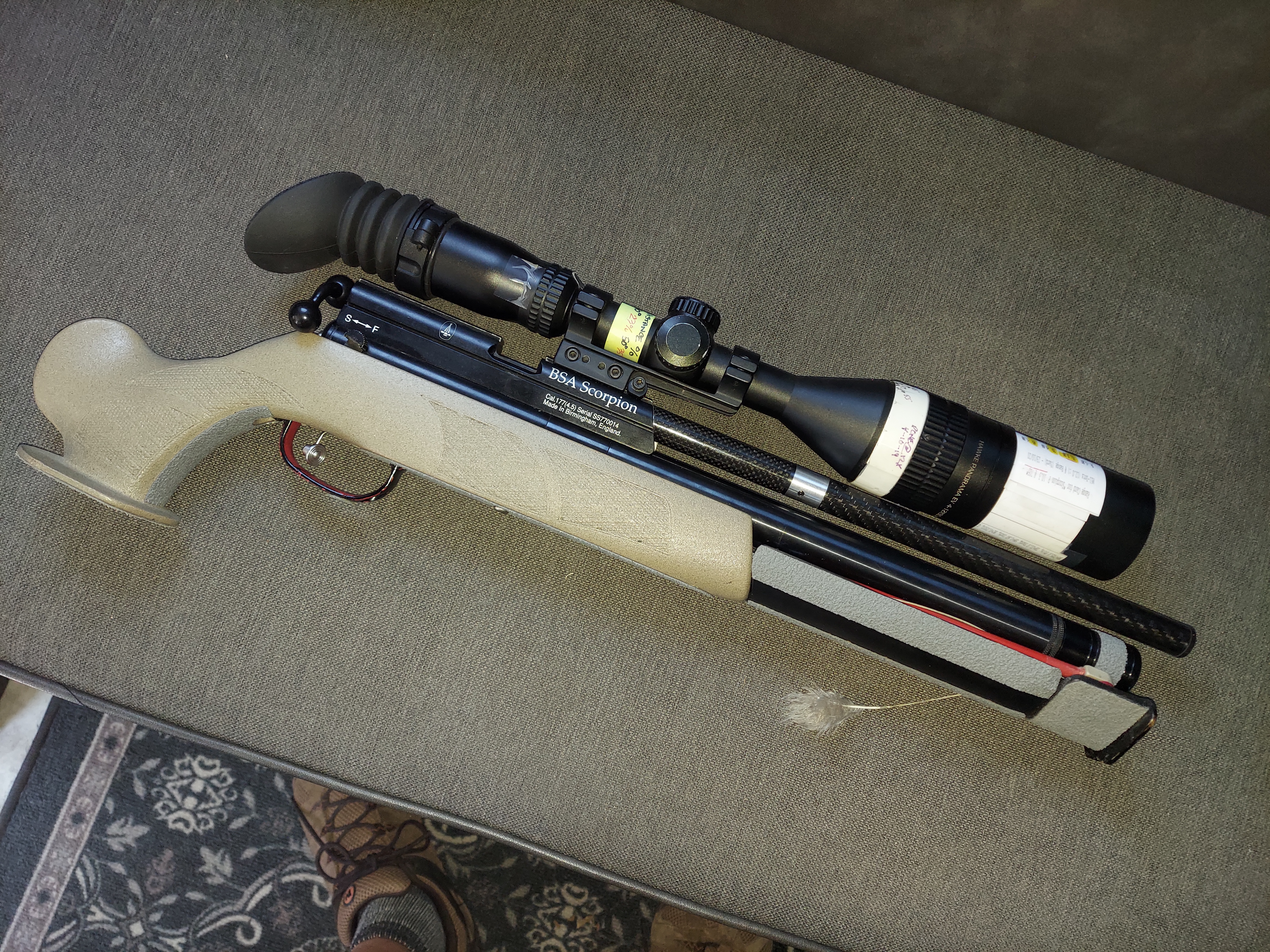

This my primary FT Pistol. A Very modified & massaged Single shot BSA Scorpion .177 cal.

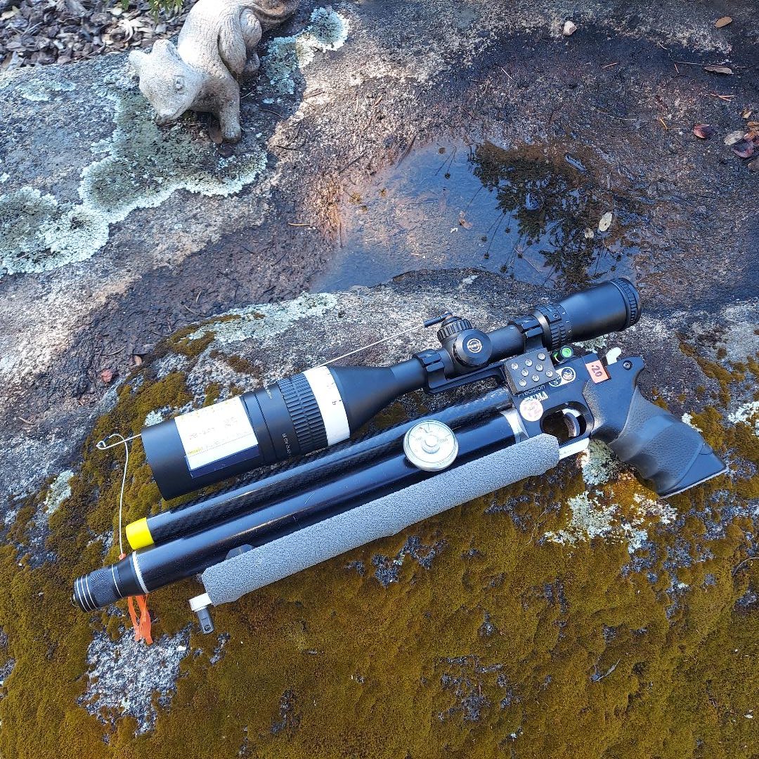

Ok .. finally at a usable finished FT pistol set up 😍
D.O.P.E. 9-56 yards, Wind flag, Variable height Bubble level, Eye Shade, Few xtra pellets at the ready & Wika pressure gauge.
All sighted in and dope data proofed.
it's a shooter if steady when shots get taken .... yup that is key being STEADY !!
Air tank came in at @ 135 cc capacity.
Pistol went to Oregon for the State Championship / GP a couple weeks ago & was loaned out to a first time pistol shooter. He had fun but did not score particularly well :cautious:
In the week+ following match took some vacation time and was able to sit back on a few occasions and shoot the pistol more and really see how it shoots near & quite far !!! One afternoon was camped along a stream in central oregon and was plinking at features along the shore or just visible boulders breaking the surface of the water. Took shots one after another 80 to 100 yards and once holdover was figured out, drop .20 cal JSB's right on the mark over & over again. So it is accurate & stable in velocity showing great potential it could be used in serious competition at some point in the future.
* All the shooting thus far has been at >12 fpe using JSB .20 cal 13.73 pellets. Will revisit once we set back up at >20 fpe at some point :unsure:
Its very much together 🤪Even have a thread protector in YELLOW over the muzzle threads.
Legal at 15" of barrel, > 3" forestock depth & just 20" OAL having 5" to spare :LOL:
