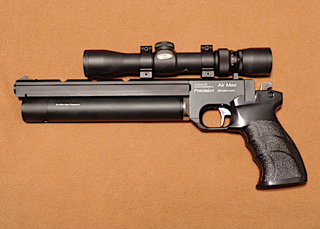

Equipped with a 2.5-8X Weaver Classic LER pistol scope
.22 MRodAir AirMax Precision single-shot PCP pistol
Brand-new this gun chronied all over the place, so I monkeyed with it to get these results.
*18.1gr JSB, 2800 PSI, 15 shot powerband* Lo= 591, Hi= 625, ES= 34, SD= 11, Avg= 607
*Five consecutive five-shot groups at 35 yards with 18-1 JSBs averaged 1.31” c-t-c.
After some research and backing the hammer-spring tension way off, got these numbers.
16gr AA, 3000 PSI, 30 shot powerband Lo= 581, Hi= 606, ES= 25, SD= 6, Avg= 596
1/14/2018- Five consecutive five-shot groups at 35 yards with 16 grain AA averaged .61” c-t-c.

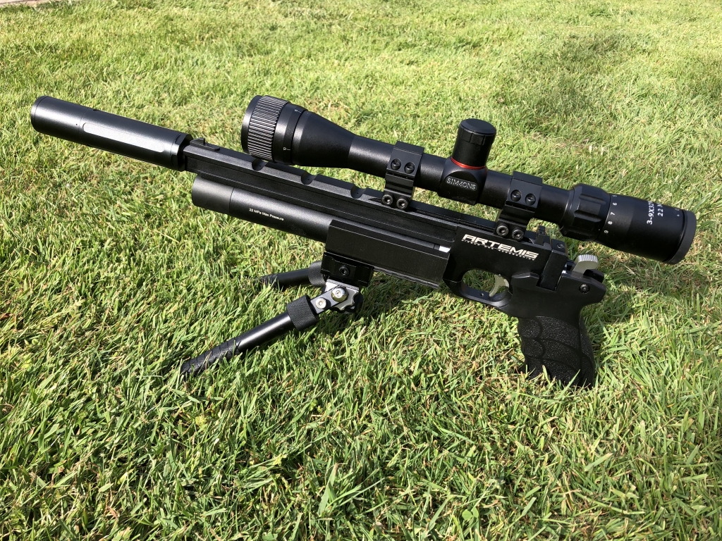

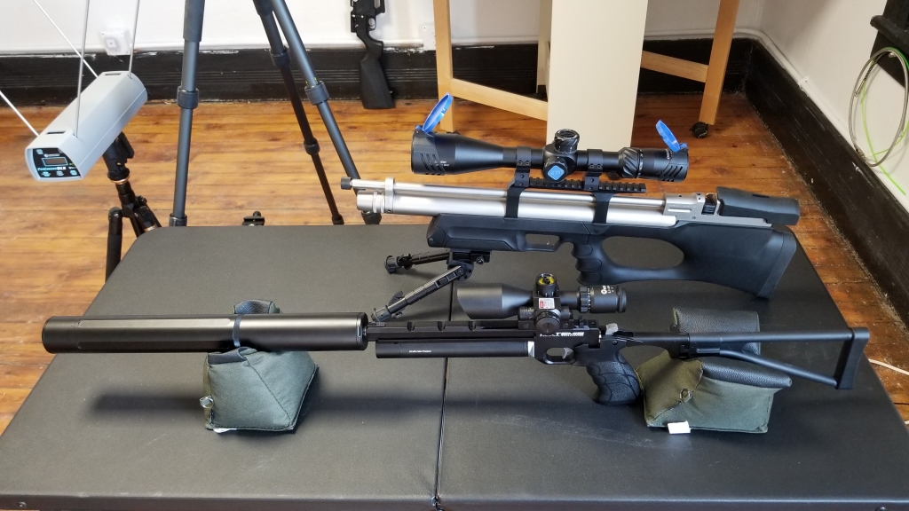

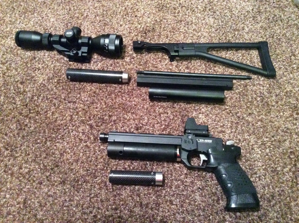

Pistol setup I use a micro red dot. I think it has some parallax issues at 10yrds but not horrible. Shoulder stock long barrel and tube setup, I use a 3x9 AO compact scope with a one piece mount. I did mount a variable power pistol scope on the short version while testing the LW barrel I built. Waaaaaay more accurate than the dot but the gun started getting clubby again so I went back to the dot. I might try a small 2x pistol scope soon. I will drill and tap the action for a weaver base if I like it.

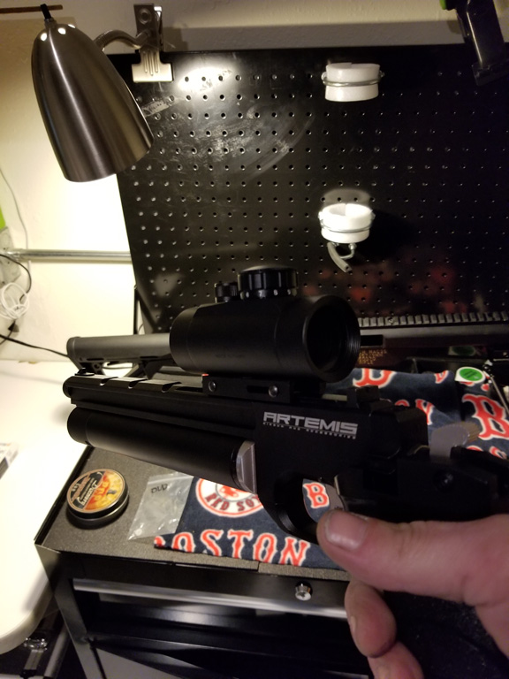

My PP700S-A fitted with the OEM folding stock, a DonnyFL adapter,
and as a joke, I threw an Emperor V3 and Extender on there too. [It's super quiet]
I couldn't find my other scopes [they're hiding in moving boxes] so for the time being,
there's an el cheapo CVLife laser/scope combo on it.
I figure I'll either fit it with my high end Tasco Red Dot, or, Green laser.. we'll see..
When actually shooting, I use a RONIN, so it's quite a bit shorter.

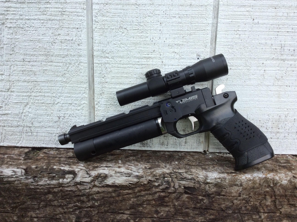

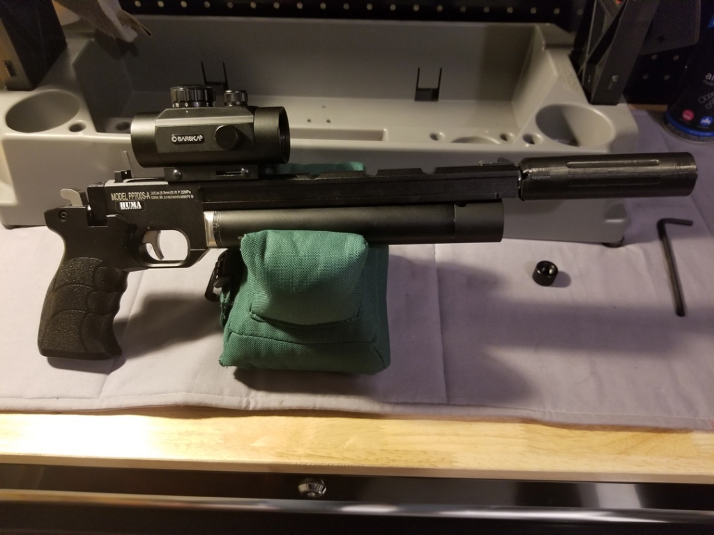

My PP700SA, twith Barska 30mm Red dot,
rework with Huma reg, and bridged with the onboard gutted reg. reworked the valve, made custom derlon seal increase thickness by .005, increased opening by .007, polished trigger and reshaped hammer. Multi baffle LDC makes her very quiet, Tuned for power high average 723fps / low 601 bout 27 shots per fill. Very accurate on my 25 yard setup and hard hitting with RWS Super Point.
can I ask a question, why are people buy the PP700 and not the PP800 which is a Diana Bandit
the performance looks the same, the trigger look to be the same as the Chaser which is very easy to redo to make very light, I have done 3 chasers I have
and the Chase-Bandit pistol is easy to add a Weaver Pinatinny bridge over the barrel by using a barrel band and Keymod 13 slot rail and using the center index barrel hole for the back mount
just curious
