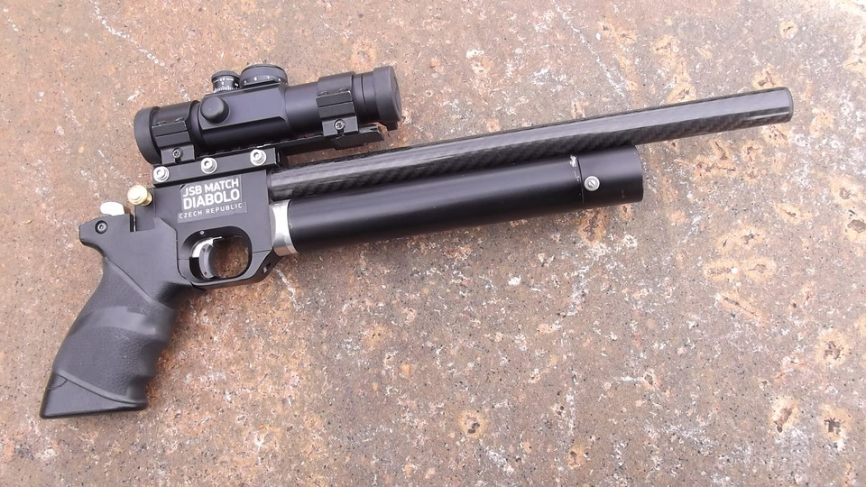

I did get some nice groups on occasion when I had it as a pistol. Here's a 25 yard group with Polymags running about 13fpe in .177 cal.
Since then I downtuned it to around 6fpe and it took a liking to RWS Supermags. These groups are at 25 yards with the shoulder stock fitted:

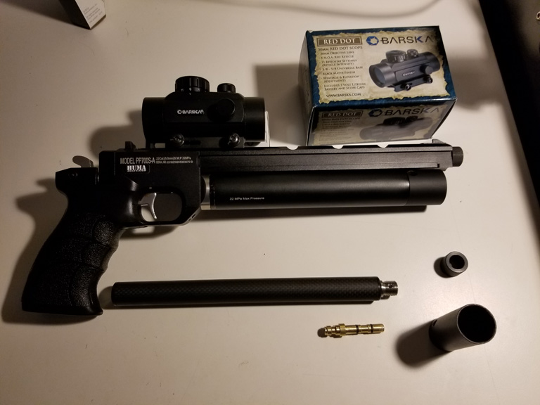

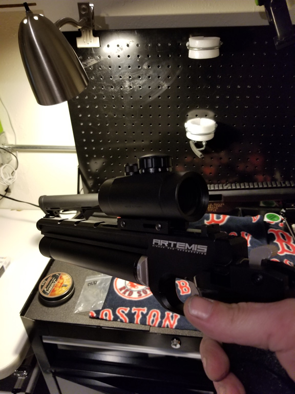

Evening, I picked up a PP700SA used a week ago, A bit about PP700SA. Came with Huma regulator, JSAR breach block, extra carbon fiber barrel with DonnyFL adapter.
Filled it up and while it shot good there was a leak that would drain the tank in an hour and it did not sound right. So did a break down, first off you can see tool marks on tank back were they screwed off before apparently to install regulator. Went thru changed all orings set huma, then I removed the constant valve as they call it. I was well surprised all of the Belleville washers were rusted along with rust on the valve stem and nut. The gun was directly imported in March from manufacture.
Short of it is replaced the Belleville washers, cleaned valve assembly, set reg, changed o-rings, set up hammer spring. Now she shoots ok have not had a chance to chrony but it sounds much better than before. But I am still plagued with a slow leak, albeit it is taking about 2 hours now to leak down. All mating surfaces are good, the pistol fires fine just cant stop that slow leak.
But overall the Artemis is a blast to shoot, very accurate with my red dot, good power range, buy one if you have a chance despite above hassle it is well worth it.

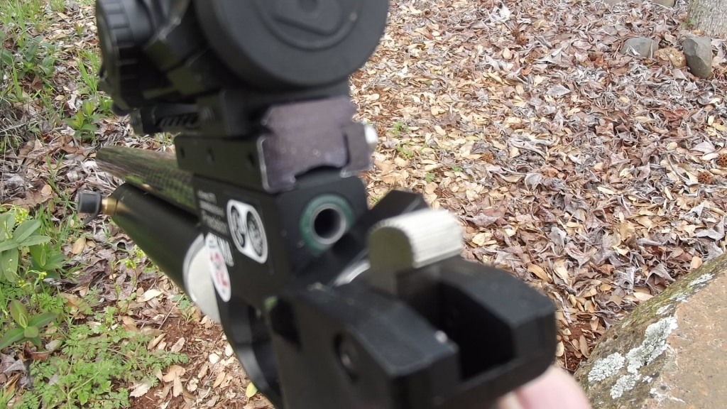

I traced mine to the check valve. I smoothed the poppet surfaces and face with 400 grit sand paper and use 75 viton oring in place of the original. The old buna orings were getting nicked up by the poppet. So far my gun has been holding air for the last 3 months.
