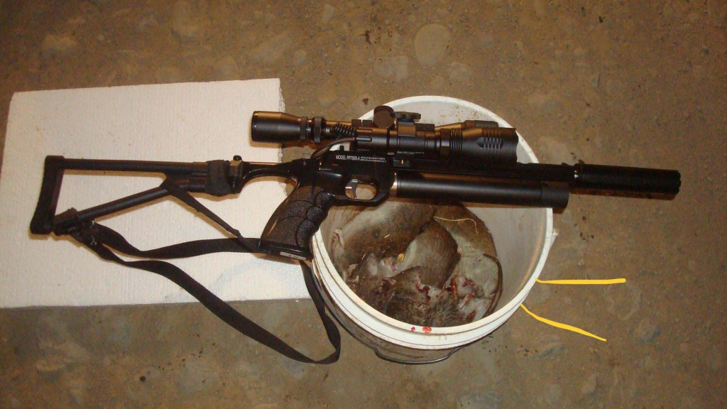

I got my adapter and LDC from DonnyFl. The Tanto makes my pp700sa very quiet.
That’s fantastic! I sure wish that I could partner up with you on those rat shoots Luis. I sure am enjoying mine. It’s still in pistol form. I haven’t made or bought a stock for it yet. I hope to soon. As of now I have recrowned the barrel twice. I did a much better job the second time than the first. That metal seems really soft . Anyway, I’m shooting around .5-.75” at 30 yards with JSB RS 7.3 pellets rested and a scope on 9x. I’m pretty happy with that. Sometimes I can get a small group so I know it’s capable. I’m getting 55 shots on a fill. I haven’t chronied it since that last time I reassembled the pistol and dialed the hammer spring tension up. I’m guesstimating is around 650-680 fps.
