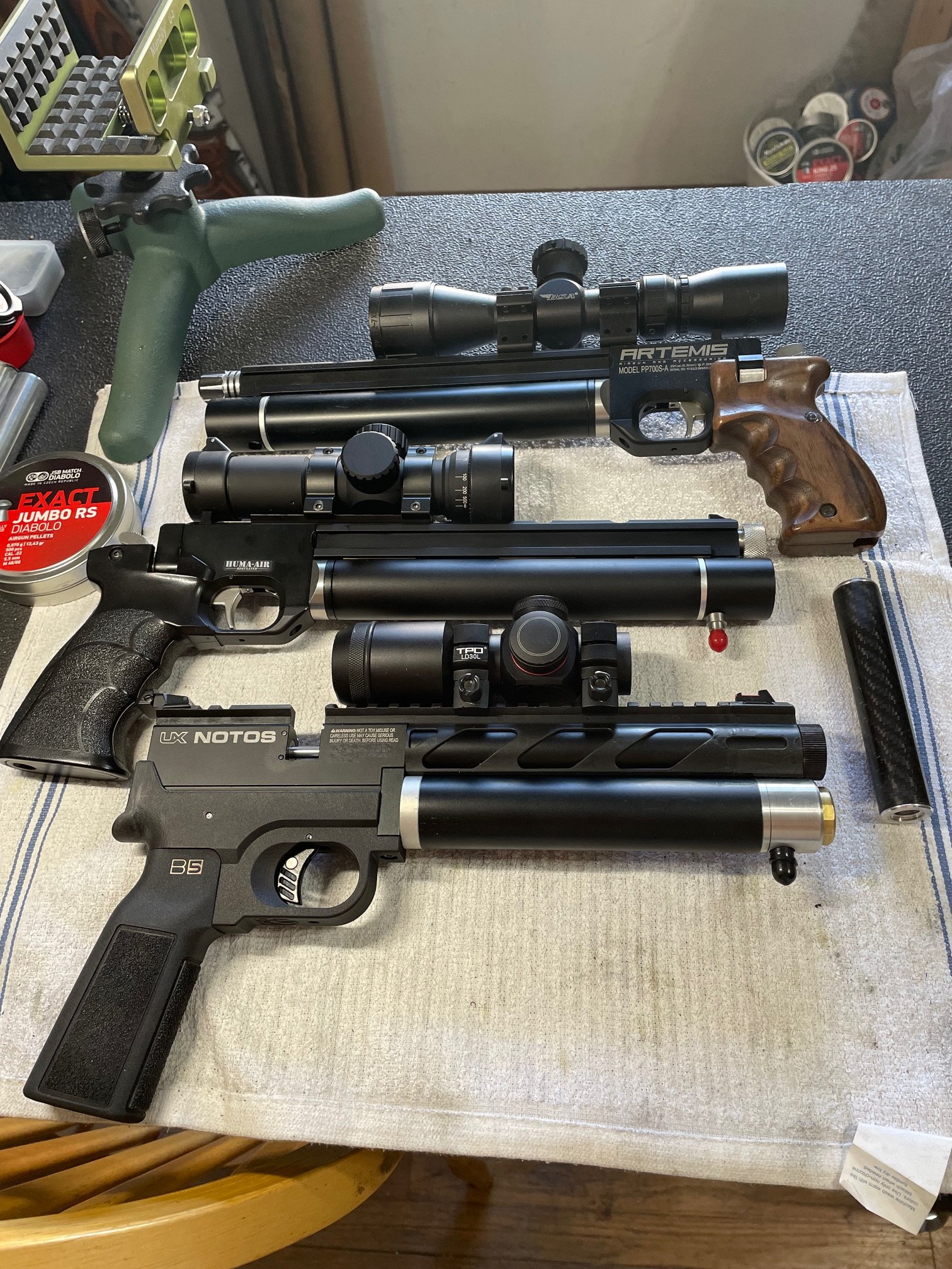

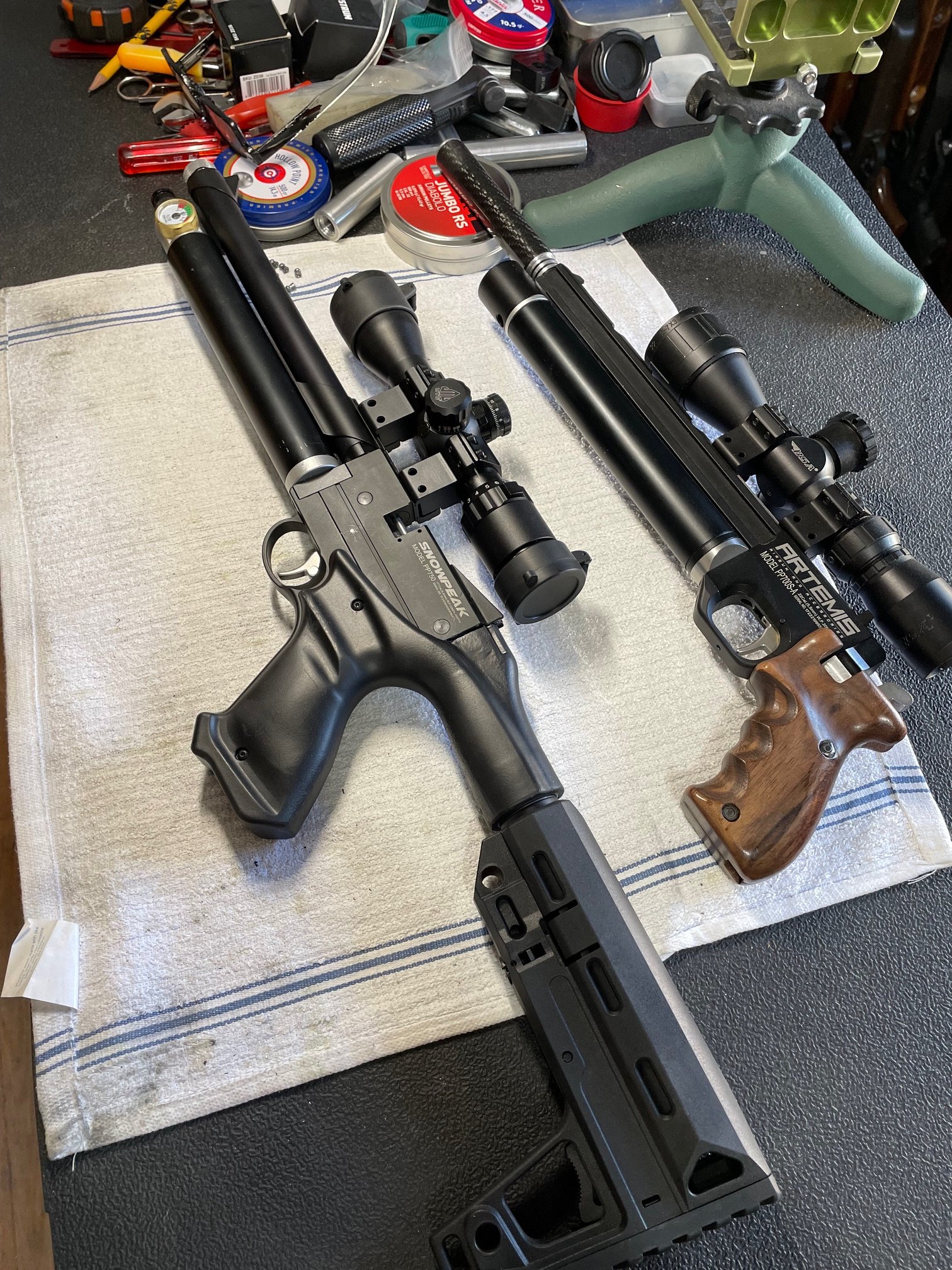

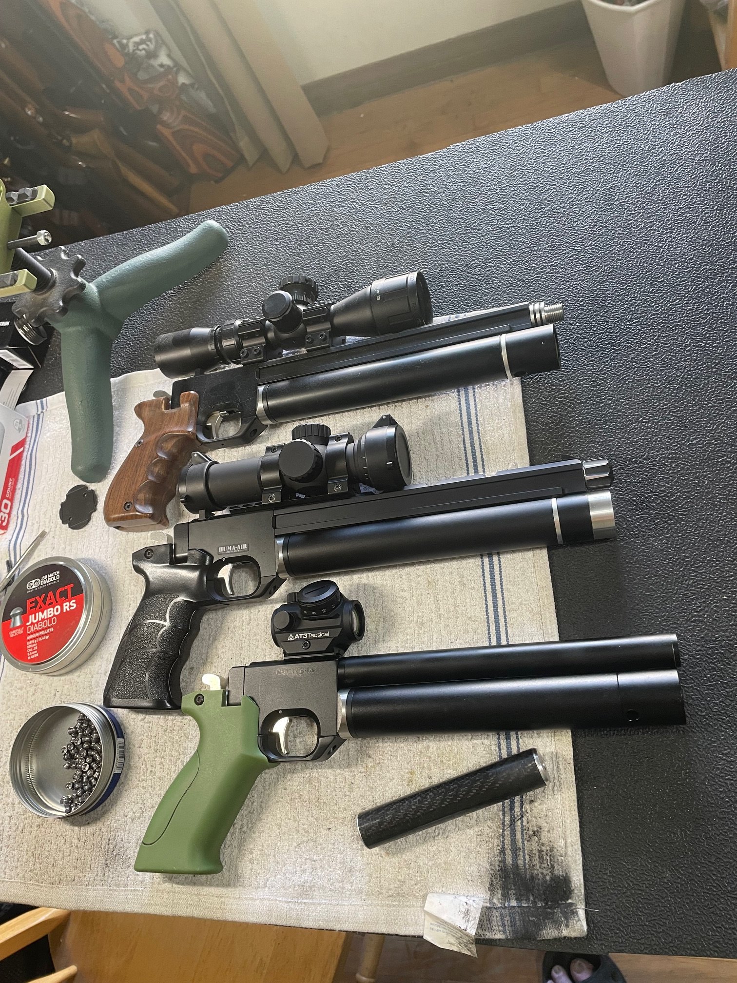

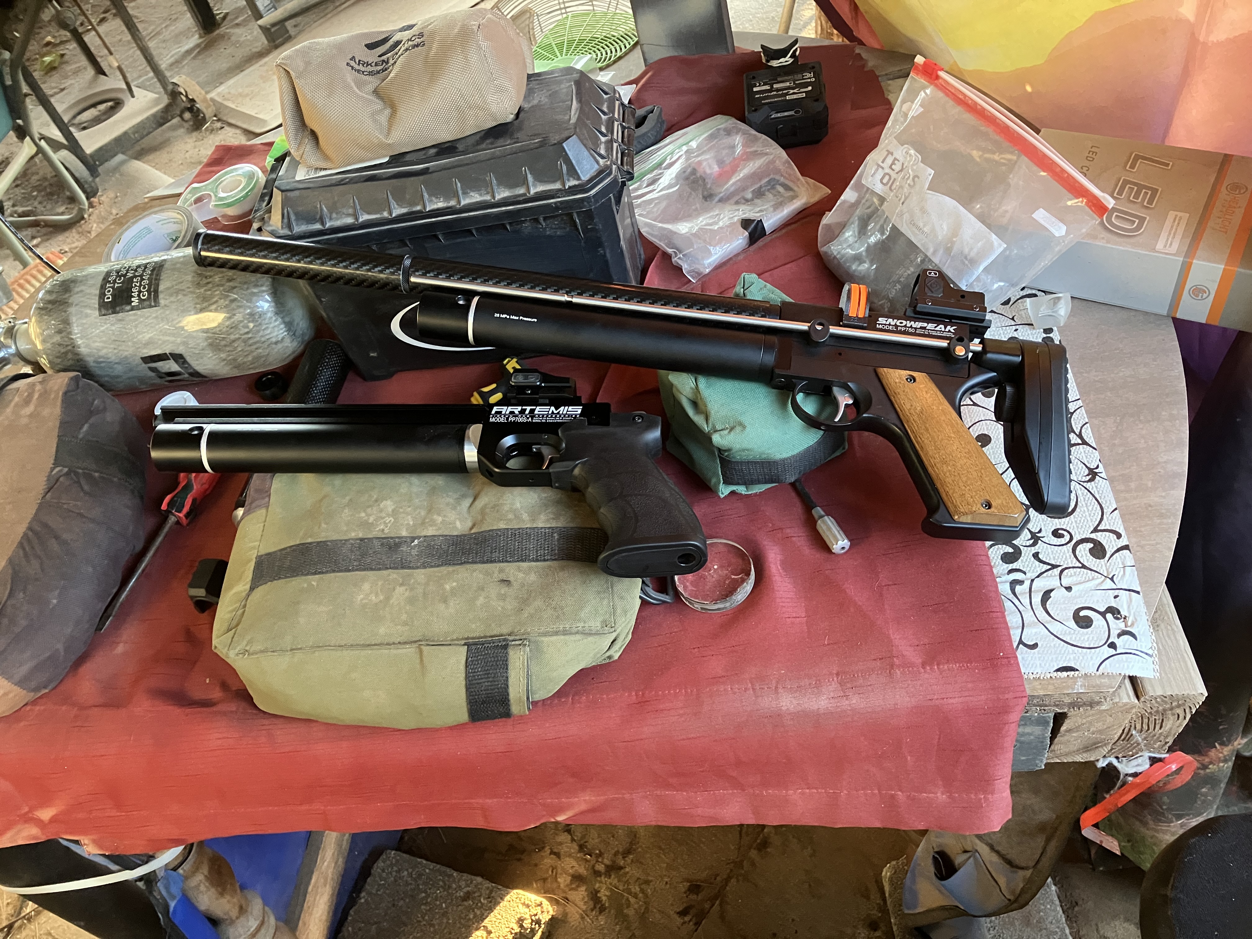

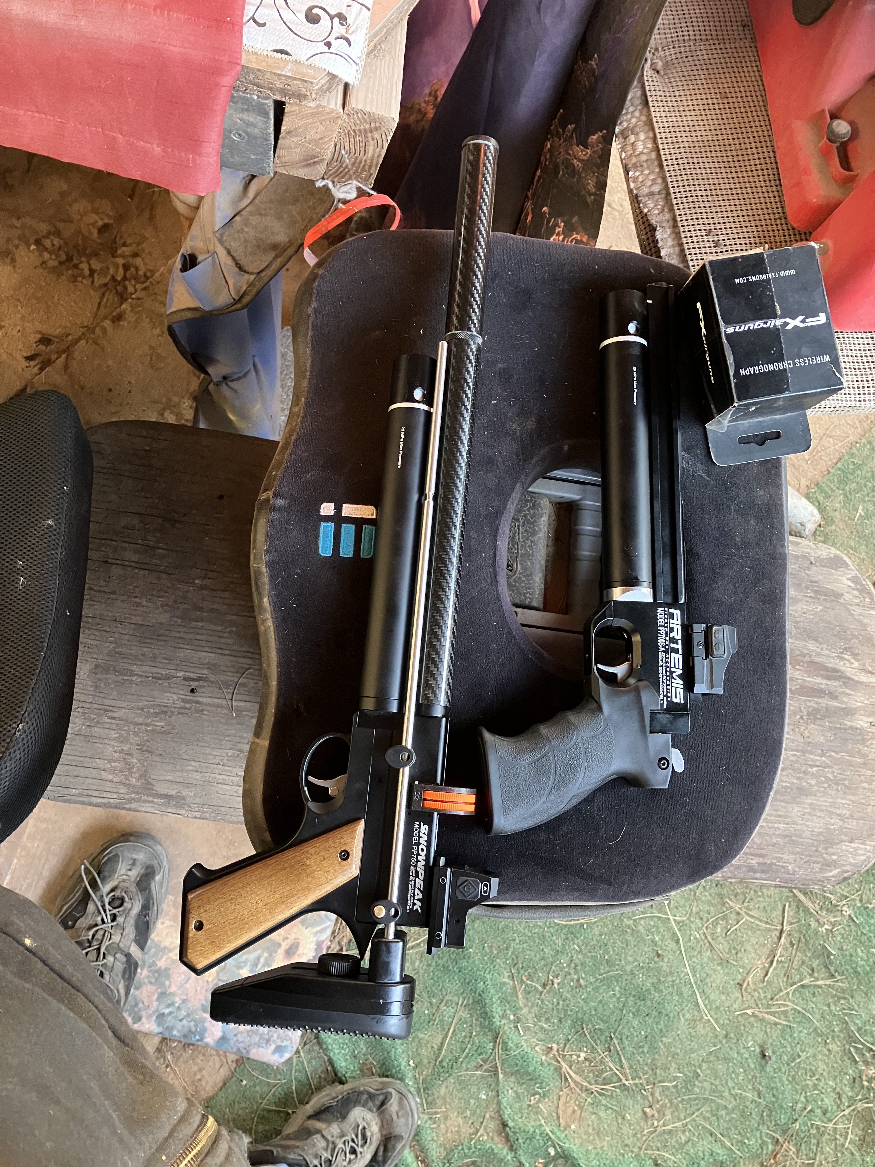

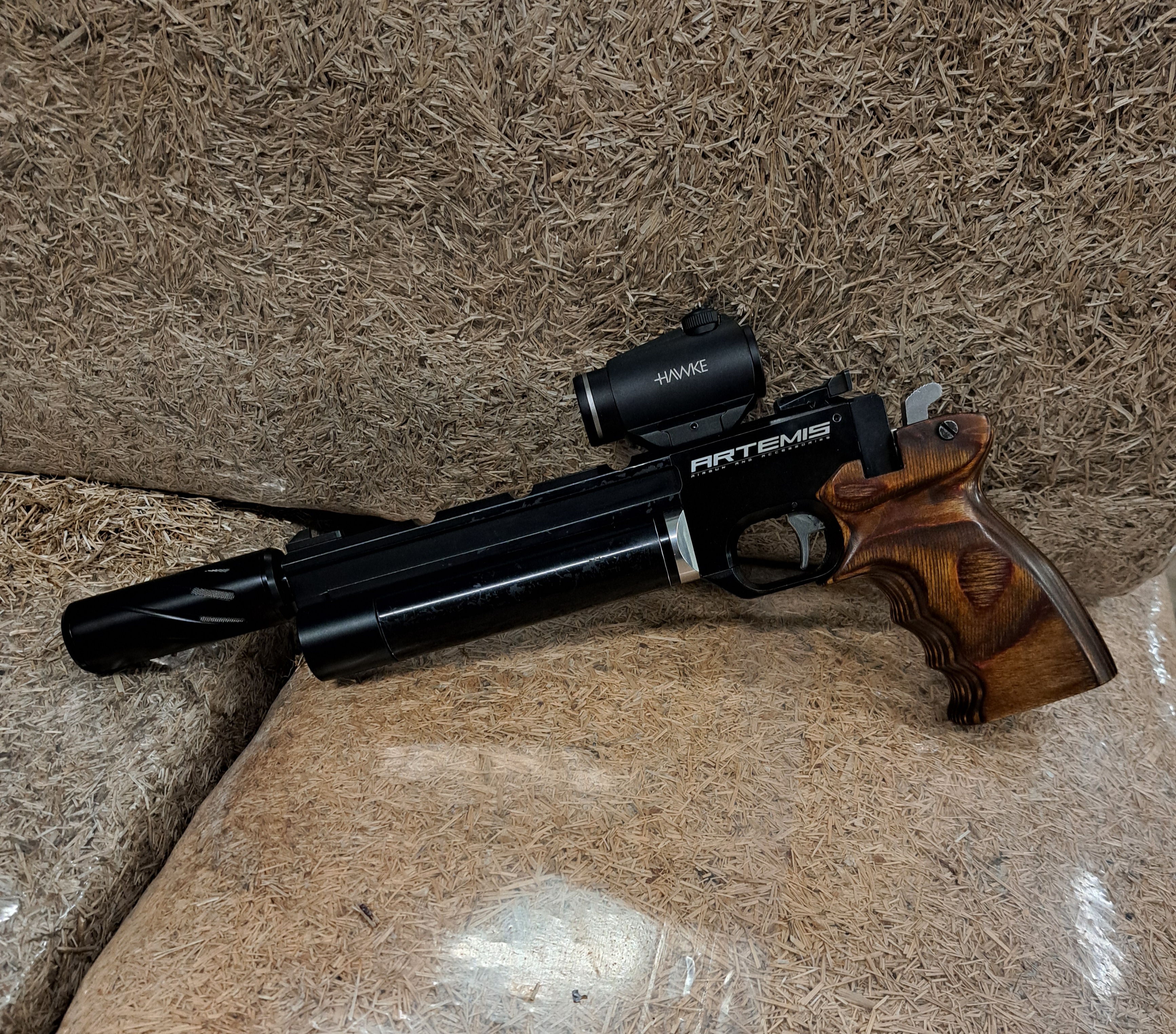

I am still impressed with both PP700 and the PP750, I have set my two Hubens GKI 22 and 25 set aside for a few day to play with the PP guns, Got to put a muffler on that PP 700, Didn't see a Donny FL adapter for the 700? , I got a bunch of LDC on my PCP rifles but just don't look right on a pistol, I killed a few cans and targets today out to 30 yards , My eyes will not take me out any further with the red dots, I am not putting a scope on a pistol, They look way cool but -but just not me, Scopes go on rifles , But 40 years ago I would not put a scope on a rifle , Times change,,, And NO I will not drive a automatic truck, got to be Standard

Mike OOPS I remember why I was posting, PP700 barrel,,, Took me well over an hour to clean, Never seen a barrel the dirty,

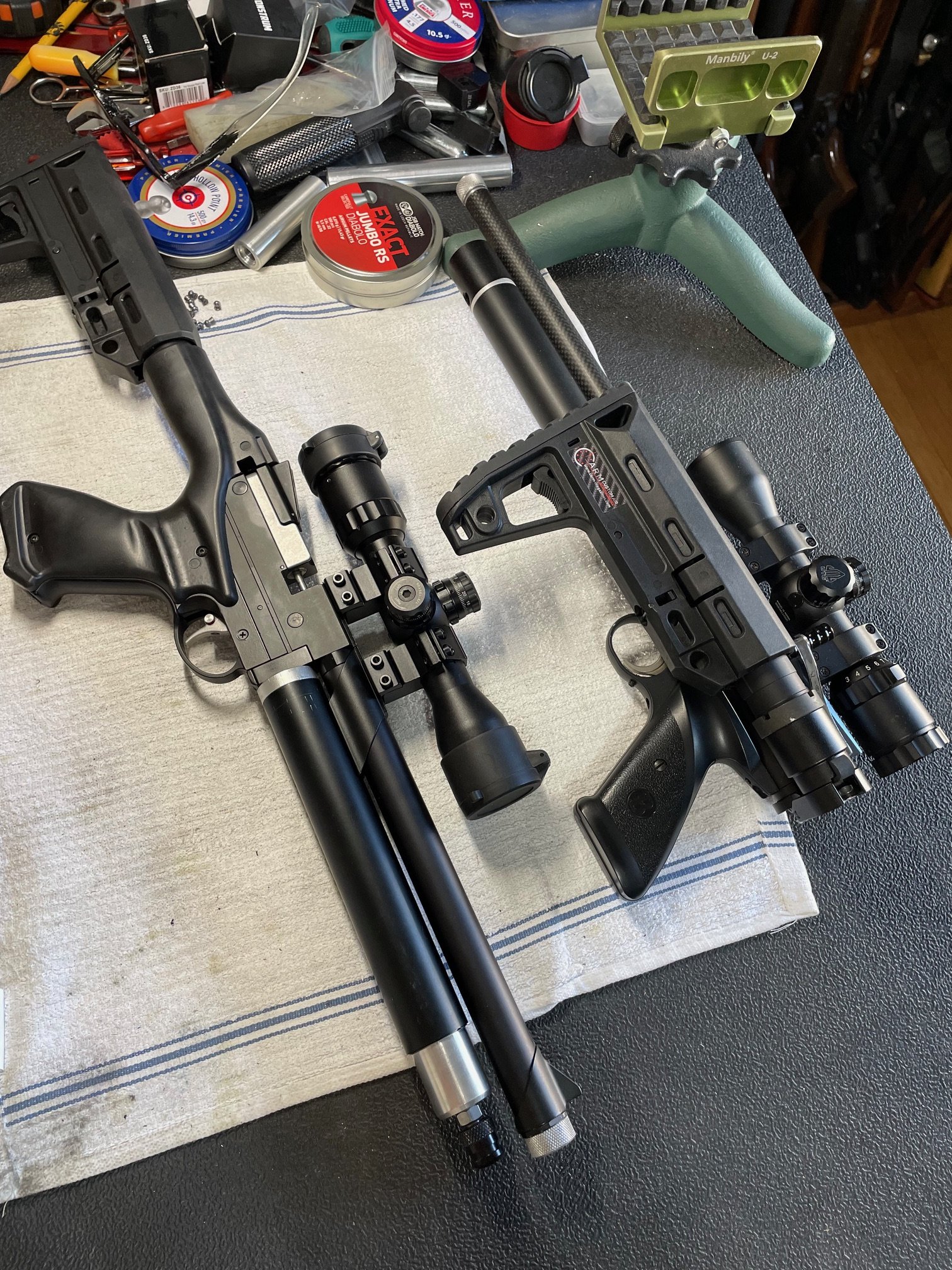

I have a few Lothar barrel left from 10 pcs. I bought from Tim (Mac1Airguns) for converting the crosman mk1 to an LD conf. The pp700 5.5cal is prone to stretching on the treaded end and lose accuracy.

Like I said, the pp700 5.5 barrel is very thin on the threaded ends. On the back end I use 2 M4 set screw and I make an over size M10 nut to tension the barrel and also have a 1/2 unf male thread for moderator. Changing breech O-ring is now very easy, just loosen the set screw to slide the barrel forward. The breech block I bored straight through.

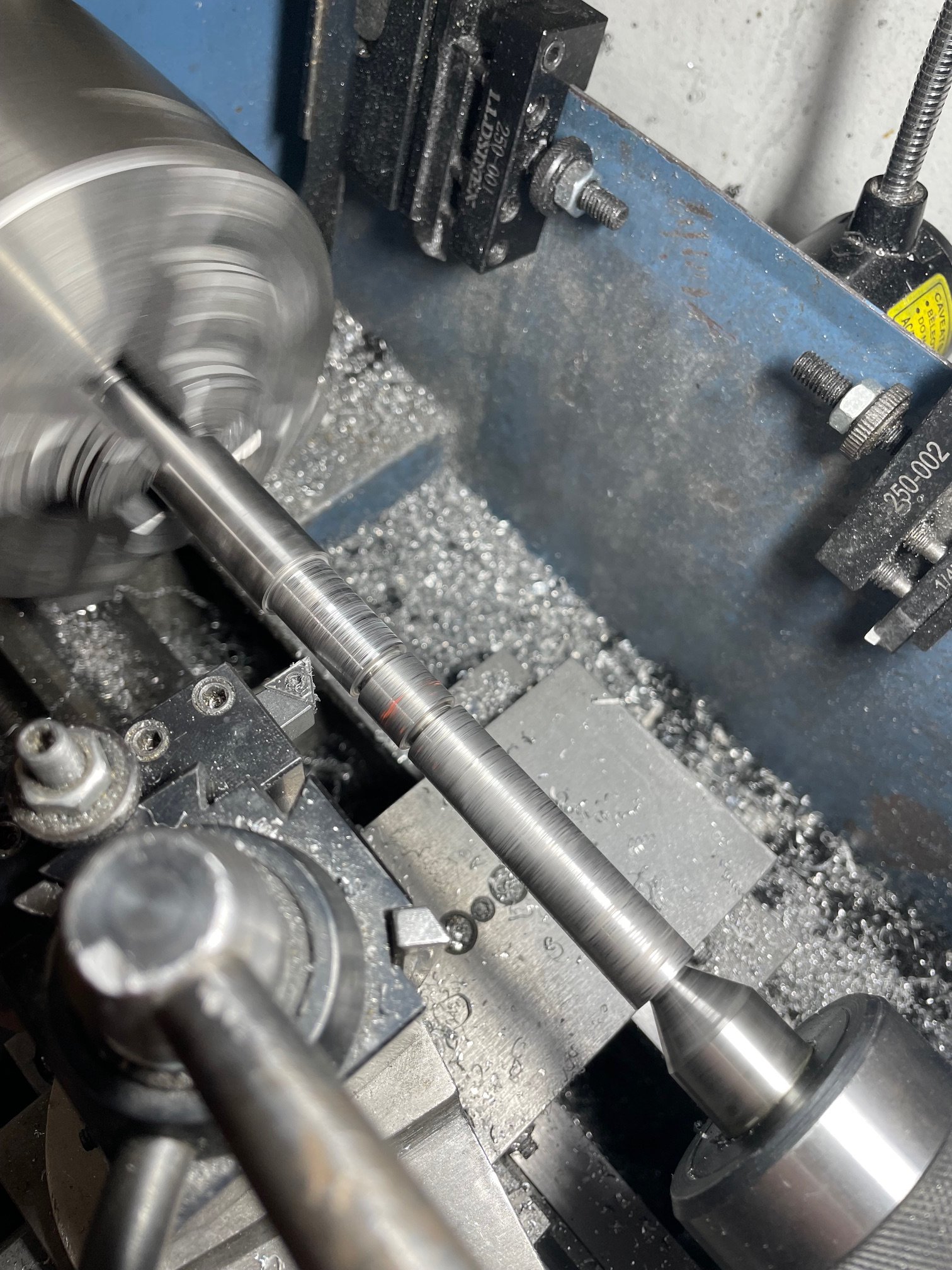

For one of my pp750, I used an Avenger X 5.5 barrel I bought from PA. Yes it's a lot of work to cut to 10.75", tread and hone a lead for the pellet but it turned out very well for me. I lapped the groove with XXX fine diamond lapping compound. I also relocated the 2nd stage screw to reduce full by 30%.

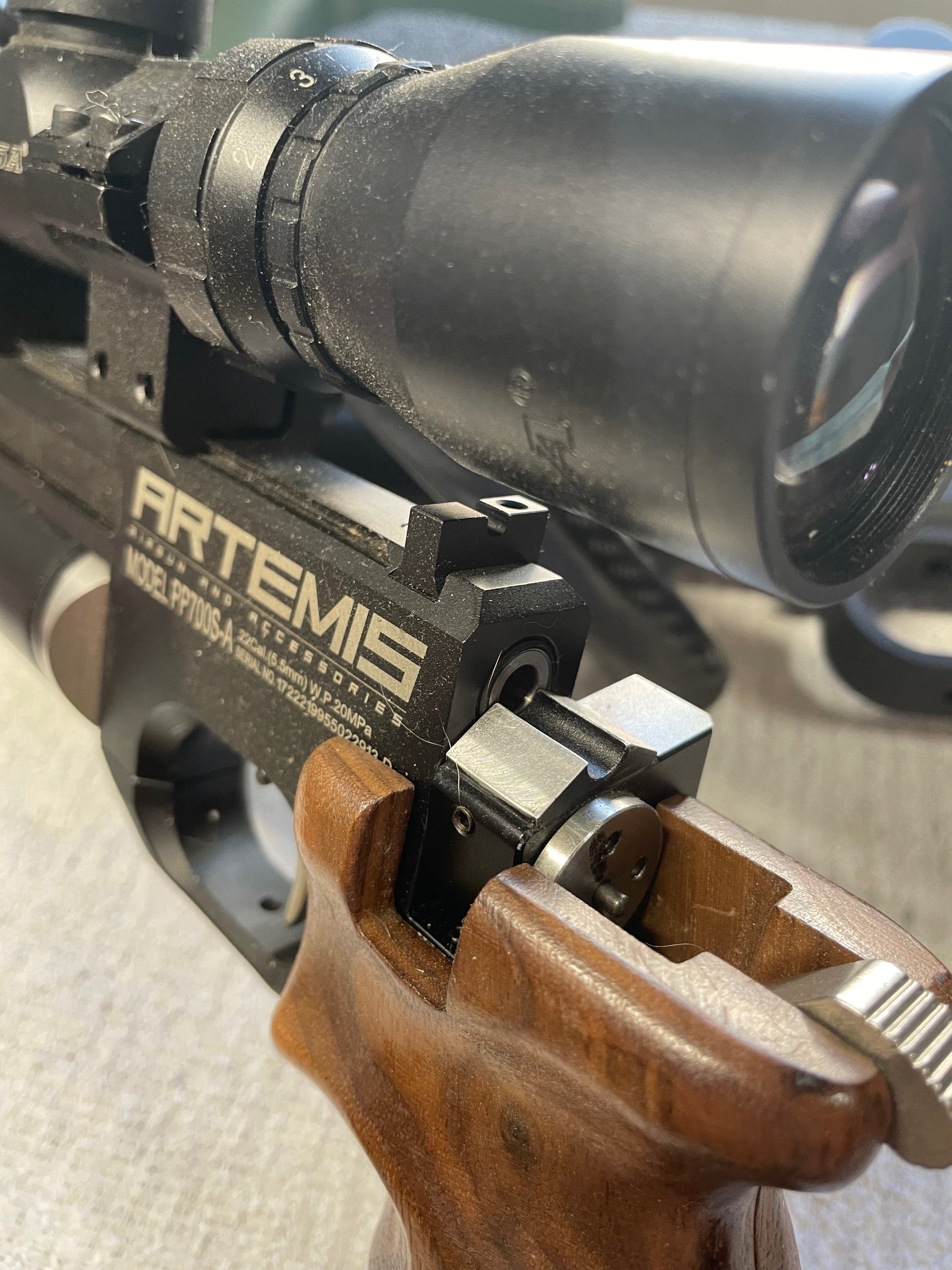

Another advantage the PP700SA has is the milled rails on the side of the shroud. I took an inexpensive laser sight and modified it to match the rail with a 60 degree cutter in my milling machine. This allowed the laser to be offset 1/2" left of barrel center. This is very useful for close range pesting.as it eliminates hold over sighting with the reflex site.
