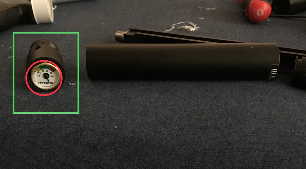

PP700SA Air tube End cap with a gauge valve
Valve broke while tightening. Does anyone know who has spare air tube parts?
Need the valve and End cap

mine did the same thing. well mine snapped off inside! i found one where i bought one & the guy wants $80 us for it. says i had no warranty on my pistol. happened same day after 8 shots.. and yes it needed tighten air was blowing out. all i got was 8 shots!!
Agreed, the Teflon tape (shown in photo above)...has no place...in any airgun.
Mike
Mike, you are almost right. Most fittings are BSPP, which seal with a gasket on either end of the thread. However, in some cases tapered threads are used in airguns, either BSPT or NPT. In those cases the tapered threads are sealed on the threads. In which case teflon tape or special sealing compounds are used there. Care must be taken.
