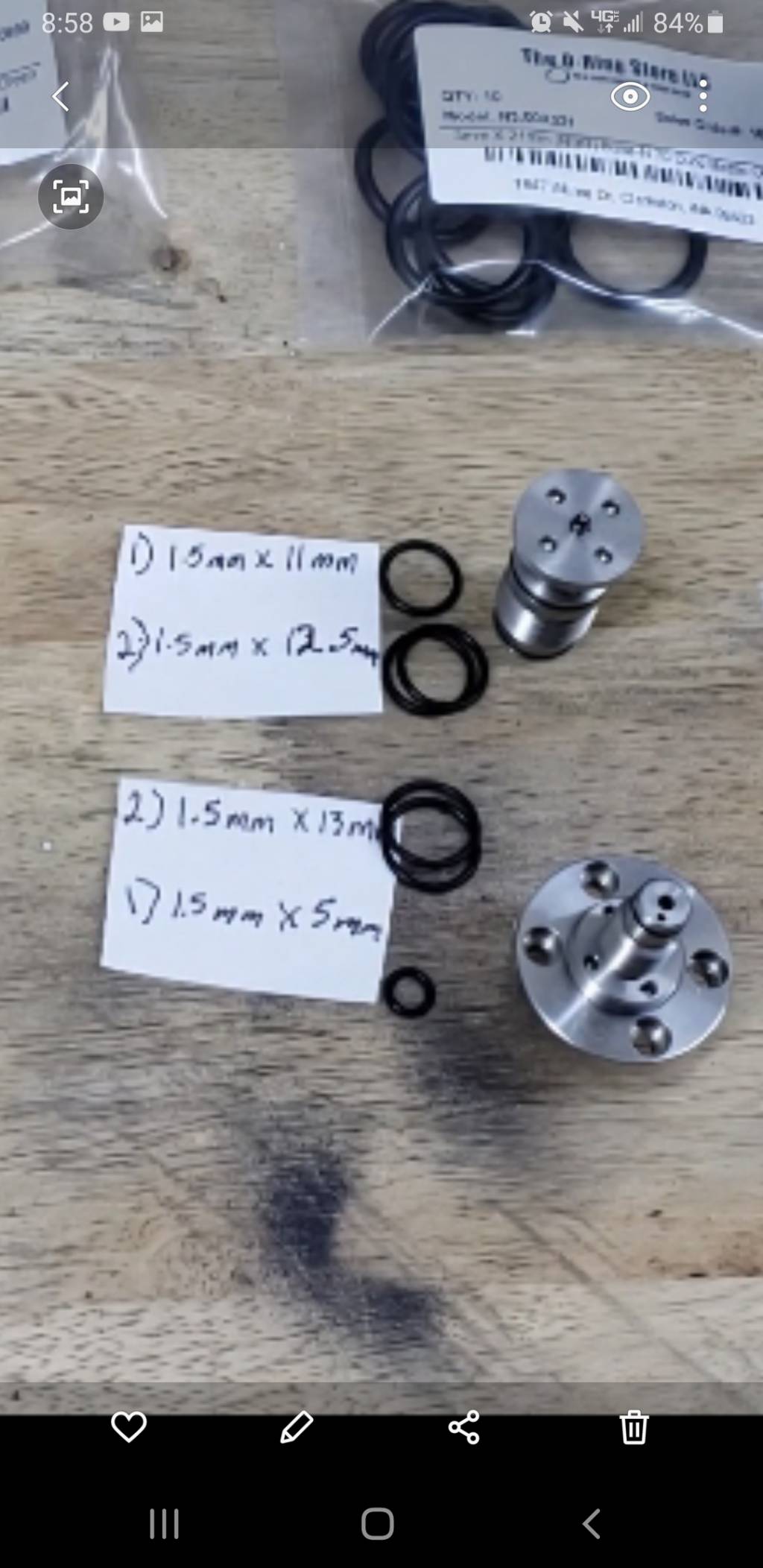

I have a guide to the various o-rings and where they go in the gun, but I see your list has two that aren't on mine.
The "1.5x13mm" ....are those the pair of brownish o-rings on the rear of the valve body? ( As seen @ 19:31 of your video ?)
And also the first one on your list "AS568-012 B70".......... where does that o-ring go ? ( I do have the schematic picture of the parts-list, if that helps you to answer.)

When I get home I will look and see what orings those ones are. The ones I ordered are from the list over on the 700sa owners manual thread. If you need I can pm the link to you or if you have been on it pg 100 is the best page with links to each section of the thread. I have read that whole thread 3 or 4 times and has some great info on it but I'm more a visual learner so decided mabey the video would help others and am glad that it is helping others.
I have been going out hunting a bit with it this winter but was planning on taking it apart again and showing some of the mods I have done and how I did them. When I do that video I will include where each oring goes also and should of done so in the first video but didn't even think of it.
I just got home, the 1.5mm x 13 are for the valve and the 1.5mm x 12.5 are for the regulator housing i might have them backwards but think that's the right order. The as568-012 are an oversize breach o ring they are crazy tight though, if you have blow out problems around the breach that is a size that might help. I figured that aligning the valve and sanding it worked good and the oring fits better. I hope this help a little.
The valve and regulator sizes
The valve take 1- 1.5mm x 11mm and take 2- 1.5mm x 12.5mm
The regulator takes 1- 1.5mm x 5mm and 2- 1.5mm x 13mm
