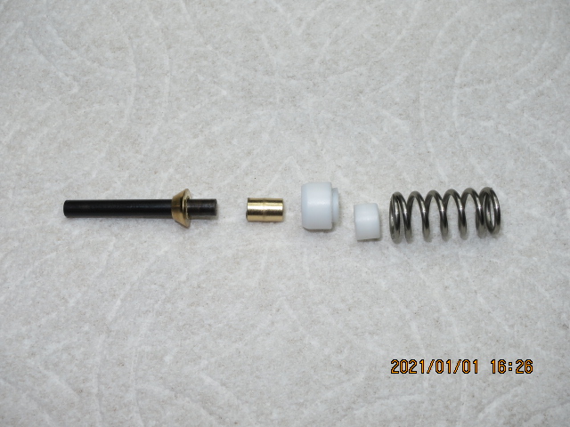

Is there a source for parts for a PP750, specifically the poppet stem assembly? Is there any one making these that are an improvement over the junk OEM poppet stem?
Was just about to finish a tin of pellets, plus some other tester pellets, so about 500 rounds before this poppet failed.

My factory gun was giving just under 12 ft/lbs with JSB Jumbo 15.89s. I gave a single turn CCW on the regulator and 1 turn CW on the hammer spring and was getting about 16 ft/lbs, but was getting chronos that acted like was an unreg'd gun, diminishing fps. Backing the HS that single turn and was getting velocities around 675 consistently. When the chrono read 296 fps, yeah something was up. The next pellet was stuck in the breach, the poppet having failed. He he he...

The 750 poppet comes apart like your photo shows. Look at the expanded parts diagram. What actually broke. I'm not sure I see a broken part.
The brass cone on the stem broke away from the brass sleeve section, and when fired drove the stem through the nylon part which is separated in two. Looking at the exploded view parts 69 and 70 are now four individual pieces.
