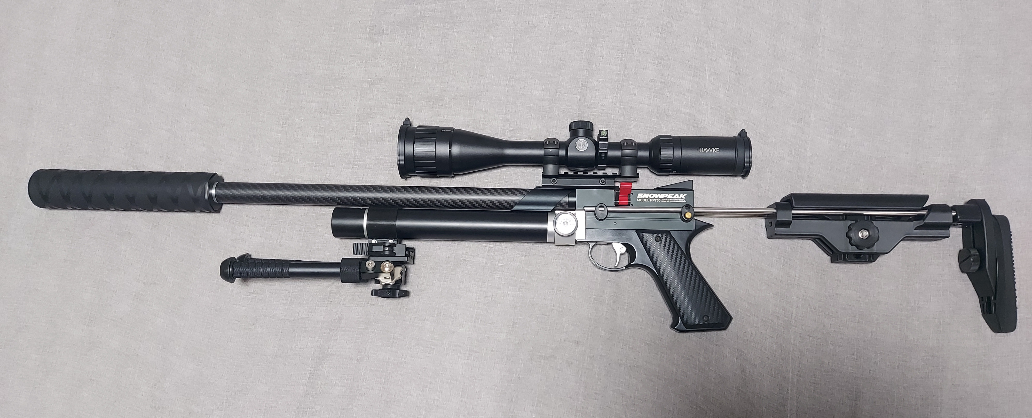

PP750 is still a fun pistol carabine in 2023. Notos is a variation. Here is mine 750 with 16 inch FX superior liner and some other custom bits. Very easy to make it your own. Im from Europe, too. Some things are not so easy to get a hold of, but where there's a will...

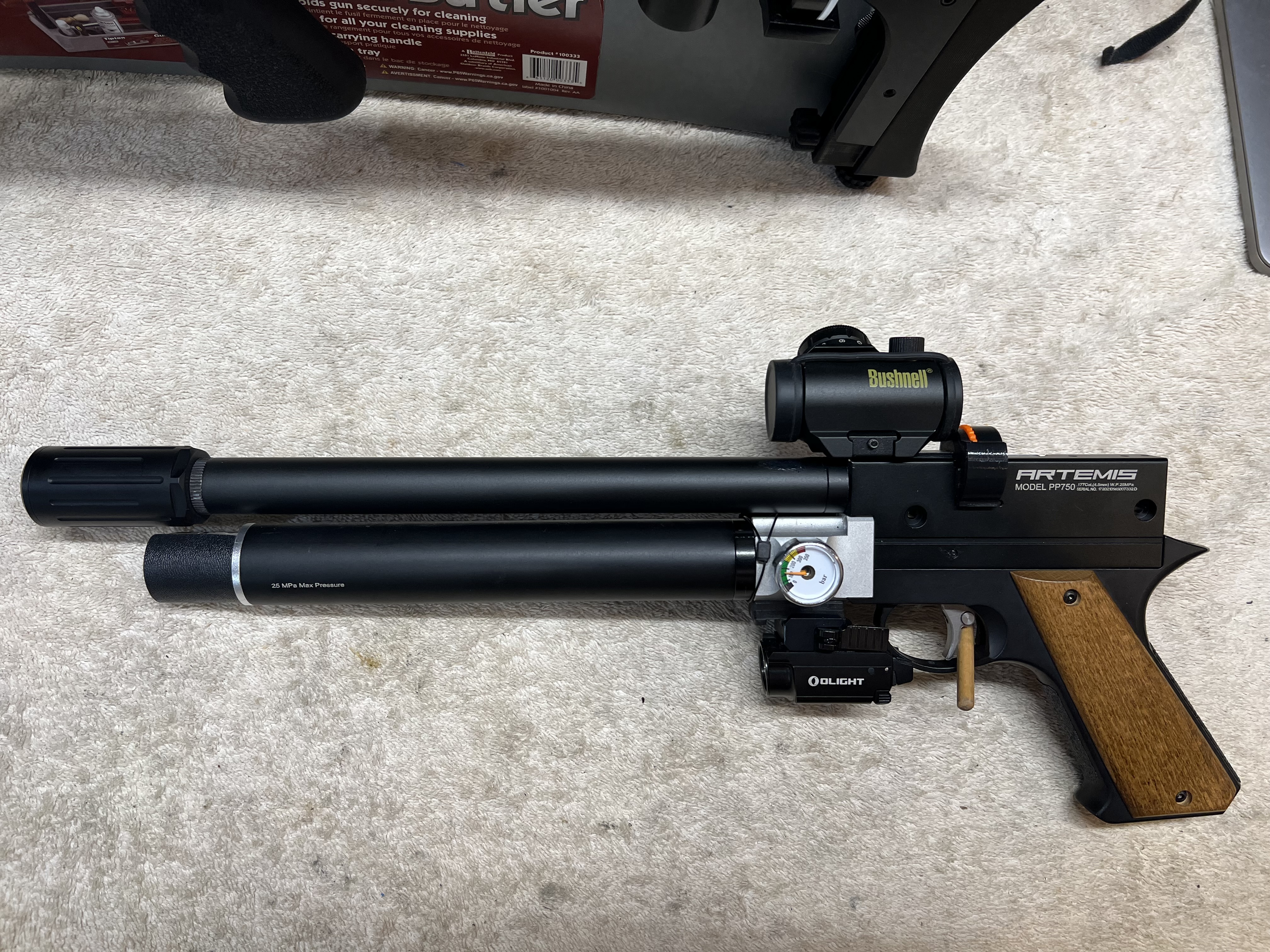

This is mine in pistol form. JSB 18.1 grain at 600 FPS gets me about 40 shots. It’s a decent pistol. If you like to tinker and tune, you’ll spend a lot of time tweaking it to suit your needs. The trigger is not great, and there’s only so much you can do to make it better, but I can live with it. It’s pretty accurate and quiet. Capable of dime sized groups at 20 yards from a bench with a scope. I use it for standing pistol target practice at about 10 to 15 yards.

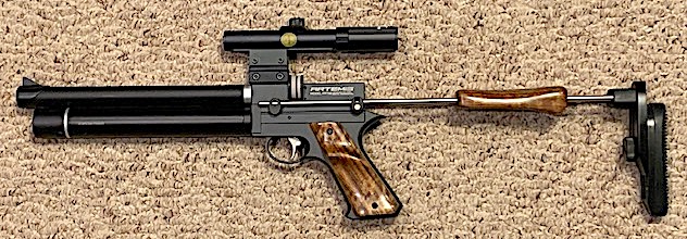

I loved my PP so much from the get-go that I made custom Shedua grips and cheek-piece for it and came up with a really cool little vintage rifle scope to top it off. The only bug was the trigger action; though crisp and light enough, it broke at various let-off weights. So I put Gorgeous away for about a year before correcting the trigger weight inconsistency (easily enough). She's a real gem, in mini-carbine or pistol form!
15.9 gr JSB, 250 BAR charge, 22 shot powerband- Low= 626, Hi= 635, ES= 9, SD= 2, Average= 631 FPS/14.0 Foot pounds
4/6/2020- Five consecutive 5-shot groups at 35 yards with 15.9 grain JSBs averaged .70” c-t-c.
4/24/2020- Six consecutive 5-shot groups at 35 yards with 15.9 grain JSBs averaged .73” c-t-c.

Can we assume the silver addition is a plenum-chamber, and/or (upgraded) regulator?

I like how you kept it simple and light. That’s some nice wood on there. I was looking for a tiny scope like that to mount. It’s a fun little platform. Perfect for small backyard. I may need to get me a Notos so I don’t have to keep reconfiguring it between pistol and carbine.

I was a designer for that "silver chamber" ;) and a friend of my machine shop fabricated the parts for Wes.
It is an extended plenum with option you can mount a gauge on the Reg side, I designed several versions and we finally fabricated four versions of these.
The PP750 is a "pistol" by definition in Canada and the extra power from this plenum putt it into a RPAL restricted category, this why I decided the sale was available in US only.
With my plenum the pistol was capable of shooting 15gn @ 850 with a unrestricted port and some replaced springs.
Thanks bigHUN! Now I remember seeing your thread with the CAD drawings of this plenum. It’s an ingenious design. I haven’t even began to test the max power as I need a heavier hammer spring and longer barrel, but with your plenum the potential is there. Getting back to Tangodown’s question, the PP750 (and Notos) is one of the best cheap PCP pistols you can buy. One that’s sure to be a favorite among tuners with an ever growing aftermarket parts availability. Like BigHUN has shown, these parts are made for tuners, by tuners. So you have to search for parts on EBay or places like AirgunArcheryFun.

As I thought, the extra chamber volume achieved with that plenum attachment accounts for Deadland's excellent forty-shot power band at about the same power-level with 18.1s as my PP shooting 15.9s (without the plenum gizmo), but returning only a 22 shot power band. I suspect you might get as many or more shots than I do at your souped-up power level, HUN. Thanks for the pertinent info lending better insights, Bud.(y)
